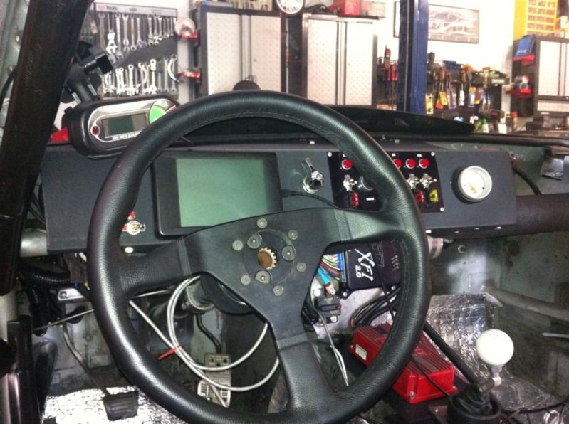

So yesterday I managed to fix the oil line issues I was having, re-routed a new line through the firewall to the accusump, and removed the passenger side seat and harness for good. Also got the dash in the car with all connections connected. This morning I'm going to troubleshoot all circuits one at a time to make sure we have power to everything. Once that is done I'll go ahead and start programming the touch screen and making a love connection between it and the XFI.
Hope to have this car "running" by the end of the weekend. After that I need to do the mustache bar bushings and the exhaust header sorting... I don't anticipate making the VIR event at the end of the month at this point. Going to have to find another local Summit Point day for another shakedown run.
Mike
Well so far this morning is turning out "pretty well"...
She started up on the first hit of the starter button and everything seems to be working, except I have two lights on the switchpanel that are energized even when the toggles are off... So there's a ground issue in that panel I need to check. I also need to program all the sensors and make a love connection between the XFI and the dash so the dash reads all the same data the XFI is reading.
Getting there... Atleast now I can move the thing under its own power again!

"Most" of the connectivity issues with the XFI and the Dash are worked out. Need to sort out the datalogging arming as well as the analog gage settings for the oil temp and oil pressure. Also have an issue with the accusump not refilling... Also still have header gasket issues... Burned through the passenger site will revving the motor to 6500 rpms. Pretty sure I did NOT hurt the motor back when I was at Summit Point. Motor is running way to strong.
Mike
I'm so stoked... Got the dash working this evening. I have proper monitoring for RPM, oil pressure, coolant temp, and I need to work out the oil temps and the data logging.

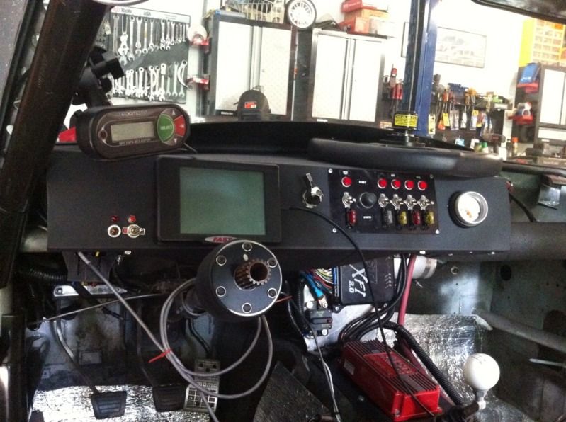

Pulled the dash back out to wire data-logger switches, and install my one-touch video camera button/light combo, and to rewire the oil temp sensor to the 1000 ohm channel on the logger. Still having issues getting that to work with the Autometer sender, but I'm sure it'll come together... I need to setup the accusump air pressure, and then I need to resolve the header issue. Then... I'm Done?
Until I install the fire system and coolsuit box. I'm going to take a few days off though. The wife has been complaining about "you being in that garage every evening and on weekends!" :rolleyes:
Mike
well I lied... Pepboys called while I was out with the wife for a sunday drive, and after I got back home, I took off to pick up a wire connector. I now have a very functional working oil temp readout on the display. For some reason the FAST D200 dash doesn't like the autometer sender gauge, so I swapped to the GM oem coolant temp sensor I had laying around. Works great!

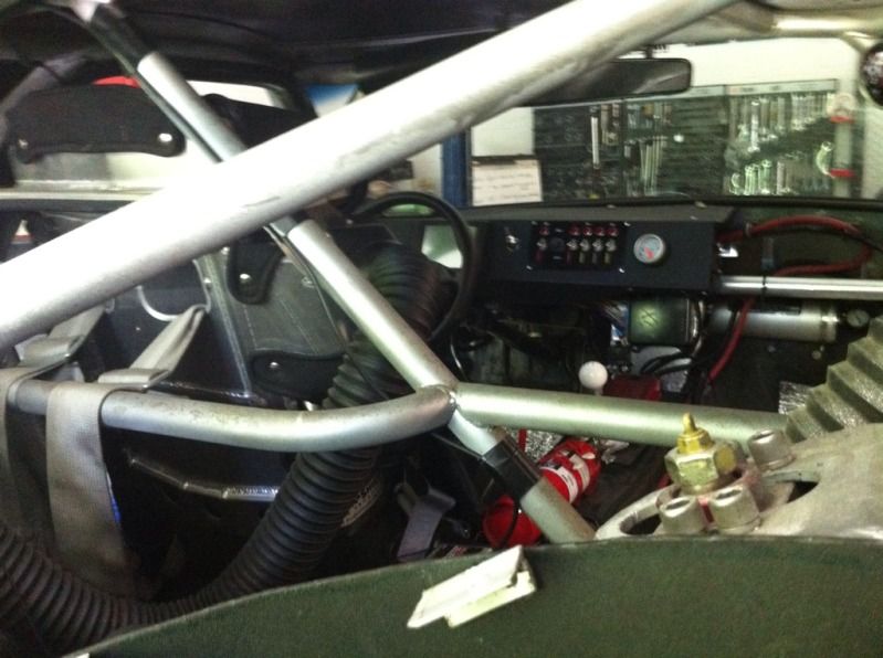

I needed to do something with the space where the passenger seat was, so I got some diamond plate aluminum and covered up the space.
You'll notice that I also went back to the Braille Battery after the wiring overhaul. I hope that with the circuits down to 7 total, and the alternator up to 140AMPS worth of keeping up, that it'll do the job more effectively. I'll take both batteries to the track with me just to be on the safe side. I also am thinking of moving the battery to the front passenger footwell to place the weight better. I'm rear biased right now.
And I also mounted the Traqmate back on the suction mount so I can get a better angle from the driver's seat...
The wires hanging around the steering column are for connection to the ecu and will be properly stowed when not in use. It's all coming coming together. I may pull the headers and exhaust this weekend and "fix" my collector leak problem with a permanent solution.
