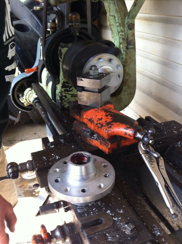

You know, I saw that listed on racerpartswholesale's website... Oh well. Parts shipped yesterday and I expect to have everything in house and ready to complete later next week. I am running by front hubs over to Tom Harris' place today and getting them machined down on the OD so they will fit the CCWs in front without having to use spacers. Need the OD to be less than 2 5/8th of an inch. Getting her closer to "debugged".

Big Big thanks to Tom Harris for machining my front aluminum hubs to essentially make the wheels "hub-centric". No more need for front wheel spacers and now I can dial back in the caster I pulled out when we installed the CCWs and had hub diameter interference issues... No more!! Everything is bolted back up and fits like a glove!! The 275s up front actually look like they're perfect tucked under the fender flare with plenty of room for compression of the suspension without issues.

Couple pics of the work Tom did...
Moving that wheel inboard 1/2 inch really made a difference. But this is a lesson on custom parts fitment... The guys at CCW took specs from another Zcar customer and never once did I think "Hub diameter, and never once did they mention it.. Even though I'd said "5 lug conversion" and they'd said "we have another customer with that pattern"... So it was just an oversight on all parties...
before:
After:
Right now I'm waiting on the Fuelsafe surge box to come in. When it arrives, I'll have the parts needed to address that issue, and then I'll just need to re-do an alignment on the car and loc-tite the header bolts. Summit Point main in three weeks...
