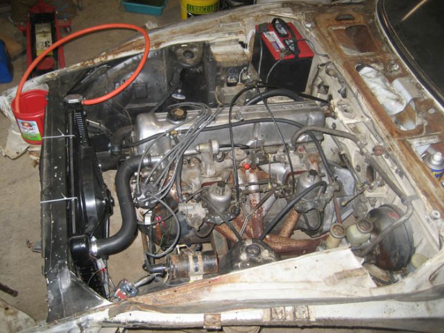

TrumpetRhapsody Posted March 20, 2008 Author Share Posted March 20, 2008 Well I didn't do too much on the car today, since I was mostly cleaning up crap off our lawn from the flood (our property is on Sallisaw Creek/River), so I didn't get around to messing with the clutch fitting leak. I'll do it tomorrow. What I did do is tune on the SU's, and it is running much better now. I'd be comfortable driving it around streets once I get all the old gas worked out of the system. I also put it in gear and let the clutch out, and it moved! Based on that I'm guessing I have the right throw out bearing, w00t! Also, the temp gauge moved for the first time today. I sure do hope it's accurate. It was reading maybe 3/8" above 120* (far left/low). It also squirted some steaming fluid out the overflow after running awhile, not surprising since I topped it off while I had the right side jacked up working on the clutch slave line. I need to route up an overflow bottle for it at some point. Now for the bad. I pretty much have close to 0 oil pressure at idle, though it is circulating through the head (saw it squirting looking through the filler cap). I dunno what to think about that. I'll put new (not reused as is now) oil in and see if it helps, but I doubt it. Quote Link to comment Share on other sites More sharing options...
TrumpetRhapsody Posted March 21, 2008 Author Share Posted March 21, 2008 Alright well I got my Zirgo electric radiator fan and thermo installed, and it seems to work well. I'm pretty sure I'm going to need a bigger alternator now... the motor doesn't like it when the fan kicks on. Yay. The coolant temp gauge is working now... for some reason. I'm still trying to figure out the whole low/no oil pressure thing. I get some light steamage coming out the head and block vents when the engine gets up to temp. It's weird, and makes me nervous. Quote Link to comment Share on other sites More sharing options...

TrumpetRhapsody Posted March 21, 2008 Author Share Posted March 21, 2008 Thanks! I'm pretty sure I'm running a 240z alternator. I wired the fan directly to the battery positive, and it seems to like that much better. I don't notice any change in idle when it kicks on, and the amp meter reads slightly above normal. Thanks for the offer, but I think I'll leave it be till I can do the internally regulated GM alternator swap. Well things are looking up. I'm getting the SU's tuned a little better each time I play with them, and I changed the oil. I read somewhere to pour some B12 chemtool in the valve cover oil fill and run the engine till warm for awhile right before changing the oil to smooth things over and clean things out. So I did that, and put in some new Castrol 20w-50 (awesome sale right now!). The oil pressure seems a little better, probably 10psi (1/8in on the gauge) at idle. I think I overfilled it a little though, so hopefully there isn't a close tolerance between the H on the dipstick and the crank. I didn't notice any smoke puffing out the vents this time, but I didn't run it as long. We'll see. Hopefully my throttle linkage will get here tomorrow so I can try driving it around! Quote Link to comment Share on other sites More sharing options...
