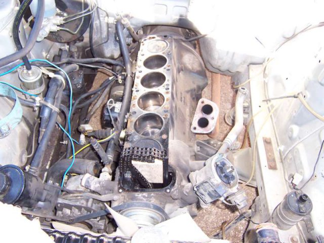

On the other hand I did get my motor built up today! Arrived at 9:30AM left at 12:30AM and I wish I could have stayed longer but Mom worries about me, especially the area, not very safe at night. I could stay there all day though. I love putting it together and making it work but I get carried away with time, and then I don't sleep, and then after a while I just don't wake up for 24 hours. Then I'm back on pace. >_> It's happened with school before, lots of yelling from Mom that day...
The only things that are really left is to pickup the radiator, starter, headers and install the oil pan, oil pump, distributer, and valve cover, and all that crap that bolts to the block like motor mounts, alternator, etc.
Don't worry I didn't paint 2 things red and leave it lame looking... Oil pan is red, mounts, all that "crap" that bolts to the motor like I said before is cherry red.
However.... I don't feel that we timed it correctly. We put piston 1 at TDC, and made sure the valves were shut on that cylinder. We put the shiny chain link on the mark for the crank and the other on the #1 for the cam sprocket BUT I thought there was more too it... I started thinking and I feel that we should have looked at the lobe separation. From the tip of intake, to the tip of exhaust, so they are making a V shape, I feel that we should have taken that degree, lets just say its 270º for compression (the underside of the V when you look at the lobes), then divide 270º in half so which is 135º. So from either the exhaust or the intake, you rotate the cam 135º and this is now the middle of TDC compression/ignition. Otherwise you're intake may stay open too long/too short relative to the stroke. The piston may start raising up in the cylinder when the valve is still open for the intake charge blah blah blah. I started doing this with the feeler gauge but Dad said no you don't need to do that, as long as the valves are closed you are fine and for the purpose of this example only, the valves are closed 270º. So according to him, anywhere within that 270º the cam can be set.
Now I may just be going mental or something but I do know I left out the fact that the pin in the cam must but lined up so the #1 gear tooth can match up with the shiny link. Basically, our shiny link was at the 2 o'clock position and the pin was at the 12:30-ish position, so if some how my idea made it so that the cam pin was now in some other spot, it wouldn't work unless if it either A: matched up with the other 2 holes which are given or B: you had an adjustable cam sprocket, which I don't. I'm still kinda confusing myself with this idea and I don't think I will fully understand until I go back and actually get my hands on it. I'm not good at drawing pictures.
The rods with pistons. Like Dragonfly said, you can't really feel the the difference between shot peened and not, you can see it though.
Thats about it for today. I won't go to the shop on Sunday, and I'll be gone until July 4th, THEN maybe I'll get all the goodies in the car and I will definitely have a video of the start up and stuff. Otherwise the day went well. No problems, Dads cookout went well. Lots of nice club members, some new, most long time members so they have seen Willie and I go from little to big over our years. They went to the dyno and can anybody guess what the highest power was for the day?! 101hp! I heard they had some wheel spin though with their thin tires so maybe a little more. I still wouldn't go crazy though... the 101hp guy had the works on his motor. >_> At least its a cool car.
