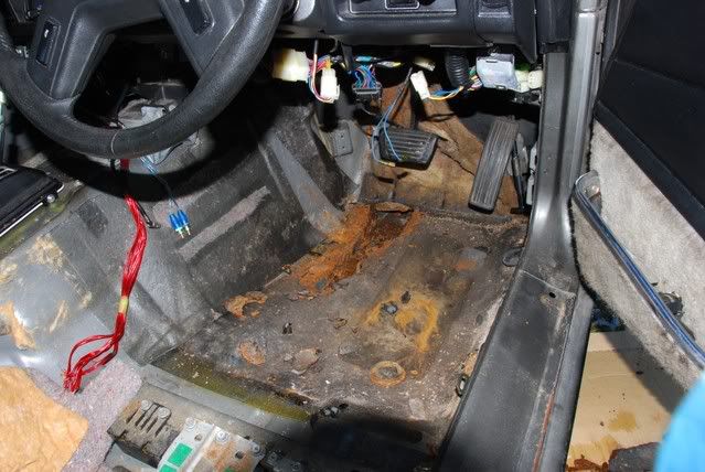

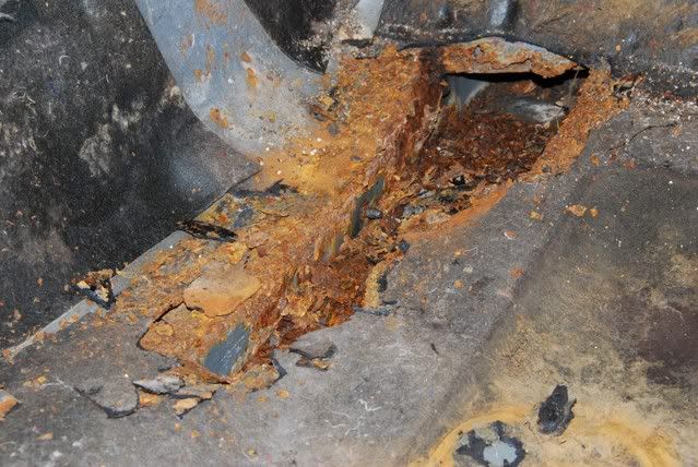

naviathan Posted May 29, 2008 Share Posted May 29, 2008 After my new fairlady got rained on for the first time I noticed a lot of water pooled up in both floorboards. Curiosity hit me and pulled up the driver side carpets to find a lovely rust hole through to the frame rail that I thought was solid: Now I know I can easily patch that bit of floorboard because the hole isn't too bad and the rest of the board is solid (I checked). I need frame rails though because the only thing that kept this rail looking solid was the undercoating on the car. I emailed Zed Findings about new rails, but have yet to hear back from them and it's been over a week. Anyone on here know who I can contact about frame rails for an 82ZX 2+2? Quote Link to comment Share on other sites More sharing options...
slownrusty Posted May 30, 2008 Share Posted May 30, 2008 I would cut and splice in the section you need from a junkyard or donor car, I did this with my old Toyota Corolla GT-S and it worked and fit perfectly. My scrap yard allows me to take power tools in which is why this was feasable in the first instance. Regards - Yasin Quote Link to comment Share on other sites More sharing options...
naviathan Posted May 30, 2008 Author Share Posted May 30, 2008 Although I know a few junkyards that would let me take anything I want in, nobody out here has Z cars. I have a parts car I could pull it from...if that section is in good shape. Have to check. Thanks for the bump Yasin. Quote Link to comment Share on other sites More sharing options...

DuoWing Posted June 3, 2008 Share Posted June 3, 2008 I think they mean RHD car?? That luckily doesn't look too bad as far as rust issues go. You could be much worse off. Quote Link to comment Share on other sites More sharing options...

naviathan Posted June 3, 2008 Author Share Posted June 3, 2008 I think they mean RHD car?? That luckily doesn't look too bad as far as rust issues go. You could be much worse off. Yeah I know he means RHD. I know the rust isn't really bad, but it is going to require new rails. Quote Link to comment Share on other sites More sharing options...

KiwiCowboy Posted June 3, 2008 Share Posted June 3, 2008 On my 280ZX, I had to replace part of the floor panels. If the rust out spot isn't very big, you can use the sheet metal from a realtor sign (Hose for Sale). It's the same thickness and locally available. Saves you time & money, unless you get caught. lol Quote Link to comment Share on other sites More sharing options...
sweetleaf Posted June 3, 2008 Share Posted June 3, 2008 Make sure to tear out all the old sound deadening. It's the only way you can make sure there isn't more hidden rust. Also makes it much easier to clean and weld. Quote Link to comment Share on other sites More sharing options...

naviathan Posted June 5, 2008 Author Share Posted June 5, 2008 Ok so much for the frame rails. Does anyone know where I can get frame rails for a 2+2. I had a miscommunication with Zed Findings, he meant he doesn't make rails for a 2+2. HELP! Quote Link to comment Share on other sites More sharing options...
