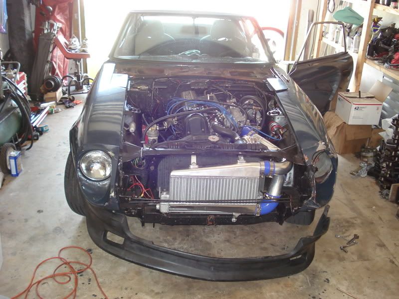

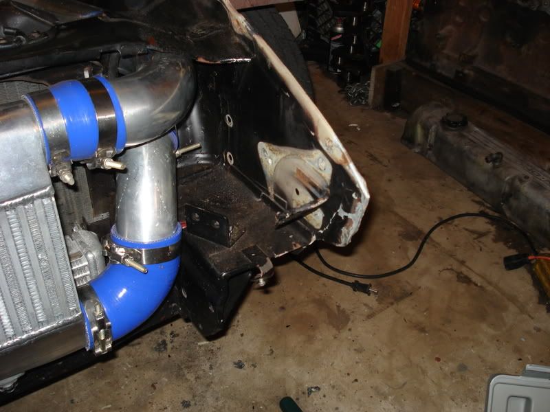

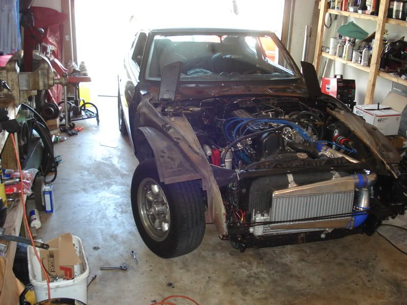

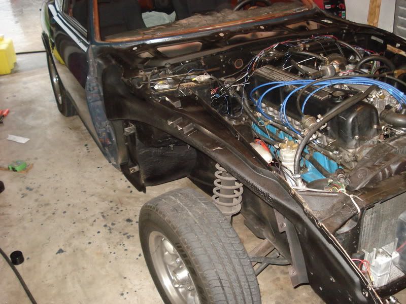

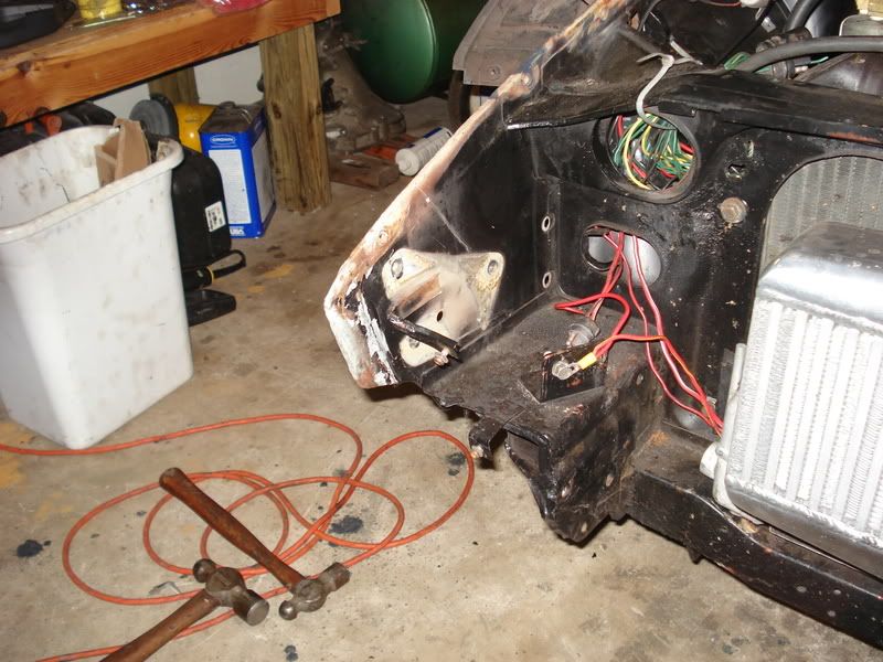

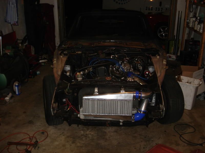

jeffer949 Posted June 26, 2008 Share Posted June 26, 2008 Alright im planning on taking tons of pictures while doing all my work and ill do my best to keep it up to date. Here is the link to my photobucket account folder with the pics in it http://s77.photobucket.com/albums/j69/jeffer949/rebuild%20and%20paint%20from%20wreck/ Well here is day one Well thats day one i fixed the bent headlight bucket things that they mount to. They where pretty banged up and had to hammer and dolly it straight. But other than that it was just a tear down day. Quote Link to comment Share on other sites More sharing options...

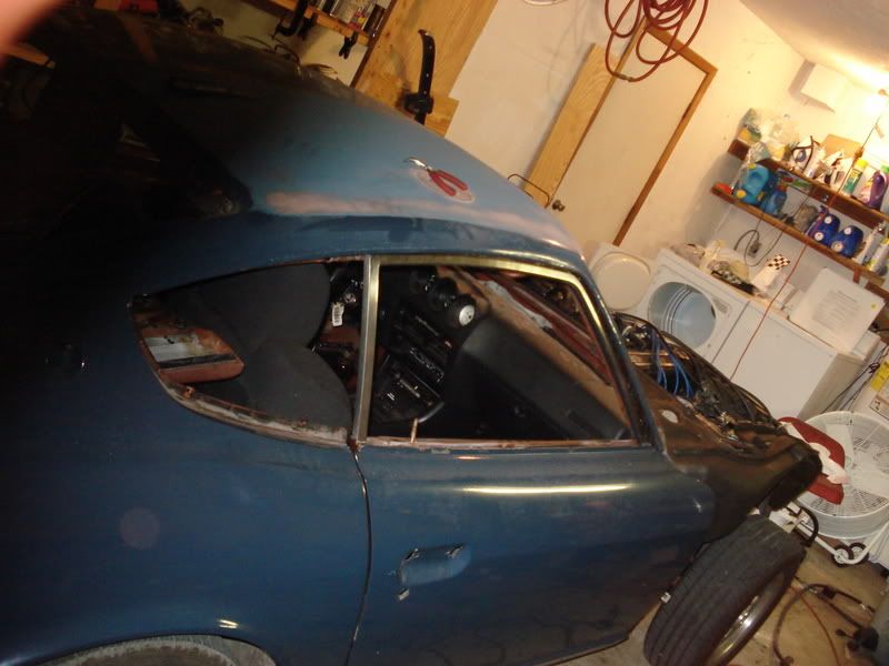

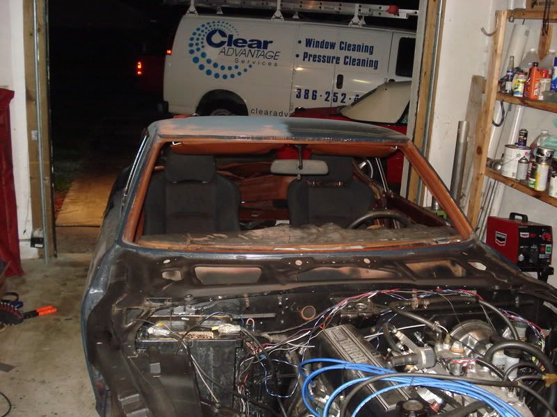

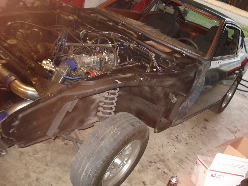

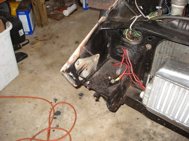

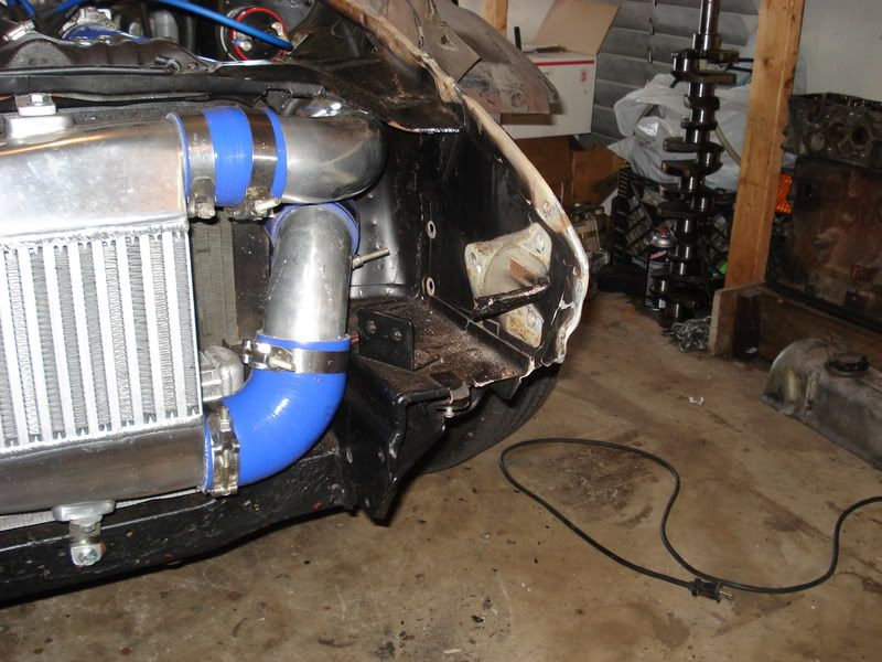

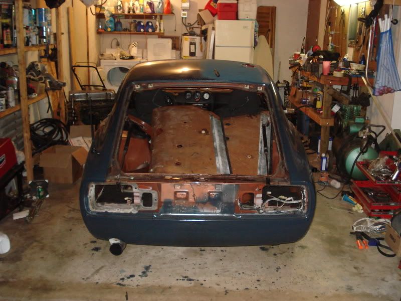

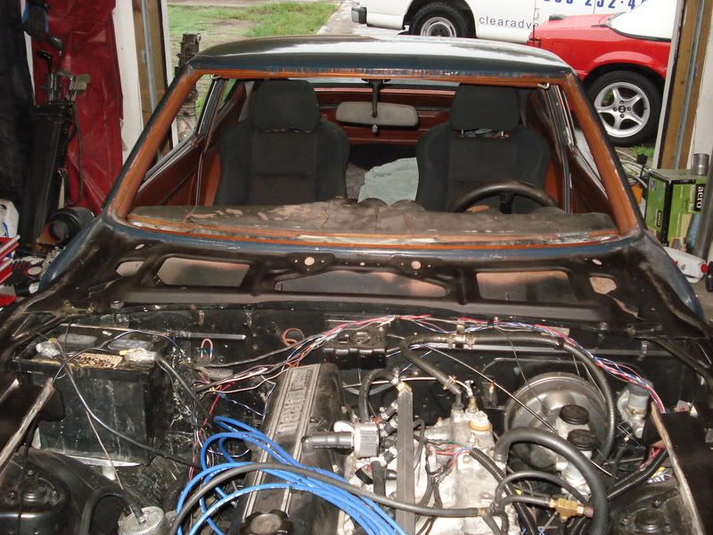

jeffer949 Posted June 27, 2008 Author Share Posted June 27, 2008 K did a little more work. Undercoated the upper frame thats under the fenders. and touched up some engine pay paint. Also took out all the glass front and rear and a side. well not the door glass. and basically got her ready to strip all the paint off of her. She has 3 layers of paint on her so its gonna take alot of sanding!! hopefully i dont find any big surprises. Well on with the pics. Well thats where im at now. Im going to pick up a set of fenders tomorrow. and a hood and i think my headlight buckets got shipped today. Ill keep ya updated Quote Link to comment Share on other sites More sharing options...

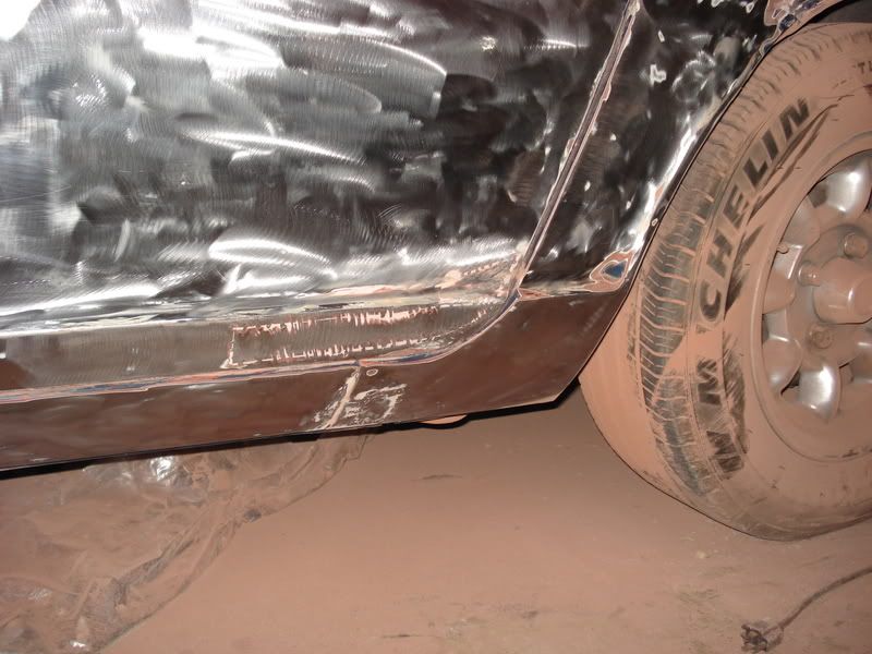

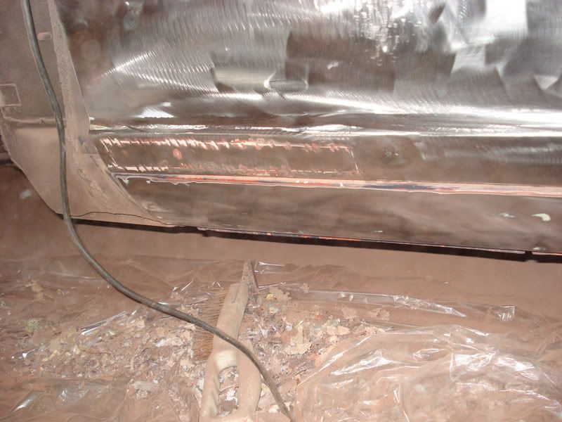

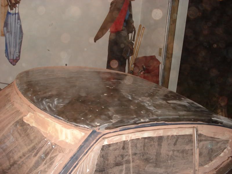

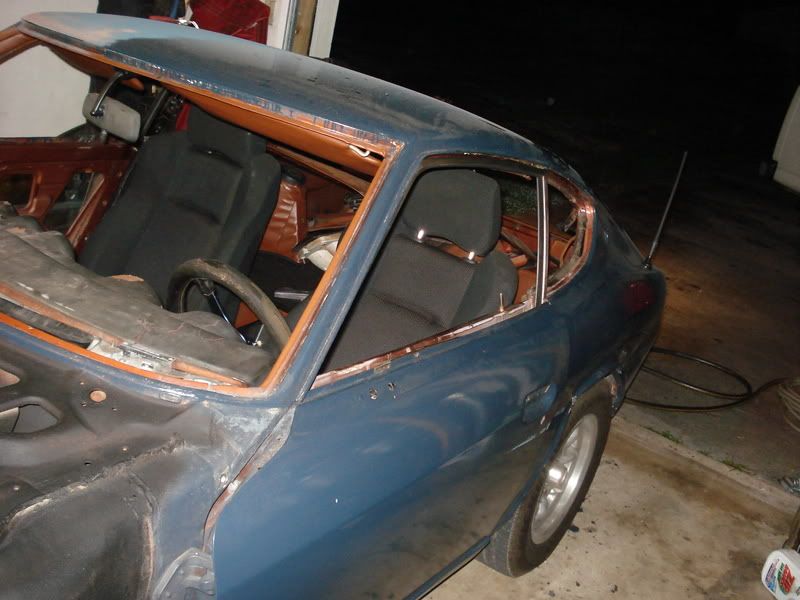

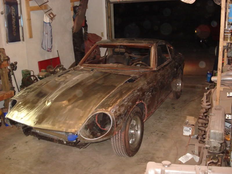

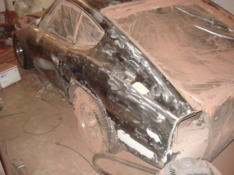

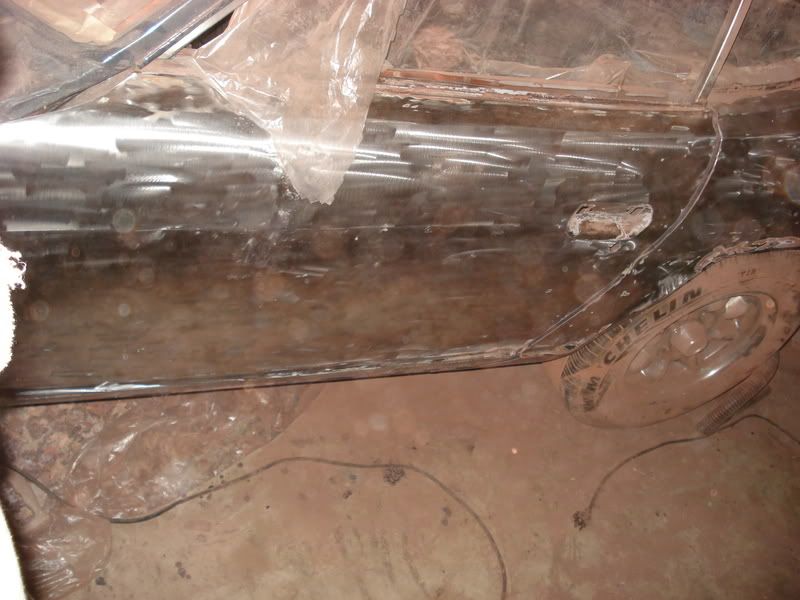

jeffer949 Posted July 1, 2008 Author Share Posted July 1, 2008 Another up date sorry its been a couple days. lets just say ive been doing alot of stripping!! I found a few patches but the look pretty good to me so il leave it alone. But ill probably finish stripping the other half tomorrow or the next day. Quote Link to comment Share on other sites More sharing options...

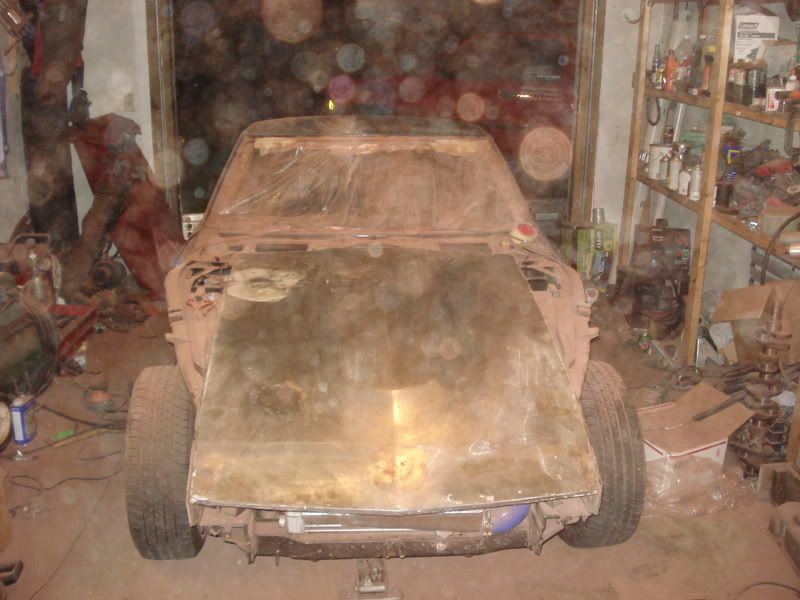

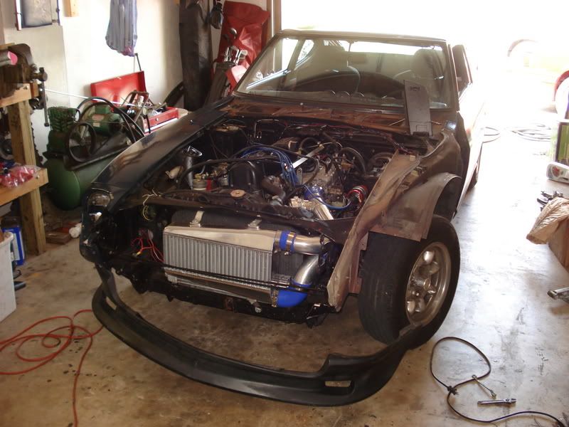

JSM Posted July 1, 2008 Share Posted July 1, 2008 Now I understand the dust! Wow, no wonder you were up until 6AM. Quote Link to comment Share on other sites More sharing options...
jeffer949 Posted July 1, 2008 Author Share Posted July 1, 2008 who said i was up till 6am?? Quote Link to comment Share on other sites More sharing options...
Pharaohabq Posted July 1, 2008 Share Posted July 1, 2008 So what are you using to sand with? I'd heard you could really muff up your paint if you get the sanding wrong. What did you use to undercoat beneath the fenders? Are you going to check your floorpans and rear wheelwells too, I mean redo the undercoat on them also? Looked like your left door and wheel well might have had some damage, or is that just the dust playing tricks? Are you going to do your own painting? Phar Quote Link to comment Share on other sites More sharing options...
jeffer949 Posted July 1, 2008 Author Share Posted July 1, 2008 Im using my trusty 4.5 inch angle grinder with these scotch brite type pads they sell at Lowes. strips the paint nicely but doesnt dig into the metal at all. And yes i have damage on my door and rear fender lip. I wrecked the car about a week ago. I doubt i will redo the under coating in the rear and floor pans. I dont have that much time. Im going to def. do my own body work. and depending on how much money i have left will depend on if i paint it myself or not. Quote Link to comment Share on other sites More sharing options...
TrumpetRhapsody Posted July 1, 2008 Share Posted July 1, 2008 Scotch brite pads you say... hmmm, might have to try that instead of painting over my old stuff. Looking good jeffer! Quote Link to comment Share on other sites More sharing options...
Pharaohabq Posted July 2, 2008 Share Posted July 2, 2008 Im using my trusty 4.5 inch angle grinder with these scotch brite type pads they sell at Lowes. strips the paint nicely but doesnt dig into the metal at all. And yes i have damage on my door and rear fender lip. I wrecked the car about a week ago. I doubt i will redo the under coating in the rear and floor pans. I dont have that much time. Im going to def. do my own body work. and depending on how much money i have left will depend on if i paint it myself or not. Yeah, I was thinking of sanding mine w/ my angle grinder, though like I said I'd be afraid of marring the metal. though I've used those scotchbright disks before, n they work well. I guess you could go over it w/ a good primer. The body shop I talked to this morning was saying you should use a green acid base primer to ensure no rust developes. If you're painting it, you should probably consult a shop in your area for your climate, or for instructions prior to them painting... I dunno. It's looking good, hopefully mine will turn out so well Quote Link to comment Share on other sites More sharing options...
bigblock96 Posted July 3, 2008 Share Posted July 3, 2008 hahaha not to bust your chops but I see you broke rule one when working on a car-------disconnect the battery.:razz:sorry but keep up the good work should look great when finished. Quote Link to comment Share on other sites More sharing options...
Evan Purple240zt Posted July 3, 2008 Share Posted July 3, 2008 Are those patches seam welded in? Or just tacked. If they are tacked, finish welding them in. I learned this from my old car. They tacked in patch panels and filled. The paint cracked around the patch eventually. Quote Link to comment Share on other sites More sharing options...

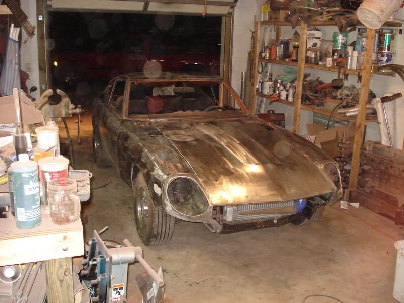

jeffer949 Posted July 4, 2008 Author Share Posted July 4, 2008 Im pretty sure they are welded in. It it a much better job than i could do. I would probably make it worse. Well i got the rest of the car stripped this afternoon. I also got my DTM primer today so that will be going on this weekend. I also settled on a color. THe Brickyard was just a tad bright for me and its really expensive paint. I saw this color today and i asked the paint shop about it and is 40 bucks cheaper per quart than the brickyard. Its called blackberry crush metallic. Its from a 2008 scion XB It is similar to the brickyard but it only has red pearl in it instead of red and white pearl. well here is a pic Quote Link to comment Share on other sites More sharing options...

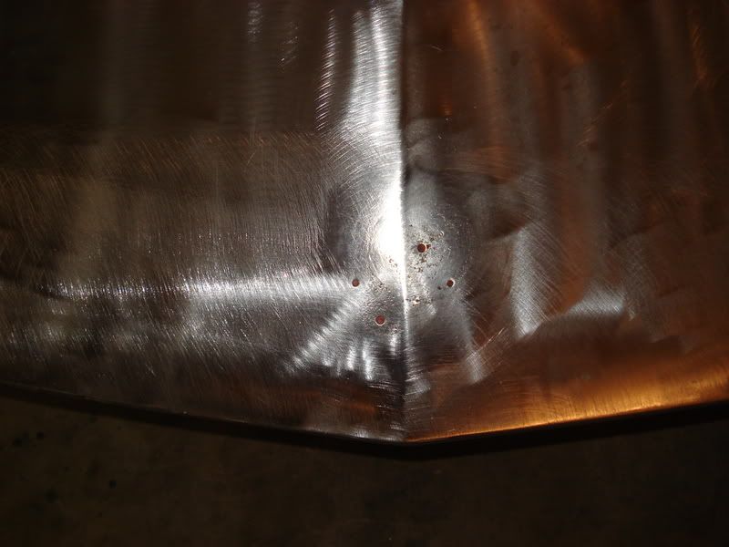

jeffer949 Posted July 5, 2008 Author Share Posted July 5, 2008 well got the fenders and headlight buckets stripped today. I was going to spray on the primer but realized i didnt have the correct respirator. So hopefully i can find one tomorrow cause i know my normal paint shop is closed. otherwise im gonna have nothing to do all weekend. So who says i should just clear it? Is this the normal hole pattern for the hood emblem? Quote Link to comment Share on other sites More sharing options...
rturbo 930 Posted July 5, 2008 Share Posted July 5, 2008 Is this the normal hole pattern for the hood emblem? That's not what mine looks like. mine is just the two horizontal holes (top hole on left side of crease, bottom hole on right side of crease), not the diagonal ones. Quote Link to comment Share on other sites More sharing options...
