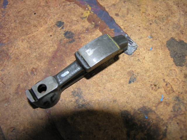

sonomaz Posted January 9, 2009 Author Share Posted January 9, 2009 So the personal budget opened enough to regrind my cam and buy rocker arms. I picked up a set of rockers from Motorsport Auto for ~$250. The issue is they are not manufactured by Nissan. When I spoke to Crane Cams they were very specific about using Nissan rockers to minimize scarf (is this a real word?) issues. So two questions: 1) how important do you thnk it is to have Nissan manufactured rocker arms; 2) where can I get them for a reasonable price? I got my cam back. I'll get some pictures posted soon. Quote Link to comment Share on other sites More sharing options...
2eighTZ4me Posted January 9, 2009 Share Posted January 9, 2009 Wow - they really prong you for rocker arms. Do you have any factory rockers off that head or another head? I sent mine to Delta Camshaft out west and they do a fabulous job of resurfacing rocker arms. I got a set of 12 done for just over $50 with shipping and they look like brand new. If you have a set lying around, I'd go that route and send the MSA ones back. You'll at least know that they are geniune Nissan and from the correct metallurgy. My humble $0.02 worth. Quote Link to comment Share on other sites More sharing options...
Pyro Posted January 9, 2009 Share Posted January 9, 2009 So the personal budget opened enough to regrind my cam and buy rocker arms. I picked up a set of rockers from Motorsport Auto for ~$250. The issue is they are not manufactured by Nissan. When I spoke to Crane Cams they were very specific about using Nissan rockers to minimize scarf (is this a real word?) issues. So two questions: 1) how important do you thnk it is to have Nissan manufactured rocker arms; 2) where can I get them for a reasonable price? I got my cam back. I'll get some pictures posted soon. deltacam will resurface stock rocker arms for 4.00/each. They also do cam regrinds for 60.00. I use a zddp oil additive. cost 10.00 extra for each oil change. Quote Link to comment Share on other sites More sharing options...

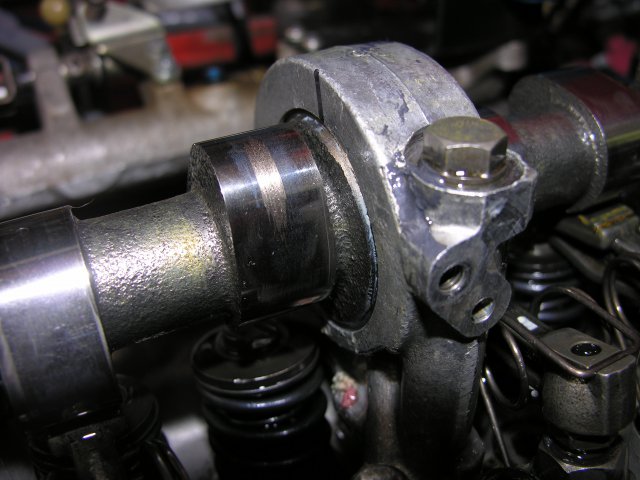

josh817 Posted January 15, 2009 Share Posted January 15, 2009 So what if we went with the Chevron Delo and some ZDDP. Such think as TOO MUCH zinc? I'm all worried now as I have the same mileage and a Schneider .495" 290º cam and last time the valve cover was off I was paranoid but when I ran a feeler gauge over the lobe it didn't catch on any nooks or crannies.. Still, a good oil change would be great for my baby. Also if I were in your situation and the rockers were ok I would just get them cleaned up and buy a new cam/have one reground. Only because cams by themselves are what? under $200 I think? If you already have the hot springs and such there is no point on buying the entire cam kit unless you buy from MSA. They won't guarantee anything unless you buy the kit so everything is properly setup for that particular cam as far as spring rates go and such. Quote Link to comment Share on other sites More sharing options...
2eighTZ4me Posted January 15, 2009 Share Posted January 15, 2009 They won't guarantee anything unless you buy the kit so everything is properly setup for that particular cam as far as spring rates go and such. Well - either I got a bum deal, or MSA doesn't really "check" their kits. I got stock lash pads with my cam kit. .120". Lash pads for the Schneider kits are supposed to contain .150" lash pads. Hence, I didn't check wipe pattern thinking that the kit was "matched". What a mistake. 8k mi. later, I've got a rounded off lobe on the cam. Ate it up. So just a word to the wise - even though you buy the kit - double check your wipe pattern and measure your components before firing that bad boy up. Quote Link to comment Share on other sites More sharing options...
z-ya Posted January 15, 2009 Share Posted January 15, 2009 I'm sorry I'm chiming in a little late here, but the problem is not the cam, or oil, but a combination of aftermarket rockers and the wrong thickness lash pads (wipe pattern way off). An alternative to new rockers is having some Nissan ones reground by Delta Camshaft. I think they charge around $3 each, and the come back looking like new. I've been running reground rockers with a Comp Cams camshaft and the correct lash pads for over 5 racing seasons without any issues. Stay away from aftermarket rockers, and always check the wipe pattern on EVERY rocker arm. Pete Quote Link to comment Share on other sites More sharing options...
2eighTZ4me Posted January 15, 2009 Share Posted January 15, 2009 All the research I've done on this site and others suggests it is a lack of ZDDP in the oil and "cheap" metallurgy of new billet camshafts. I can't attest to the aftermarket rocker theory, but it would stand to reason as well that the metals today are just not as refined and hardened as they were back then - rockers or cams. So much so, that Schneider sends you a big yellow notice that falls out of the cam box as you unroll your new cam stating that you MUST use one of the following oils due to the presence of zinc. THEY know something is wrong (whether it having to do with the oil or not - they're just covering their butts). My situation was perhaps a combination of both. My cam kit came with the wrong lash pads and I (spelled DUMBA$$) didn't check wipe pattern, as well as used an oil without ZDDP. Regardless, I am using Delta regrind rockers with an old Racer Brown cam, and running Valvoline VR1 with a bottle of ZDDP Plus added. I'm just not taking any chances. Wipe patterns have all been checked and are spot on. I've read many theories on this and don't exactly know what to make of it, but there are those on this forum whose opinions I respect highly who have made a point that ZDDP is indeed a factor. Quote Link to comment Share on other sites More sharing options...
