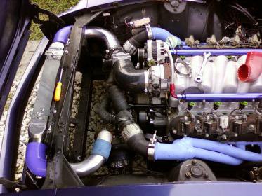

yessir Posted October 17, 2009 Author Share Posted October 17, 2009 almost done! Quote Link to comment Share on other sites More sharing options...
80LS1T Posted October 17, 2009 Share Posted October 17, 2009 Lookin good man! Glad to see the swap is coming together! Quote Link to comment Share on other sites More sharing options...
sq_creations Posted October 19, 2009 Share Posted October 19, 2009 So what are the details on the swap. Did you use the truck headers? single or twins? Looks good from what I can see. Quote Link to comment Share on other sites More sharing options...
Sparks280zt Posted October 19, 2009 Share Posted October 19, 2009 Gonna fit under the stock hood, right? Quote Link to comment Share on other sites More sharing options...
yessir Posted October 20, 2009 Author Share Posted October 20, 2009 cross-over pipes fit under stock hood. Quote Link to comment Share on other sites More sharing options...

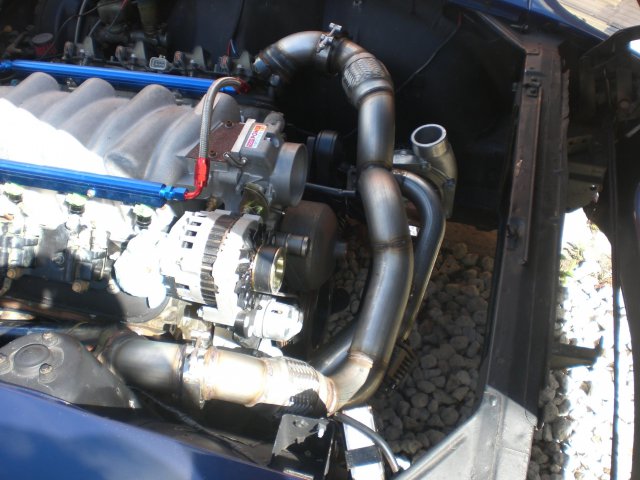

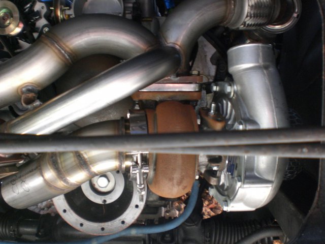

yessir Posted October 20, 2009 Author Share Posted October 20, 2009 So what are the details on the swap. Did you use the truck headers? single or twins? Looks good from what I can see. the truck header did not fit(the hit frame rails). I used mustang 5.0 unequal length header mated to ls1 flanges with 2.5 inch crossovers feedind a t76:mrgreen:.I will post more pictures as soon as i can Quote Link to comment Share on other sites More sharing options...

yessir Posted October 30, 2009 Author Share Posted October 30, 2009 more pictures as promised Quote Link to comment Share on other sites More sharing options...
yessir Posted October 30, 2009 Author Share Posted October 30, 2009 If it runs half as good as it looks i will be happy. Quote Link to comment Share on other sites More sharing options...

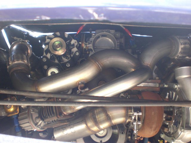

yessir Posted December 1, 2009 Author Share Posted December 1, 2009 One step closer! Quote Link to comment Share on other sites More sharing options...
sq_creations Posted December 1, 2009 Share Posted December 1, 2009 What coating did you go with on your headers? Quote Link to comment Share on other sites More sharing options...
Evan Purple240zt Posted December 1, 2009 Share Posted December 1, 2009 Looks like swain coating. Man, that is some fantastic work. I would love to do this in my 240sx. Quote Link to comment Share on other sites More sharing options...
yessir Posted December 2, 2009 Author Share Posted December 2, 2009 The headers and the "y" pipe are painted with vht exhaust high temp paint. Not sure how well it will hold up but it sure looks good now! You can't see it in the picture but i also put on a dei titanum turbo blanket which looks and fits great, probably one of the lowest profile turbo blankets ive seen yet Quote Link to comment Share on other sites More sharing options...
