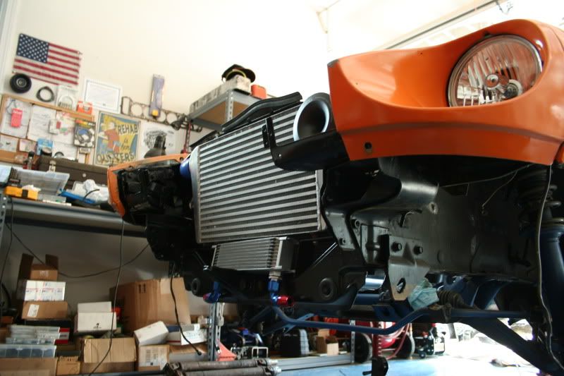

Never put a second layer of soundmat down, and the passenger side still has a tiny patch of fiberglass. About it running... its not. I still have yet to complete the shortblock, since the Nissan Comp oil pan dictates that I make a custom oil pickup (all the stock pieces I try are too short). So in the meantime I've been getting these little projects done. Rerouting a new fuel system, replacing most of the plumbing with AN lines, cleaning up the engine bay, creating intercooler ducting, fabricating a custom intake, installing the 240sx transmission... that's just scratching the surface. I hope I get it on the road this summer... :(

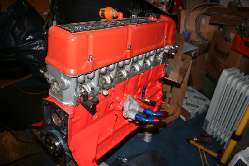

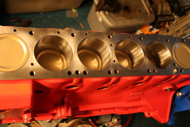

All the Pistons and rods are in and torqued to spec. The assembly rotates "freely" but the red assembly goop offers some resistance. I plastigauged all the bearings so... fingers crossed...
Used some scrap 1/4" steel to make myself a side engine mount for better access.

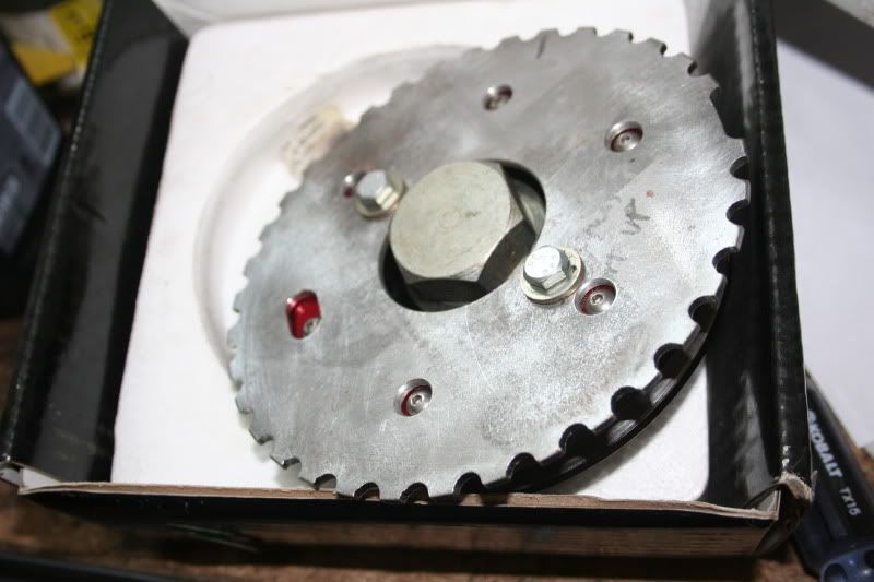

Finally have a 36-1 crank trigger wheel mounted on my MSA comp damper. Hopefully its thick enough and will be able to trigger the coil on plug system for Haltech.
Tial 38mm wastegate. I also have a 90 degree weld el and flanges to mate it to the exhaust manifold like Noddle's setup.

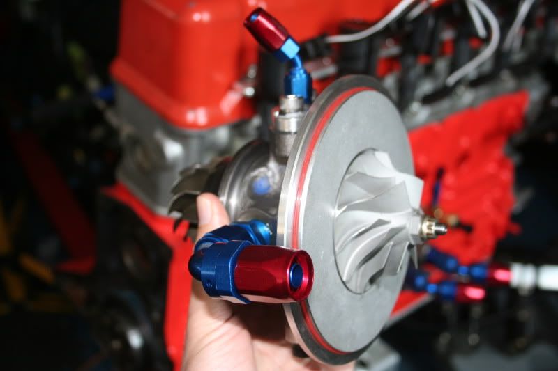

I bought a .50ar compressor housing and 50 trim wheel off ebay according to looking at the compressor maps on the forums. Supposedly this is the best setup for the engine from my understanding. Also got a brand new water cooled center section and plumbed everything accordingly.
This is all just mockup. Making sure everything fits the way its supposed to, but nothing is really bolted on. The oil pan has a large space I'm looking though to check clearances between the counterweights and the windage tray. The rear of the pan still needs to be bumped out to clear the rear two ARP main studs. Coil on plug setup is thanks to 1 fast z's excellent mounting bracket. Also not shown is the Haltech triple channel igniter module that I'll be using to run waste spark (not using the EDIS module).

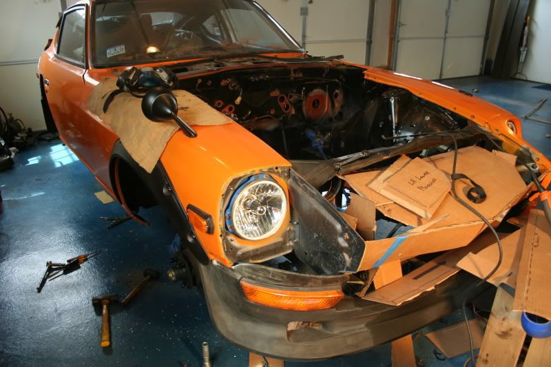

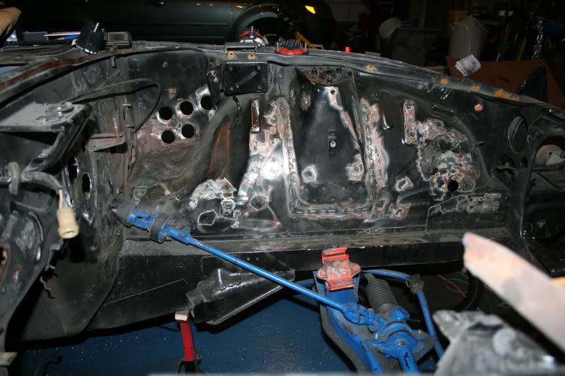

Fenders are finally cut and welded up to clear the tires. :rolleyes:
Test fitting the 240z dash.

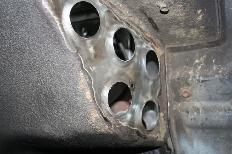

Using a dimple die to make holes out to the inner fender, with hopes to vent engine bay air and reduce pressures. At some point I'd like to duct these into a fender vent just aft of the front ZG flares, but at this point I really need to stop so many while I'm at it projects and just get the damn car running again.

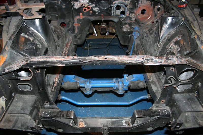

Prepping the engine bay for paint and then engine installation. Did some seam welding with short stitches. The battery tray is currently removed, as well as the pitted metal below it. I'm tacking in new sheet metal, but not a new battery tray. I'm going to relocate it to the trunk and possibly use a small profile unit from Braille. That will leave room for something like a methanol tank if it comes down to it. I also have about 50ft of brake line to replace EVERYTHING, and a 79-81 15/16th master cylinder and large brake booster ready to go in. Not enough money currently to drop on the 4x4 Toyota brakes, but at least its somewhat of an improvement for now.

Very cool, you've sure been doing a bit of work. I like the coil on plug packs. that's a pretty cool looking idea. The Timing wheel, is that just bolted to the front of the damper? I've gotta admire the amount of work you've been putting in since my project has been advancing fairly slowly. I was looking at painting my engine compartment, but I can't yet afford to paint the whole thing so I'm kinda stuck in that it really should all be sent for stripping and paint before I doo too much more, or I'll be tearing it all down again when the time comes for paint. I kinda don't want to be redoing too much work. I'm sure you know what I mean.

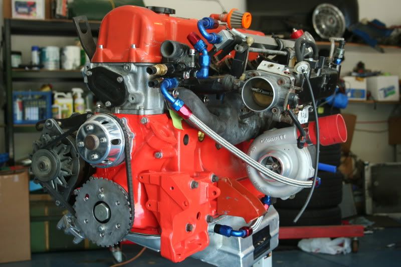

Photos speak for themselves, mostly.
I'll admit the last photo shows a lot of ancillary components like the manifolds merely mocked up on the block, not fully installed, for clearancing the plumbing. The tiny stock turbo probably won't be put on there, but because my other T3 exhaust housing has two broken studs WITH broken extractors in it I'm screwed unless I either cannibalize the stock Nissan turbo or find another T3 stage 1 housing (nearly impossible it seems). I can't run the OEM turbo anymore because it has a dry housing, and the motor is now set up for a water cooled center section. Sure, I could just cap off the lines temporarily or join them together to complete the circuit, but that would just be silly.
Also making an appearance in the photo is my modified transmission (FINALLY done). There's a red puddle under the engine that you might be able to see. I'm still in the process of modifying the oil pan and the pickup to fit the engine, which has been a total pain. The recent heat wave has decreased the viscosity of the assembly fluid so it's been dripping down to the floor, with no oil pan to catch it.

It's been so long since this thing has been "grounded" that it barely feels like I'm working on a car anymore... Bodywork is the worst. I love welding, but I wish I didn't have to do so much of it on the car itself.

Welding has been an absolute pain, at least for the engine bay. I had to reconstruct the battery tray from several pieces of new metal. I originally had just one, perfectly cut and fit piece. However, once I started tacking it everything went to hell, and I had to cut some of the excess that wouldn't form to the original curve. Whether this is because I mis-measured or the welds stretched it, I don't know. I had to tack in another piece so it looks like a mess.
