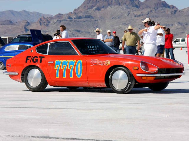

LVSALT Posted October 10, 2009 Share Posted October 10, 2009 World finals going on at the salt now, Got these images off landracing and SCTA site. only info I have is Victory motorsports, made a run so far at 161.95 mph. maybe someone here knows the car. Gary Cole DCWATERJET Z Quote Link to comment Share on other sites More sharing options...
Daeron Posted October 11, 2009 Share Posted October 11, 2009 World finals going on at the salt now, Got these images off landracing and SCTA site. only info I have is Victory motorsports, made a run so far at 161.95 mph. maybe someone here knows the car. Gary Cole DCWATERJET Z Wow. That thing could almost be stock plus full moons and headlight covers. A buck sixty. That sends a charge down my spine:burnout: Quote Link to comment Share on other sites More sharing options...

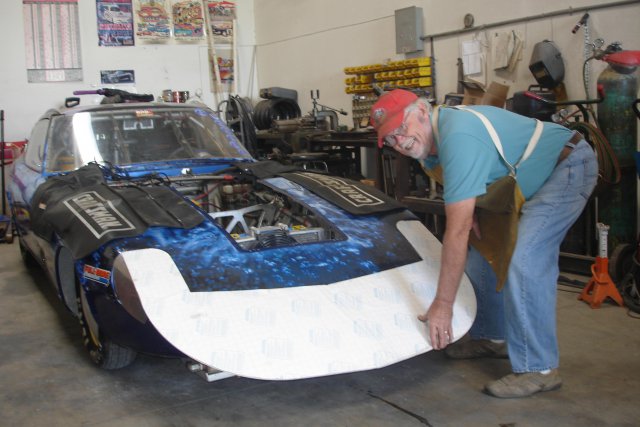

LVSALT Posted October 29, 2009 Share Posted October 29, 2009 started messing around with some possible nose configurations. notice the red hat my dad has on. Thats what I am after. Gary Cole DCWATERJET Z Quote Link to comment Share on other sites More sharing options...
