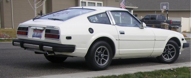

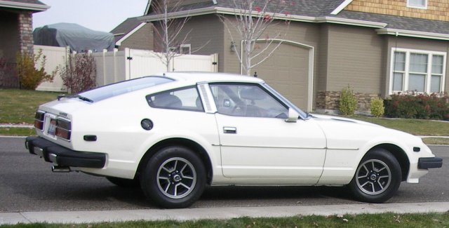

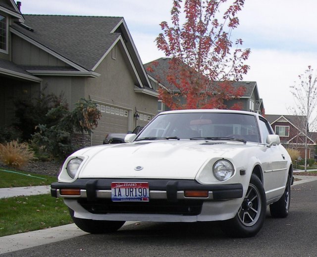

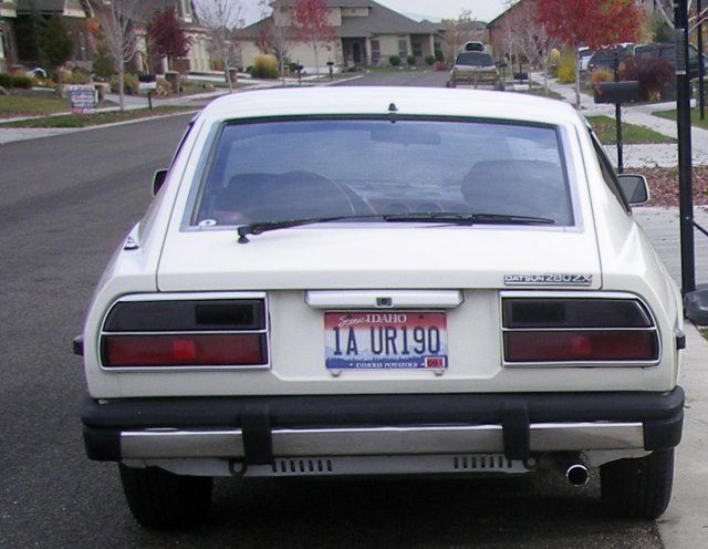

Hi everyone,
I thought I would upload some new pics of the Z after some clean up work. The rims came out better than I had planned and I may go later and have them powdercoated. I finished the brakes and installed the new clutch kit and everything is running great. About ten minutes before I was going to take the car off the jackstands after finishing the clutch the Fedex guy shows up..... He has all of my new bushings from energy.LOL I guess I got next weekend planned out. This car cost me $500 and I drove it home. It was alot uglier then though. I have some older pics of it if anyone would like to see the difference. I repainted the hood vents candied the side markers and the tail lights, also I put in some 300Zx seats and new door panels.

Phil I will let you know about that bushung project soon. The rims were pretty strait forward. I used Laquer thinner and my wire wheel attachment on my compressor to really get the old "paint"??? off. then I went in with a 3m pad to get in there and clean out those hard to get areas. Next I used my finer wire wheel to really buff out the areas that I intended to leave unpainted. I highly recommend that you use the Blue painter tape to cover the polished areas. I taped over the raised areas and used the side of a 3/8 retchet extension to cut the tape. I just rubbed the extension along the edges to keep my lines strait. I couldnt imagine trying to keep everything lined up right by using a box knife or a blade. This rubbing technique takes a little more time but it is worth it in the long run. imho. As far as taking the wheels off there is no need just use newspaper and tape around the rim and cover your tires. I wish I had taken some pics of this process. In the future I will document things like this better. Thanks Woldson;)

Well I don't know how much a wind shield is but I tinted my car for $150 for 5% all the way around and then did the front windshield myself in 30%. I kinda regret going with 5%. I would rather have 20% on every piece of glass. Luckly I do window tint and can redo it any time I want.
