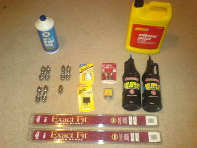

g9m3c Posted December 25, 2008 Author Share Posted December 25, 2008 Brakes are fixed! Turns out, the master cylinder was fine, it just needed some fluid and a little bleeding. Now it'll make the seat belts catch if you stomp it hard enough. I got my other two new tires mounted, as well as the battery hold-down repaired, painted, and installed. I also got my fuel pump wired in. It's officially a running, driving car now. I drove it probably 3-4 miles today with not one problem. I tell ya, with just a 99% stock L26 with flat tops, this thing gets up and goes pretty well. It'd keep up with my truck, for sure, if not pass it. I didn't change the rear diff. or trans. fluid yet though. I checked them both and they were full and the fluid looked pretty good and clean in both, so it was fine for a couple of test drives. I'm definitely gonna change em out before it goes to Tuscaloosa though. If Christmas wasn't this week, it would be going down there this weekend. My insurance office is closed Friday though, and I assume the tag office is as well. Whenever I can get my mom and dad to come with me, it'll be there. I'll have to drive the Z, my dad will drive my truck, and my mom will drive her car. That way I'll have my truck in case the Z messes up.......not that I don't trust my work, but it HAS been sitting up for 3 years. Quote Link to comment Share on other sites More sharing options...
