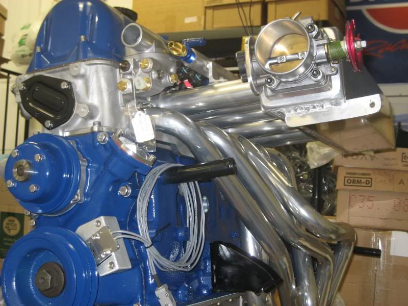

PanzerAce Posted December 5, 2008 Share Posted December 5, 2008 I have nothing to add to this discussion other than to say that is a REALLY clean looking engine What intake is that? Quote Link to comment Share on other sites More sharing options...
RisingSun Posted December 5, 2008 Author Share Posted December 5, 2008 Thanks, I'm really trying to do everything correct here, so the engine is reliable and lasts a long time. It's a 3.1 Stroker, and all the precautions were taken: sonic tested block, entire assembly balanced along with flywheel and pulley, ceramic coated bearings and pistons, ported head, and the intake is a handbuilt custom which looks good but won't know about the function until I get the engine running with the SDS system. I'm trying to get this to breath the best it can for max power within the budget. Quote Link to comment Share on other sites More sharing options...
