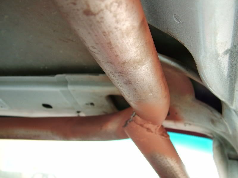

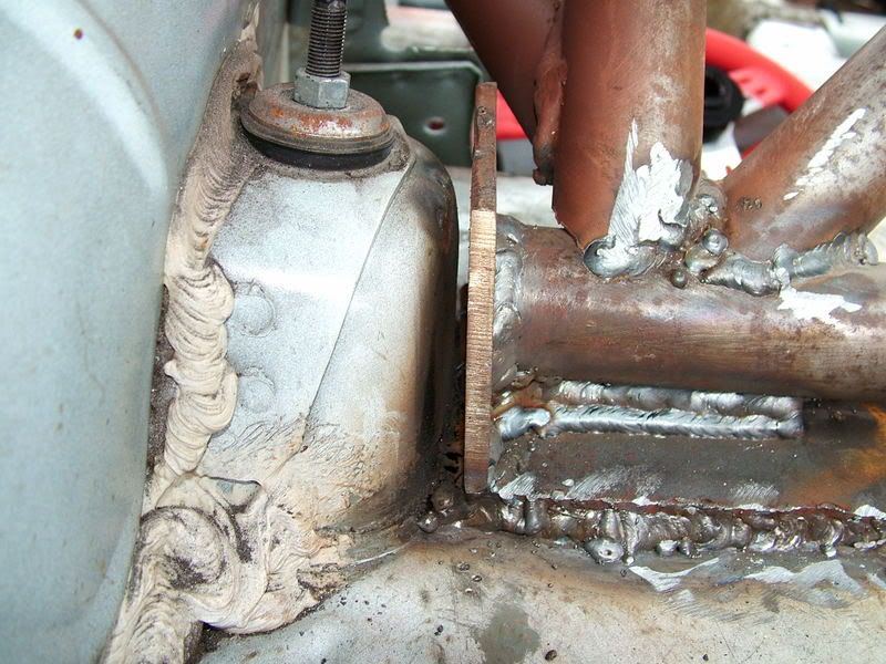

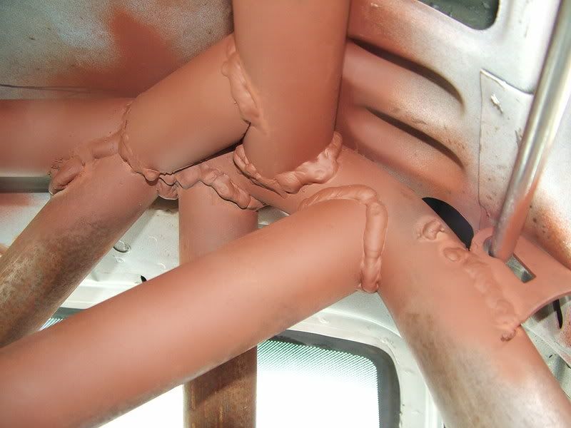

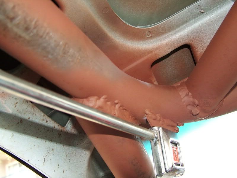

Z-Noob Posted December 4, 2008 Share Posted December 4, 2008 Im not a cage expert, but I do know that those welds need some work. Im curious as to how much penetration you got...If those pictures are of the finished welds, it is FAR from complete. Quote Link to comment Share on other sites More sharing options...
JMortensen Posted December 4, 2008 Share Posted December 4, 2008 Ouch. Cut it out and start over, or consider paying someone to do this job for you. Your pipe fitting skills look like they need work, and the welds are really not sufficient. Your welds also need to be all the way around every tube, which is part of what makes building a cage such a PITA. Your welds also look very bird poopy, makes me wonder if you're using a stick welder or something. When you have a plate like you do in the back next to the shock tower, connect to the shock tower, don't almost connect to it. You only need .100" thick plate. Looks like you used 1/4" or 3/8" there. I can't tell what kind of tube you're using, but I'd guess that it is wrong too. I'm sorry to say it, but this one is a complete do over. Cut that thing up and practice practice practice before you start again. Quote Link to comment Share on other sites More sharing options...
rturbo 930 Posted December 4, 2008 Share Posted December 4, 2008 I'm not a cage expert, but I definitely agree with what's been posted. Sorry. Quote Link to comment Share on other sites More sharing options...
