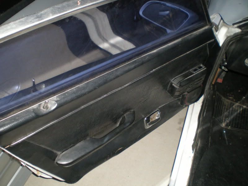

Nigel Posted July 12, 2009 Share Posted July 12, 2009 I went with the generic Chinese version off ebay from the vendor "alpha-bid". It turned out it was cheaper to buy the four window kit and split it with a friend than to buy two two window kits! The 4 window kit is $160, and the two window kit is $96. The only downside is that you get a 4 window switch pod and 3 single switch pods instead of a 2 switch pod and 1 single switch pod. However, I mounted my switches directly in the center console of my 240, so I didn't need the pods, and you also end up with extra switches for spares! Oh yeah, you do have to be comfortable with electrical work, because the wiring harness does have to be modified. But there's yards and yards of wire to work with. My friend and I have both had our kits installed for about a year, and they've worked great so far. The motors are supposedly made in Japan, so they should be reliable. Also, there apparently is a built in clutch system so the motors don't stall when the windows reach the top and bottom. The caps that cover the hole in the door panel are pretty much flush, and blend in very nicely. I'm 6'7" tall, and I like the fact that my knee doesn't bash into the window crank any more. I just have a few pics so far. I'll see if I can find some time to take more today... Here's one of the 2 window kit: Overall install in the door: Closeup of window crank: Closeup of motor mount: Door panel cap: Wire harness to door using rubber grommets and corrugated plastic wire loom (the wires don't get pinched in this location): Switch location (I need to repaint the switch plate flat black): Nigel '73 240ZT Quote Link to comment Share on other sites More sharing options...

bens1088 Posted October 12, 2009 Share Posted October 12, 2009 I got a deluxe kit for my s130. SUPER easy to install took me a day. Also got the combo lock kit. Everything works great. The plug on the door fits pretty much flush for me. Don't even notice it (black interior). Quote Link to comment Share on other sites More sharing options...
