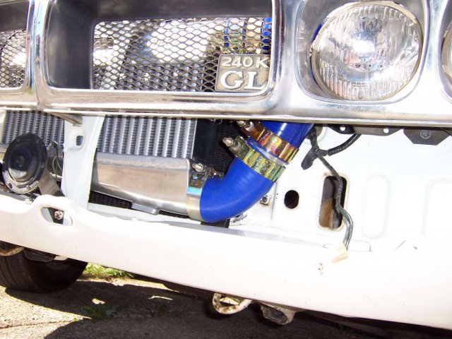

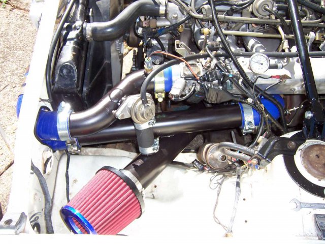

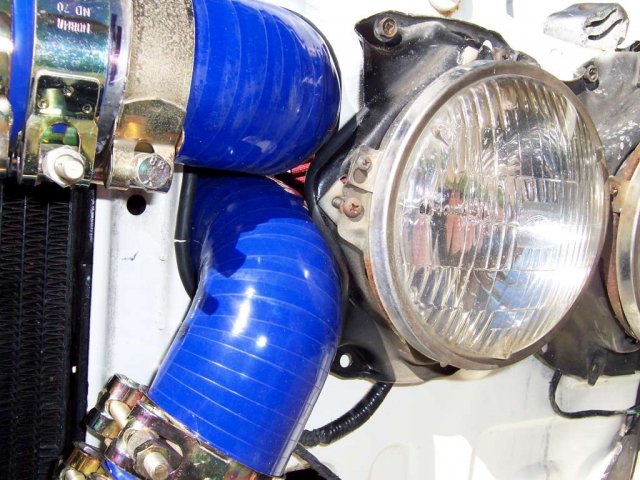

Noddle Posted April 8, 2009 Author Share Posted April 8, 2009 Hi, I finished my intercooler, and it work wonderful, now I think I may be needing a new clutch, Nigel Quote Link to comment Share on other sites More sharing options...
