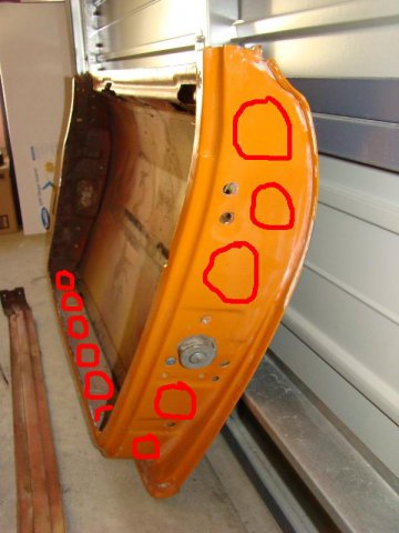

S15 200sx owner Posted March 10, 2009 Share Posted March 10, 2009 Hi there Guys, I attacked the doors off my racecar today. I was wanting to reduce the weight of them as much as possible. And after reading a couple of other threads on here, i got into it. I had already removed the glass and regulator, so now I cut out the whole inner panel, but left the side frame to give the door some stiffness (On another previous racecar - Not a Zed - I only had the outside skin and if wobbled and flexed all over the place at speed - Not ideal) Once the inner panel was gone, i then removed the little stiffning bar that ran the lenght of the door, hard up against the skin. Cant really call it an intrusion bar, as it is pretty light pressed steel. This came out pretty easy really - Undo the two scews at one end, and then drill out the two spot welds at the other end - Too easy. The next task is too cut/punch some holes (using chassis punchs) in the rear end and bottom part of the frame (as per the red circles on the photo) Dont really think i wanna cut holes in the front part, as the hinges attach there, and i should probably leave that a bit stiffer to support the weight of the door, all be it reduced. I simply used a 1mm thick cutting disc on a 115mm angle grinder - They work very well - Like a hot knife thru butter Just got to clean up the edges now, and eventually after painting i will push on a strip of rubber molding over the edge to tidy it up, and not have a sharp edge. For those wondering how i will open the door from the inside, i will simply attach a pull cord from the lock lever accross to the front end of the door - Just like Ferrari did on the F40 Nice and light. I do have two sets of doors for this car, so i can put the other stock set on if i ever need/want to have wind up windows etc. Edit: I just weighed the pieces that i cut out/removed from one door - 3.5kg - so that will be 7kg over both doors and by the time i cut the holes - Hopefully we get close to 10kg total weight saving over a pair of already bare stripped doors. - Doesnt sound like a lot, but all these little bits add up. And being lighter improves all areas of performance, acceleration, braking and turn in and handling. Quote Link to comment Share on other sites More sharing options...

S15 200sx owner Posted March 10, 2009 Author Share Posted March 10, 2009 cockerstar said: So, how much weight did you end up cutting out? I have made an edit to the first post, after weighing the cut out material. Quote Link to comment Share on other sites More sharing options...

S15 200sx owner Posted March 11, 2009 Author Share Posted March 11, 2009 Yeah even the 240 doors (which are the lightest of the 3) are still bloody heavy in stock form. People that have never lifted a door that has not been attached to their car will sh!t themselves when they first realise the weight of these things - Crazy!! I could go weigh a totally stock 240 door for a comparison. You guys with the 280z doors will save way more weight than me as the side intrusion bars in them are huge is comparison to the 240 ones - HUGE! Quote Link to comment Share on other sites More sharing options...
S15 200sx owner Posted March 11, 2009 Author Share Posted March 11, 2009 Ok, I have just weighed a totally stock 240z door (including the door trim panel) at 23.65 kilograms (52.14 lbs) And my stripped and cut out door with the glass frame bolted back on but no glass (but havnt cut the planned holes yet) at 11.05 kg (24.36 lbs) So a total weight saving of 12.6 kg (27.77 lbs) per door, so thats over 25kg (55 lbs) for a pair of doors, and i reckon thats pretty good. - Its like taking one of the doors right off! There appears to be a bit of filler in the bottom of my door too, maybe 10 lbs of it going by the 17 lbs that Jon mentions above Quote Link to comment Share on other sites More sharing options...
