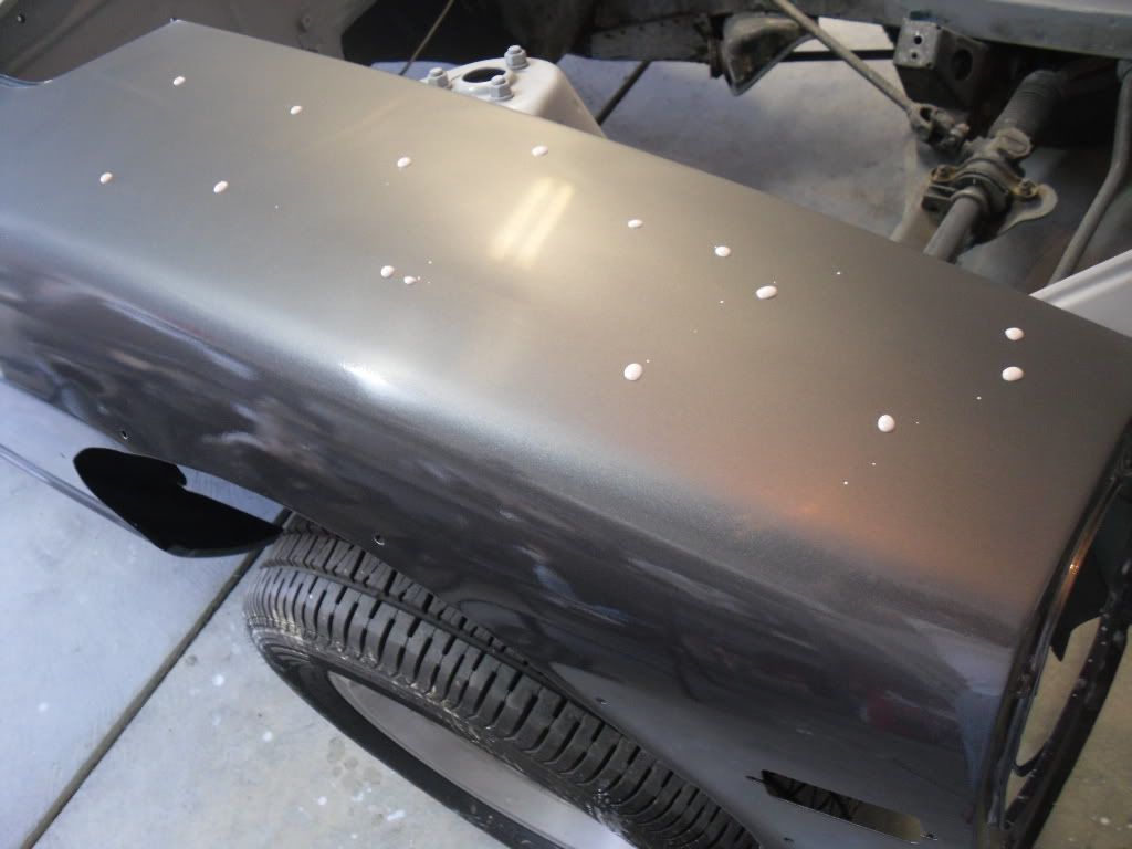

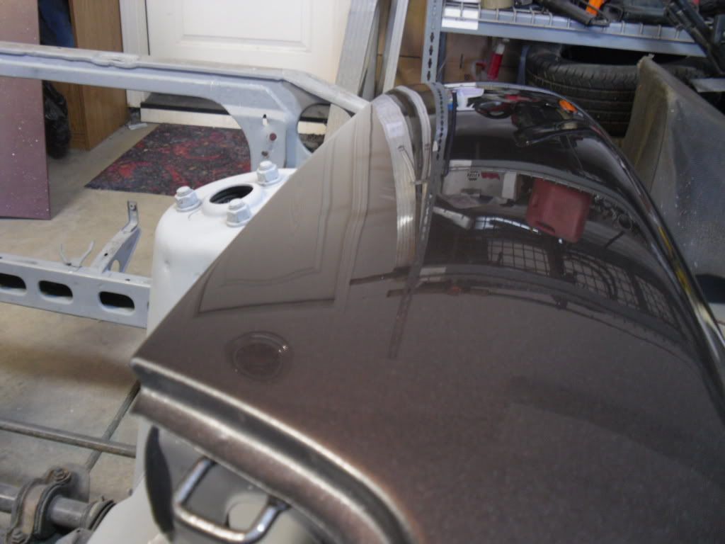

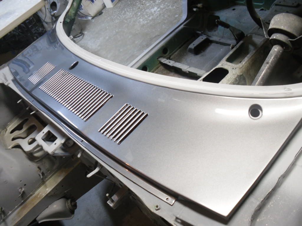

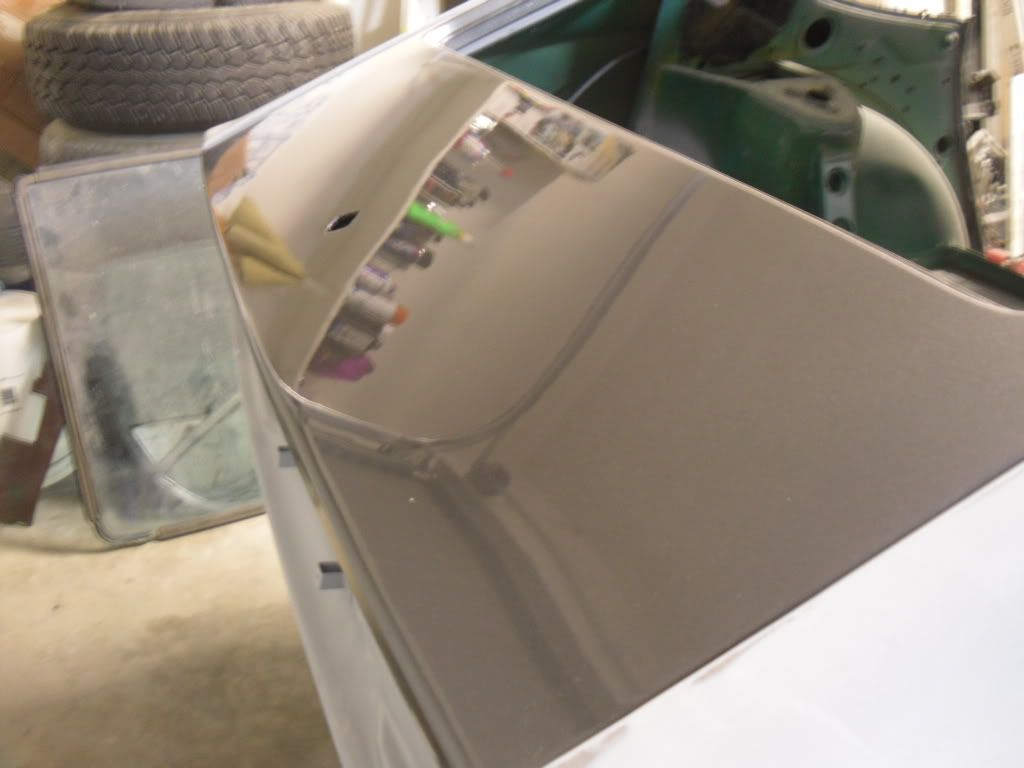

piston Posted August 5, 2009 Author Share Posted August 5, 2009 well, i primered it again today for the second time and i was amazed at how clean the primer came out. it dried to a shine and looks like a nice gray single stage paint... and it still shows to barely noticable dings about .001 deph. lol. [/url] heres a shot of my spray gun if anyones interested. runs about 150.00 retail at a local napa autoparts. company who makes it is called sharpe. model fx3000 HVLP heres a pic of the cowl i just color sanded last friday, cut, buff and polished... heres my mirror effect hatch at night inside the garage...gotta make sure it shines in the parking lot at night...lol.. Quote Link to comment Share on other sites More sharing options...

rsicard Posted August 6, 2009 Share Posted August 6, 2009 Piston: That Cowl looks VERY GOOD! What color and paint code are you using. I have a silver 71 240Z and want to repaint it and am searching for colors. Please advise. Thanks. Quote Link to comment Share on other sites More sharing options...
piston Posted August 6, 2009 Author Share Posted August 6, 2009 (edited) Piston: That Cowl looks VERY GOOD! What color and paint code are you using. I have a silver 71 240Z and want to repaint it and am searching for colors. Please advise. Thanks. haha, lol, i would be hating if i keep the color codes to myself. but if i share it then i might be the second with the 09 gtr skyline grey metalic. j/k but anyways, the color code is KAD. I have access to any color code you need, just let me know. vehicle make, color name and i can pull a code. just in case anyone might wanna look cool but slightly different. honda has this color called polish metal very similr tothis color but more silver. code if NH737M. Edited August 6, 2009 by piston redo Quote Link to comment Share on other sites More sharing options...

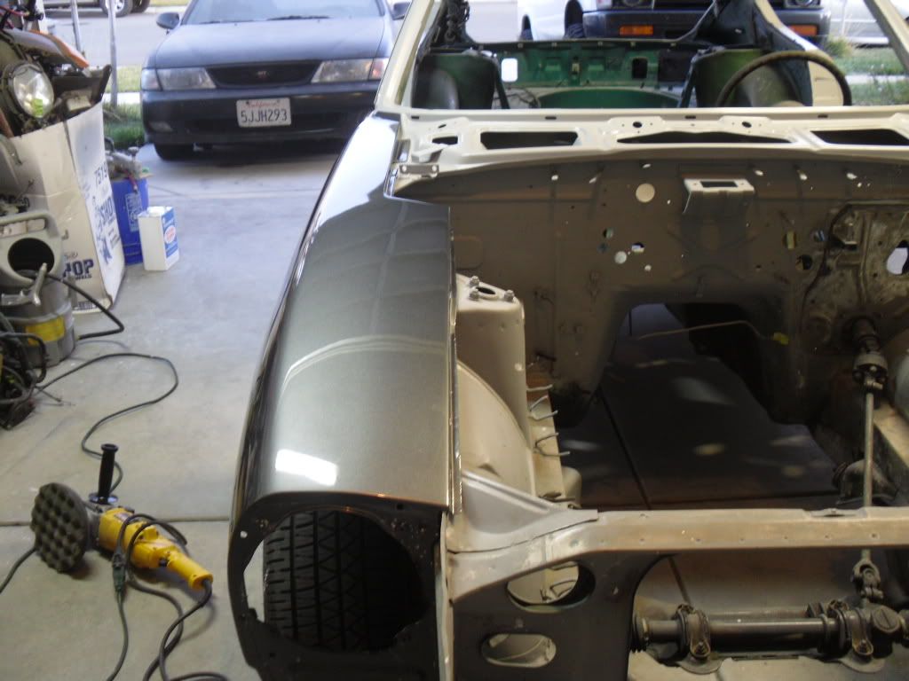

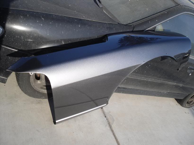

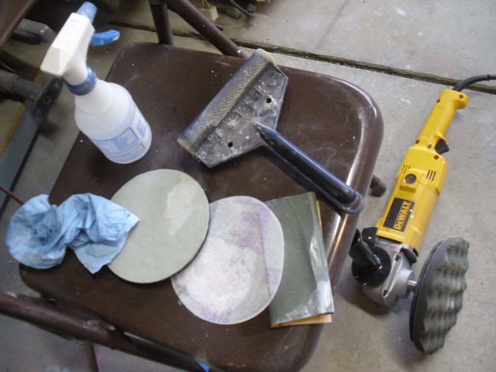

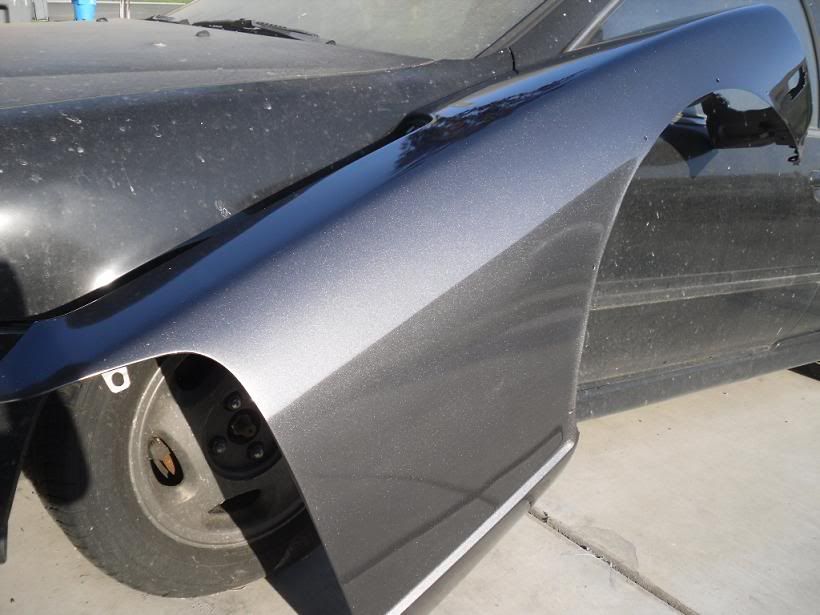

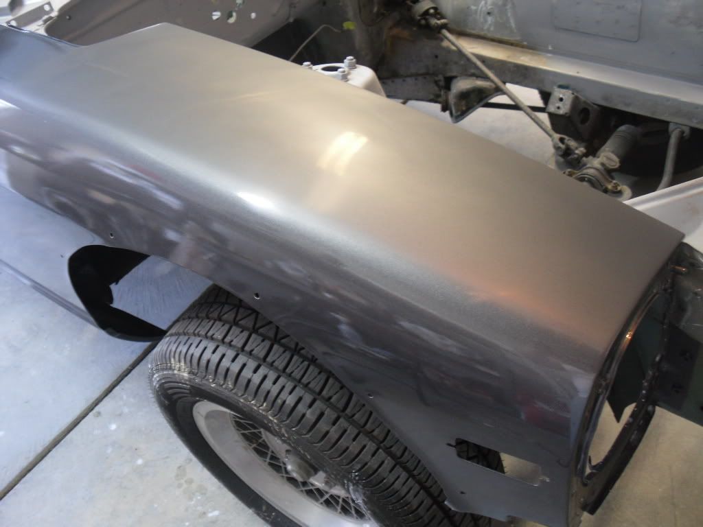

piston Posted August 6, 2009 Author Share Posted August 6, 2009 (edited) today i colorsanded the top section of the fender since doing the whole thing takes too long, i am doing it section by section...these are my tools...im using the same sandpaper disc from last time i used to do the cowl. its by 3m made with some kind of wierd thin plastic looking backpad with micro 1500(white plastic) and 3000(left pad)crystals. it hooks (aka hook it) onto a round backing pad with a strap for two finger slot for hand use. these pads last for some time. 2500 grit for the gray paper sheet. also a squegy, if thats even how you spell it. lol. a spray water bottle and my barrowed dewalt electric buffer/polisher. all this was performed under an hour. this is what is looks like after 3000 grit. it only takes this much to cut/buff/polish each round of buffing/polishing... this is the result. nice and shiney and nice clean reflections with no orange peel. notice the bottom section hasnt been sanded or buffed. 3000 grit finish before buff/polish. final product...almost mirror like from low angles. heres a front distance shot of the fender/front view. looks brand new...hehehe Edited August 6, 2009 by piston redo Quote Link to comment Share on other sites More sharing options...

tfreer85 Posted August 6, 2009 Share Posted August 6, 2009 That really is an awesome job piston. What speed is your dewalt spinning at? Also I'm assuming those are 6" pads? Are you using just standard tap water in the spray bottle? I've heard/read people expressing to use only distilled as it doesn't have an minerals in it that could "possibly" affect the long term finish of a paint job. That could be complete random internet BS, but was just curious. Quote Link to comment Share on other sites More sharing options...
piston Posted August 6, 2009 Author Share Posted August 6, 2009 tap water right out of the kitchen sink. i never heard of that before but i think distilled water is way over kill for wetsanding. yes the pads are 6 inch pads. my dewalt buffer has various speed settings and according to the pro detailers next door here at work, they say to keep it at 1400 rpms. works really good. the funny thing is im using the same foam pad on all 3 rounds instead of going to a finer pad for polish. it looks good enough for me so ima keep it like that for now. meph, if you have the time and money and dont mind redoing it, i say do it. but yours looks pretty clean the way it is already. Quote Link to comment Share on other sites More sharing options...

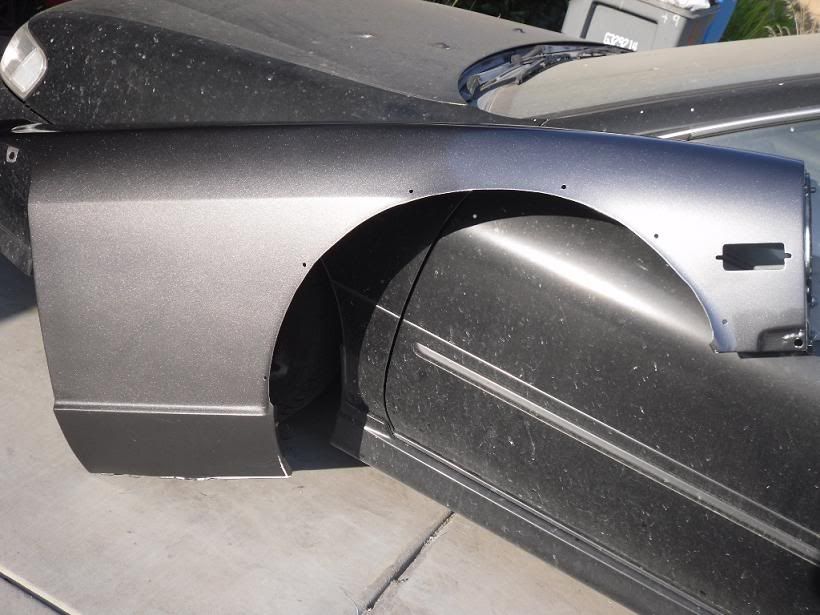

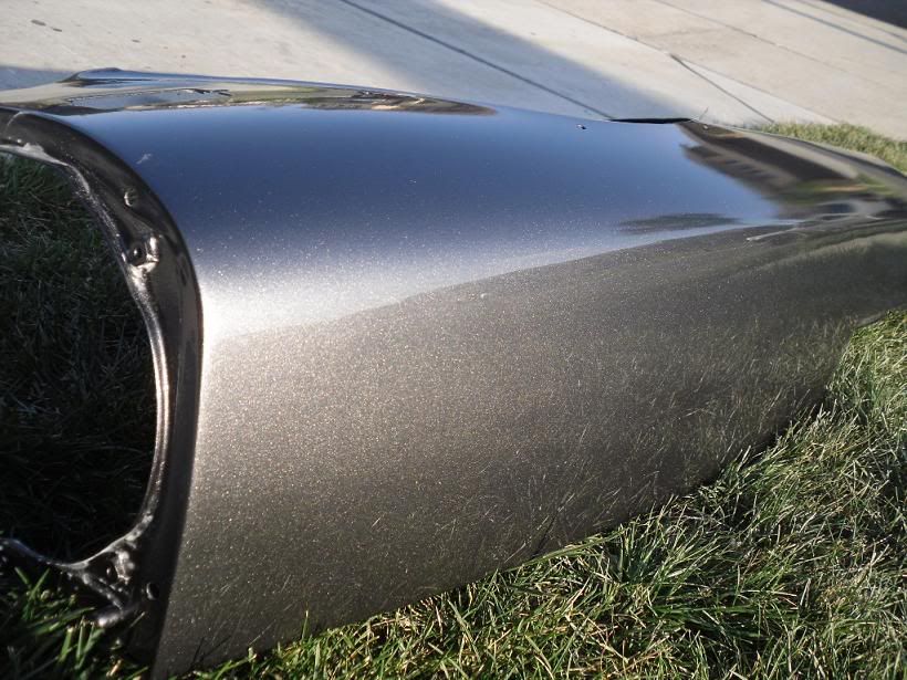

piston Posted August 7, 2009 Author Share Posted August 7, 2009 Ok diablo, you ask for it, you got it...This is by far my finest piece of spray job. heres a pic outside. i was able to get home early and took some quick shots. here you can see the orange peel thowing the glitter flakes all over from the sunlight. havent wetsand an buff the bottom section yet. couple more shots. notice the blurry reflection up top of pic on the piece i havent sand and buffed. Quote Link to comment Share on other sites More sharing options...
