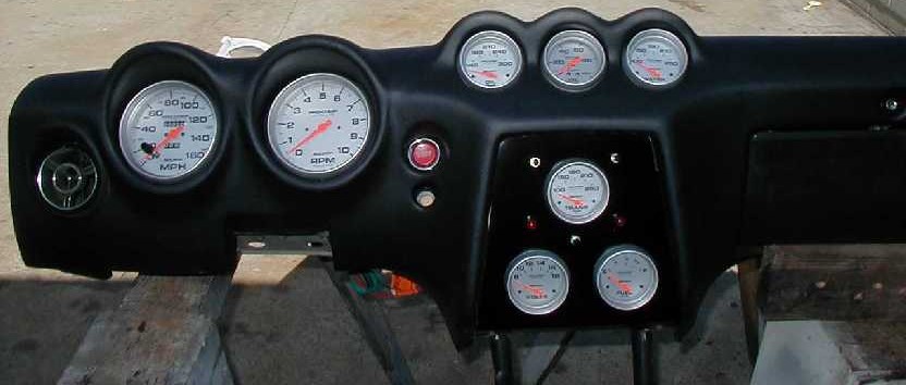

Tim240z Posted February 12, 2002 Author Share Posted February 12, 2002 Here's a couple of pics of the test fit of the gauges. I have not installed the full dash cap yet so NO RUDE Comments please! Tim Quote Link to comment Share on other sites More sharing options...

Tim240z Posted February 25, 2002 Author Share Posted February 25, 2002 Here are the rest of the gauges. I finally got around to making the center dash housing for the 3 extra gauges and the warning LEDs, and my S2000 starter button!! If they don't show here, just go to my site. THe pics of the dash are on the engine page (Don't ask ). Tim Quote Link to comment Share on other sites More sharing options...

Owen Posted February 26, 2002 Share Posted February 26, 2002 Umm, Tim...You didn't leave enough room for the boost gauge, EGT, and AF meter Owen Quote Link to comment Share on other sites More sharing options...
Kennysgreen280zt Posted February 26, 2002 Share Posted February 26, 2002 Those look nice. I would go with the radio/heater block off plate but I need those . It looks good though. laterz ~Kenny Quote Link to comment Share on other sites More sharing options...

slownrusty Posted September 6, 2004 Share Posted September 6, 2004 Beautiful...love those UltraLites...I have the same gauges on my ZXT! I especially like your center console housing the three gauges (volts, trans temp, etc) Yasin Quote Link to comment Share on other sites More sharing options...
DaleMX Posted September 6, 2004 Share Posted September 6, 2004 Nice job Tim! But if it were me, and it will be soon, I would put the oil pressure gauge into the top of the new homemade section and move the fuel gauge up top. That way you have all the same type of gauges together (bottom dial) and the single gauge at the top of the new section can have the center mounted dial. It just looks kinda weird to have a center dial and 2 bottom dials next to it. Dale Quote Link to comment Share on other sites More sharing options...
Tim240z Posted September 6, 2004 Author Share Posted September 6, 2004 Oil pressure is much more important that fuel level, thus oil pressure is put where it is more visible.... Quote Link to comment Share on other sites More sharing options...
