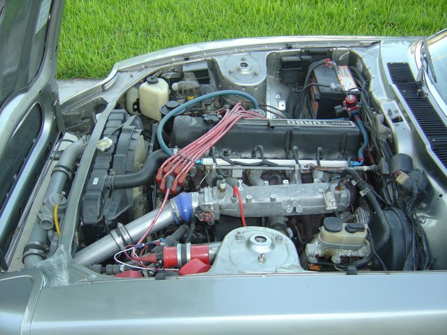

darkzebra Posted August 25, 2009 Share Posted August 25, 2009 My 82 280ZXT has a stock radiator. I replaced the stock fan with an electric flex-a-lite low profile one, but it has already lost a blade in each fan, causing heavy vibration. Instead of replacing the flex-a-lite fan blades I am thinking of installing a different electric fan. The fan must allow me to run 2.5" IC piping across. Since the Taurus 2-speed fan is 17" high it seems like there will not be enough clearance to run the IC tubing . Has anyone run IC tubing with the Ford Taurus 2-speed fan in place? If I can't use the Ford Taurus, any other fan recommendations? Quote Link to comment Share on other sites More sharing options...

darkzebra Posted August 31, 2009 Author Share Posted August 31, 2009 My IC (Isuzu) has inlet & outlet on opposite sides, requiring me to run tubing ACROSS the radiator, between the top of the fan and the top radiator hose. Can I run 2.5" tubing here if I install the Dodge Caravan fan? Would still like to know if the tubing can be run this way using a Ford Taurus fan, as I like the use of a 2-speed fan. Quote Link to comment Share on other sites More sharing options...

darkzebra Posted October 14, 2009 Author Share Posted October 14, 2009 Thanks everyone, for all the suggestions. Since it seems the dual speed Taurus will not allow me to run IC tubing as planned, I have decided to replace the blades on my flex-a-lite fan. I think I may have contributed to the blades breaking prematurely because I only bolted the fan shroud at the 4 corners, allowing too much flex in the center (also had to replace the radiator). I have now added 2 bolts in the center of the fan shroud, with spacers between the radiator and shroud. Quote Link to comment Share on other sites More sharing options...
