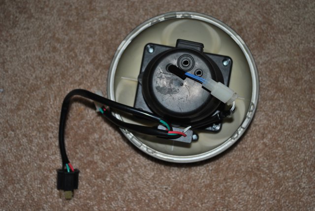

bens1088 Posted October 2, 2009 Share Posted October 2, 2009 Again these are "just" high quality HID's in a quality H4 housing. Don't get me wrong - I don't have anything against projectors - I love how they look. I just don't want people to think that a reflector is inferior to a projector. The problem with a projector is that they are difficult/expensive to get and for me the best performance for the $$ was the H4 lens. There are tons of different ones and if you get yours locally if it doesn't work for you then you can take it back and try a different style. I would stay away from the cheap plastic lens/plastic reflector as they are typically cheaply made and poorly designed. I like where you are going on your posted thread because its hard to find a good projector if there isn't anything available at the local wreaking yard can be difficult. Its also hard to replicate something that someone else has done. Personally I'm looking to build a custom headlight for a friend's 240Z with projectors and a custom headlight bucket but finding parts are challenging. Keep up the good work on this front - I'm watching to see what happens with this. Until someone like Bens1088 can provide the end user with a quality product its difficult to reproduce some of the HID setups. This setup is easily reproduced and you know what you are paying, what you are getting out of it and the benefits that comes along with switching to HID. I apologize for the criticism before. Your lights have a great cutoff. I still think projectors are the way to go to get the "newest" tech into our old cars. My projectors have a flap that drop down to show the brights. This is the best solution without buying bi-xenon HIDs (which = more $$). Let me know if you need some HQ projectors for your build. Good quality projectors are ridiculously overpriced. I will be also importing projectors by themselves. Check out my forum for pics. Usually when we hear the words H4 and HID in the same sentence, we automatically assume they are shi*ty ebay lights. Great job! Quote Link to comment Share on other sites More sharing options...
FricFrac Posted October 2, 2009 Author Share Posted October 2, 2009 I apologize for the criticism before. Your lights have a great cutoff. I still think projectors are the way to go to get the "newest" tech into our old cars. My projectors have a flap that drop down to show the brights. This is the best solution without buying bi-xenon HIDs (which = more $$). Let me know if you need some HQ projectors for your build. Good quality projectors are ridiculously overpriced. I will be also importing projectors by themselves. Check out my forum for pics. Usually when we hear the words H4 and HID in the same sentence, we automatically assume they are shi*ty ebay lights. Great job! No worries. I just have a basic knowledge of mechanics (which is quickly expanding thanks to this site) so I have little to offer the the forum in that regard. I've been doing electronics since I was eight so that stuff comes pretty easy to me. One of the local fellow Z guys said I should post on Hybrid about how to do the conversion so I though I'd do a little write up to help people without that experience get up and running. Even I had a pile of crap to wade through to get to where I came to a solution so I figured if I could build a bridge over that crap everyone else wouldn't have to wade through it Hopefully others will be able to add to this thread though if there is another kit, etc that works well as a combo, better pricing, group buys, etc. Personally I think the H4 set up suits a stock or mildly modified body but for a more modern look I like the projectors too. I agree with the bug eye comment. I would like to do a large and small projector for another car with a curved plexi lens similar to the lexan covers that go over the sugar scoops but more filled in from the base. That would make it look less bug eyed and more modern. The halo is fadish but I like the look. Can we use coloured LEDs in the halo? I've got some really cool colour changing ones and I'm working on some RGB as well. Quote Link to comment Share on other sites More sharing options...

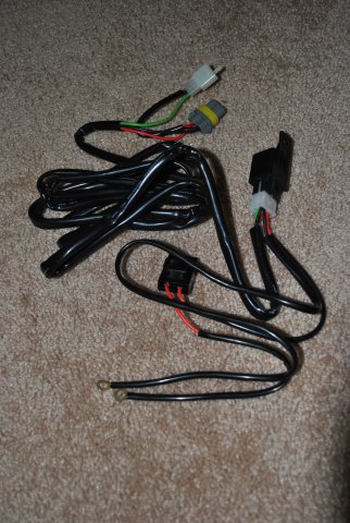

FricFrac Posted October 3, 2009 Author Share Posted October 3, 2009 Hmmm... Might be something to look into for this winter. Thanks for the info. I'm currentlyrunning H4 bulbs in the Autopal housings and (while better than stock) they are less than adequate... H4 halogen should be pretty good. Are you running a relay? HID are brighter but you should get decent performance from halogen if they are wired through a relay and proper connectors. If you don't have a relay and want to go with HID the kit I used comes with a relay for the system. Adding a relay if you don't have one then switching to the HID just means you bypass the relay and use the one with the HID wiring harness. Quote Link to comment Share on other sites More sharing options...

FricFrac Posted October 4, 2009 Author Share Posted October 4, 2009 I have been trying to say this in the past few hid threads... But well said. I guess I lack in the explaining part... On a side note... heres mine. Could possibly work? Is an autoloc housing with an integrated clear turn signal... If you are happy with the H4 beam pattern the HID kit should give you the same results. If not you'll need to get a new quality H4 lens. Keep us posted with your results if you try this method. Quote Link to comment Share on other sites More sharing options...

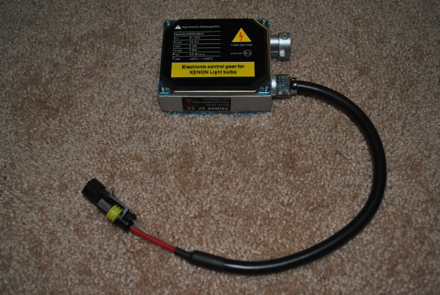

FricFrac Posted October 5, 2009 Author Share Posted October 5, 2009 Here is a picture of the HID ballast mounted in front of the radiator. I've hooked a leg of the star ground to the chasis ground and the wiring harness ground. Quote Link to comment Share on other sites More sharing options...

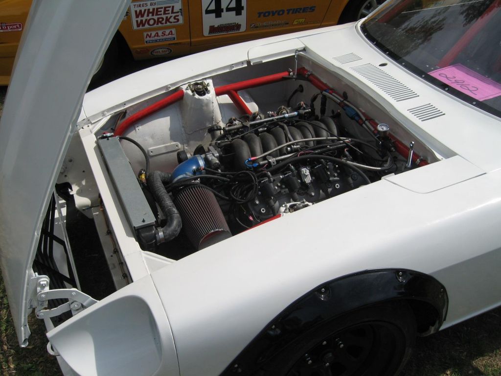

WizardBlack Posted October 7, 2009 Share Posted October 7, 2009 On a serious note, these look great! I am impressed. On a less serious note, all the HID lighting in the world isn't going to illuminate what the nose of a 750 whp S30 is pointed at. Quote Link to comment Share on other sites More sharing options...

jerryb Posted October 7, 2009 Share Posted October 7, 2009 One more ...I love being Canadian and being ripped off be the retail industry. Found this seller in BC.... http://www.604racing.com/index.php?cmd=products&sub=499483b242fd7&p= $409 Canadian! Arghhhhh! Looks like the ballast is available as a replacement part. http://www.604racing.com/index.php?cmd=products&sub=49949f67f3566&p= FricFrac.....is this in fact the same unit you installed? Thanx again for bringing this to our attention. Quote Link to comment Share on other sites More sharing options...
FricFrac Posted October 7, 2009 Author Share Posted October 7, 2009 One more ...I love being Canadian and being ripped off be the retail industry. Found this seller in BC.... http://www.604racing.com/index.php?cmd=products&sub=499483b242fd7&p= $409 Canadian! Arghhhhh! Looks like the ballast is available as a replacement part. http://www.604racing.com/index.php?cmd=products&sub=49949f67f3566&p= FricFrac.....is this in fact the same unit you installed? Thanx again for bringing this to our attention. Yes that is the H4 version I got. Our local Lordco auto parts shop has them for $330 (or less if you have some sort of discount) so pretty much anyone can walk in and get them for $330 CND here in BC (lower mainland, Victoria, etc, etc). If you can't find them locally you might want to contact them and have it mailed out to you... Quote Link to comment Share on other sites More sharing options...
