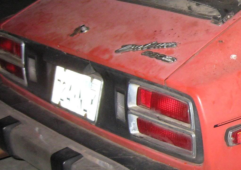

You guys might not have been able to tell, but the rear tail light surrounds looked like ass when I got the car. The chrome plate around the lenses was peeling off like crazy, and the black covers were very ugly, in consistent color and the corner was chipped off on the drivers side. You can kind of see it here:
Notice the missing corner on the drivers side
Anyways, I pulled them off, sanded off all the chrome plate and used a metallic kind of paint I had laying around. Looks even better in person.
Rather than trying to find (and pay for) a replacement for the drivers side tail light surround, I decided to repair the crack and rebuild the missing corner using a special plastic type body filler. It cures only in sun light and has to be built up a 1/8 inch at a time. Then I sanded it down and refilled imperfections as needed. Took a while and it's not perfect, but I think it's pretty close:

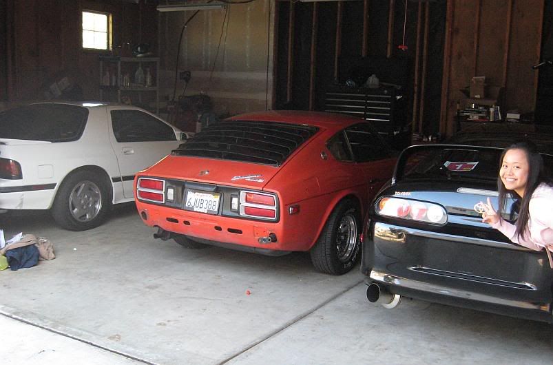

The garage, and the best wife ever: WIN.jpg
FC is gone now BTW :(

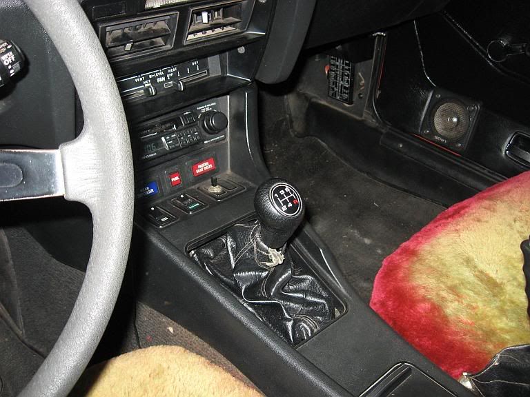

I made a custom short shifter using a stock FC shift knob.
Yes I know it's probably not period correct blah blah, but I had it laying around and the shifter was way too tall and full of slop. Just ignore the fictitious shift pattern (lol)
So I cut the stock shifter and made my own shifter bushings to tighten it up. Now the shifts feel great and the shifter action is tight with no looseness or rattling.
:D
The "custom" bushing was made from a poly bushing from something I had laying around.

Do you have any pics you took while you were making it or instructions cause mine is REALLY sloppy and I wanna fix it.
Probably better off just ordering new bushings
What I used basically was a poly tube cut to fit between the "ears"
The tube fit perfectly inside the shifter end (just a tiny bit of play so it can easily move)
Proper sized washers on each end of the tube
10mm bolt holding it all in place, used a lock washer and blue loctite to make sure it never comes loose on it's own.
I hope that makes sense
there are many threads about fixing the slop you can get brass door bushings from autozone (HELP brand) etc. I dont remember the part # but they were chrysler door bushings. Lasts alot longer than the oem ones

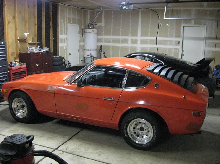

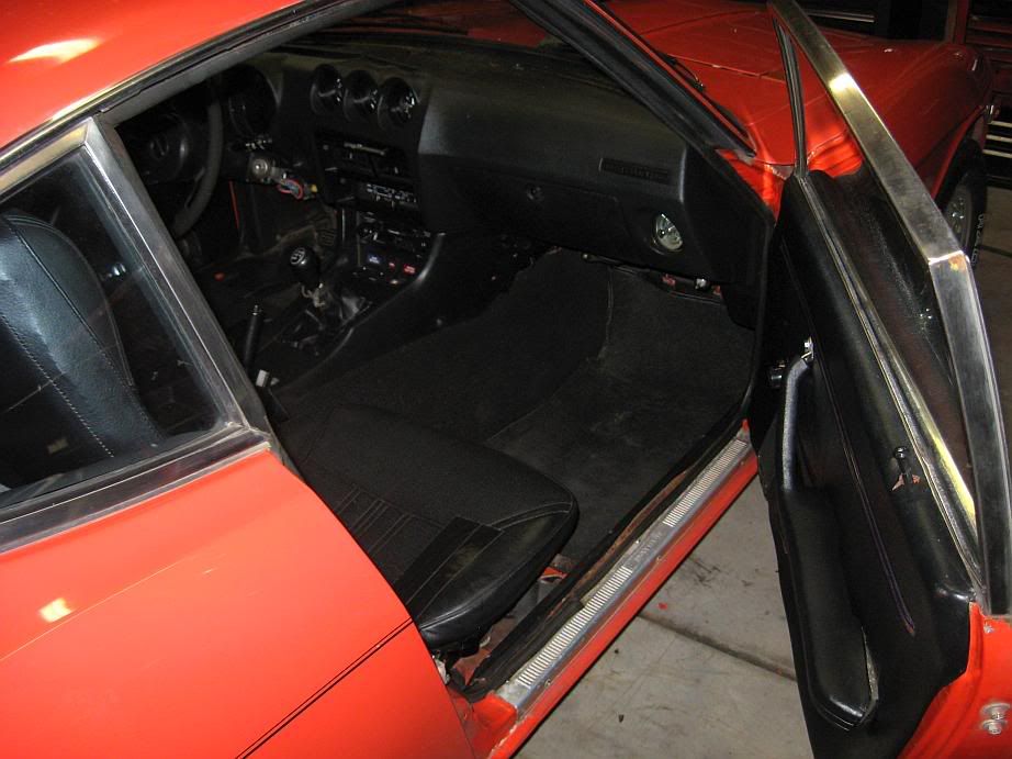

Cleaned up the interior some more and lost the seat covers.... passenger seat only had one rip, drivers is pretty bad. Covered it with some black gaffers tape for now.

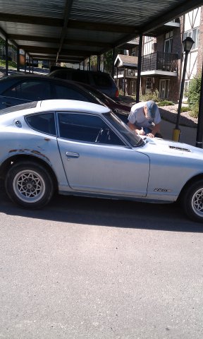

Here she is in the garage, I kinda wish it was a little lower but at the same time I think it looks about "right". You will also notice I sanded down all the surface rust on the body and hit it with some primer - just to stop the rust for now.
