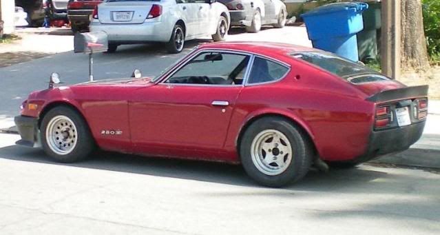

dhp123166 Posted November 22, 2009 Share Posted November 22, 2009 is chopping them a a no-no? Be careful if you chop because the stuff that is in those tubes caught on fire when I chopped mine. I chopped 'cause I didn't know any better but then it worked out for the best because I used the remaining bolted in part as a base for my homemade rear pan bar system. Quote Link to comment Share on other sites More sharing options...
dhp123166 Posted November 22, 2009 Share Posted November 22, 2009 I bolted on a plate of steel on my rear pan for safety and also to circumvent the law in CA. which requires bumpers but is none too specific about what constitutes a bumper. I've never had a legal issue with it and I've also backed into a pole with minimal damage and been rear ended at low speed also with minimal damage. Quote Link to comment Share on other sites More sharing options...
280znoob Posted November 22, 2009 Author Share Posted November 22, 2009 dang 120 pounds? maybe ill take them out and put sand bags in the back for at least SOME traction (snow soon) Quote Link to comment Share on other sites More sharing options...
cockerstar Posted November 22, 2009 Share Posted November 22, 2009 dhp123166, I really like your rear "bumper". It looks like it suits you car well the the flat black and the exposed screws/rivits on the muffler. Very down to business Quote Link to comment Share on other sites More sharing options...
