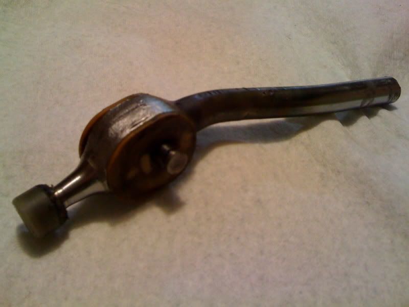

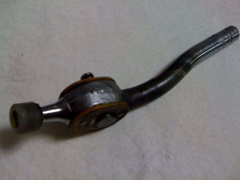

Would anyone be able to tell me what year / model trans this shifter came out of? I just bought a '72 240z and it has a 5 speed with a cut down shifter.
The PO tried to JB Weld a shift knob on the shifter, but it did not hold, so I'm trying to source another, cut it to length and re-weld the threaded portion back onto the shaft. Problem is that I have *no* idea what kind of shifter I have.
As you can see, it has an oblong plastic bushing (that is spring loaded inside the pivot housing) for the pivot pin and a plastic bushing on the ball end of the shifter.
Any help?

Interesting, and not a clue. But my experience with shifters for the OEM 4 speed, the early and late 5 speeds was that there were different lengths and bends to not only the shifter handle part, but the length of the pivot is also different and there were several variations so you need the exact handle or it won't shift into some of the gears. I wound up using the 5 speed shifter cut off right above the pivot and welding my 4 speed handle to it and what I would recommend that you do. My first attempt at 5 speed shifters was to heat and bend a ZX shifter, but it made the handle so short that the ball was just barely above the console!
Those came on later model ZX's, if I remember correctly. I've used them before on my trans.
They have two tiny springs inside, to dampin the feel (I guess that was the reason) which allows the handle to slightly move up and down.
I know the 83 5 spd I had, came with taller ears for the shifter pin to fit thru, and it's possible the pin height may have been slightly raised to allow for this shifter handle, since it is oblonged, and taller (in my opinion).
I hope I didn't add to the confusion with my post, but this is how I remember my experience dealing with that shifter handle... :)
that shifter is from an 81-83 zx na 5 speed. if i understand correctly your goal is to cut the top off another z shift lever and weld it to what you have? if so, you can get a shift lever from any z,72-83 to use for your cut and splice/weld, as well as the straight 6 maxima sedan. thread pitch is 8x1.25mm. my suggestion would be to cut your [pictured] shift lever just above the bulbous part and weld the donor to that spot, thus keeping your weld hidden below the shift boot. if you weren't concerned with originality you could simply source a donor shift lever and knob from another nissan 5spd with same shift pattern-like a 300zx, local jy perfect for this

I have that exact shift lever in my 5 speed swapped 240z.
I can't figure out what model and year it came from exactly, but according to the transmission case styling it should be from a 1979 280ZX which would also match the L28 that was swapped in at the same time so it would make sense they are from the same car.
But of course that's just a guess as I have no idea where the previous owner got the transmission from. The N47/N42 L28 is definately from the 1979 area though.
Perhaps it's why MSA doesn't offer a short shifter kit for the 1979-1983 model year cars... of course the few years of cars that used that type of transmission as well as only a forced induction or high rear end geared cars would enjoy using the tall geared transmissions was also most likely a factor as well...
I have yet to see any bushings for sale for that type of shifter, really annoying as it flops around ALOT as the spring allows a little play already.
It also has really tall gears, it's way to tall for street driving with only a stock L28 and stock 240Z 3.2??? rearend. Going to a 76-77 model year transmission if I can find one local to me....
