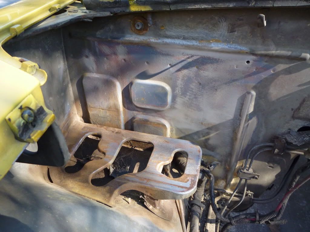

Tanuki Posted February 10, 2010 Author Share Posted February 10, 2010 ok well I just man'd up and started cutting. I was a little apprehensive, but I think it cut out just fine. Also it doesn't have to be perfect as the actual line is formed by the fender flare not the grinder cut. I just used a wheel cutter? I call it a grinding wheel. Anyways, I mounted the wing, cut the front two fenders, and am taking a break while the etching primer dries before I rivet on the flares. Also I took the wire brush to the corrosion in the battery area. Everything came right off. Before: After: Quote Link to comment Share on other sites More sharing options...

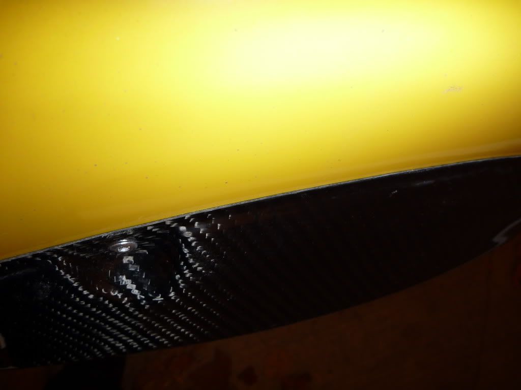

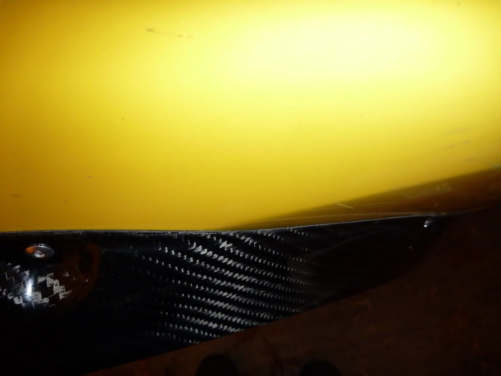

Tanuki Posted February 10, 2010 Author Share Posted February 10, 2010 ^I am just using aluminum rivets on the fender flares. they seem to fit flush, though the rivets are extremely easy to remove if I need to redo anything. The rear spoiler just has two bolt points. I just put a piece of tape on the bottom of the spoiler with a dot colored in on top of the mounting hole. Then I placed the wing on the car so that the tape would stick to the car and show me exactly where to drill I then measured it to make sure it was true before cutting. Worked like a charm, but I have noticed these wings seem to have a good amount of gap on the edges (probably for opening and closing the hatch). I think that pieces like that wing should have a thin gasket due to the movement of that hatch etc. Quote Link to comment Share on other sites More sharing options...
synthtk Posted February 10, 2010 Share Posted February 10, 2010 My MSA BRE Style CF spoiler has the same sort of gap... and the clearcoat has started to crack/yellow :-/ Not sure what kind of "care" the CF parts need but probably a good idea to start keeping it covered up when you can. Quote Link to comment Share on other sites More sharing options...

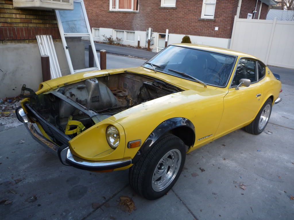

Tanuki Posted February 11, 2010 Author Share Posted February 11, 2010 ^THANKS I still dont have the motor along as far as yours! you going to be done by april? Thought I would show actual fitment with the rivets done up: Quote Link to comment Share on other sites More sharing options...
