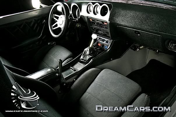

Kevin.pk Posted February 7, 2010 Share Posted February 7, 2010 I used an aftermarket B&M shifter mounted to a piece of metal welded to the stock datsun rubber shift boot ring. My trans is a 700r4. Also, check out this photobucket album of another member's car for a more stock appearing look. http://s672.photobucket.com/albums/vv85/lazycat5/ Quote Link to comment Share on other sites More sharing options...

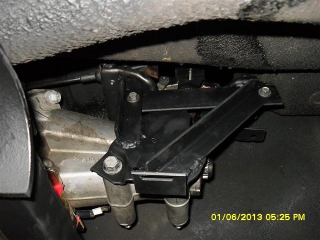

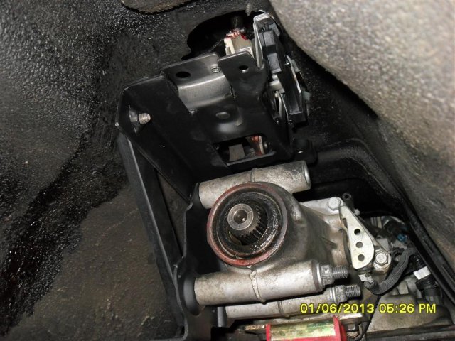

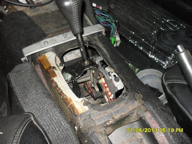

ktm Posted December 23, 2012 Share Posted December 23, 2012 (edited) I installed a B&M Stealth Pro ratchet shifter on my LS1/4L60E setup. I have a 1972 240z and needed to trim the shifter opening slightly in the front and back. I created a cradle that bolted to the underside of the transmission tunnel below the shifter hole. The cradle holds the Stealth Pro so that the shifter arm is in the stock position and does not stand up very high. Edited December 23, 2012 by ktm Quote Link to comment Share on other sites More sharing options...

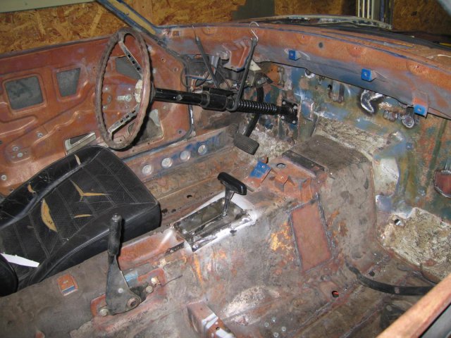

Zinpieces Posted December 28, 2012 Share Posted December 28, 2012 I am using a factory cable shifter with a new detent plate for 4 forward gears that came from a '69 firebird. It controls a 2004R This picture does not show how I mounted it only the new floor plate, but it was a simple install. I like the short throw and the factory lockout. It is OK for now if I decide to make a nicer handle it won't be a problem Quote Link to comment Share on other sites More sharing options...
ktm Posted December 29, 2012 Share Posted December 29, 2012 Sounds like a few of us created a cradle that we attached to the underside of transmission tunnel. Quote Link to comment Share on other sites More sharing options...
