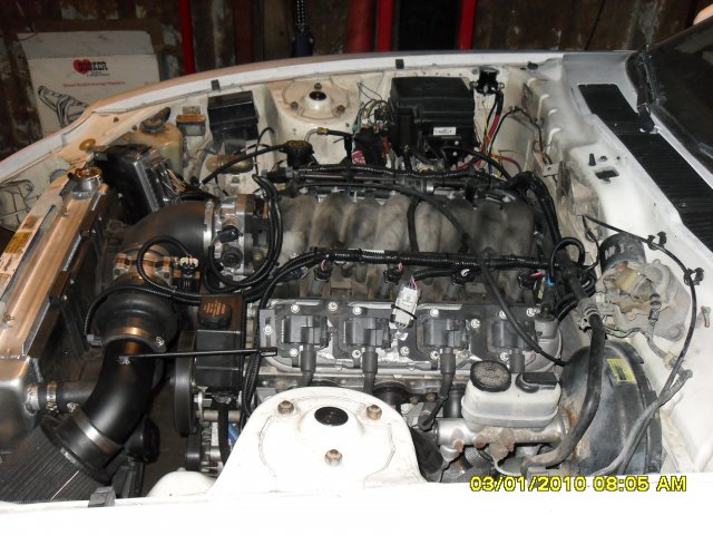

Domzs Posted May 5, 2010 Share Posted May 5, 2010 (edited) here my 83 with ls1 and 6 spd. kinda new at this , still figure out how to insert pictures Edited May 5, 2010 by Domzs Quote Link to comment Share on other sites More sharing options...

superior78-z Posted May 9, 2010 Share Posted May 9, 2010 brings tears to my eyes! to finally see a zx with a ls1 in it's rightful place. man if its no trouble please tell all zx owners how you got it in there. Don't leave out any details, because i want to begin my swap now!!!! Quote Link to comment Share on other sites More sharing options...
Domzs Posted May 9, 2010 Author Share Posted May 9, 2010 brings tears to my eyes! to finally see a zx with a ls1 in it's rightful place. man if its no trouble please tell all zx owners how you got it in there. Don't leave out any details, because i want to begin my swap now!!!! engine and trans. , 6 spd. , fit perfectly . the major the problem is the steering shaft . i ve decided to use camaro shorty on the driverside with mod. on the collector , dont want to have custom headers . as you know they dont last a long time . used most parts from local stores , easier to get replacement later . i cut the steering shaft and added another joint and support bearing . fits very tight but no binding . i ll check out the 2010 camaro ss shorty later , it might fit better . if you have any questions about the swap , you can email me . i ve done a lot of research on my project , try to save money and keep her as stock as possible . Quote Link to comment Share on other sites More sharing options...

VinhZXT Posted June 2, 2010 Share Posted June 2, 2010 i m not done with my z collection yet . need to get 280z and another zx as soon as i get all my cars done . Dom, did you have to cut the front of the oil pan? If you don't your motor should be sitting against the fire wall. I hope to get back into my ZX swap very soon. Quote Link to comment Share on other sites More sharing options...
Domzs Posted June 3, 2010 Author Share Posted June 3, 2010 Dom, did you have to cut the front of the oil pan? If you don't your motor should be sitting against the fire wall. I hope to get back into my ZX swap very soon. yes i did and extended the pickup tube . after i did it , i realized i did really have to cut it all the way . i should have knotched the corners to clear the rack , this way the pickup stays the same . good luck with your project . i ll be glad to help if i can . Quote Link to comment Share on other sites More sharing options...

kirk280zxv8 Posted October 4, 2010 Share Posted October 4, 2010 Do you have any pictures of oil pan modification? I had a sbc in my 83 zx and pulled it out sat. Now for the ls1 engine i am using the JTR kit with the small block older chevy to ls1 conversion mounts off of ebay the adjustable ones for 99.00 it lets you put and ls1 in an older gm. I hope it works. i have all kinds of stock manifolds for ls1 but i saw som block huggers from jegs. They look similar to the jtr sanderson headers they meet in the middle and go strait down. Any pointers on pan would be great. thanks Kirk Eilertsen Quote Link to comment Share on other sites More sharing options...
Domzs Posted October 6, 2010 Author Share Posted October 6, 2010 (edited) here the photo of the oil pan . if you are going to position motor the way i did it , you don't have to cut it all the way , just knotch it at the corners enough to clear the rack . this way you don't have to mod. the oil pick up tube . here is the latest addition , sting ray hood scoop , unfinished . you can get 1 block hugger header for the pass. side and as for driver side , you can try a 2010 camaro shorty . i used the 2000 camaro , but had to mod. the steering shaft , very very close to the header , more than i would like . i'll try 2010 header later . Do you have any pictures of oil pan modification? I had a sbc in my 83 zx and pulled it out sat. Now for the ls1 engine i am using the JTR kit with the small block older chevy to ls1 conversion mounts off of ebay the adjustable ones for 99.00 it lets you put and ls1 in an older gm. I hope it works. i have all kinds of stock manifolds for ls1 but i saw som block huggers from jegs. They look similar to the jtr sanderson headers they meet in the middle and go strait down. Any pointers on pan would be great. thanks Kirk Eilertsen Edited October 6, 2010 by Domzs Quote Link to comment Share on other sites More sharing options...
camarojokester Posted October 27, 2010 Share Posted October 27, 2010 I just cut the front two corners of the pan off. It was 2 by 2 by 2. It cleared the rack perfectly. Then I took the baffle that was in the pan, and cut it enough to fit in the pan. No problems so far. Quote Link to comment Share on other sites More sharing options...
