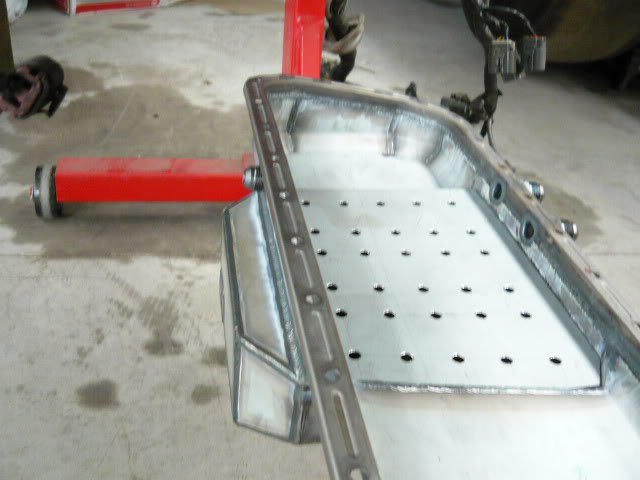

i bet its something to do with the external pickup sucking air or something of the sort.. was the crank cleaned and grub screwed?
This is my external p/u pan, and it hasn't failed me yet. I guess there could be a way this could cause a issue, if not sealed properly, but I have confidence Lee made sure of no leaks/ suckin air...

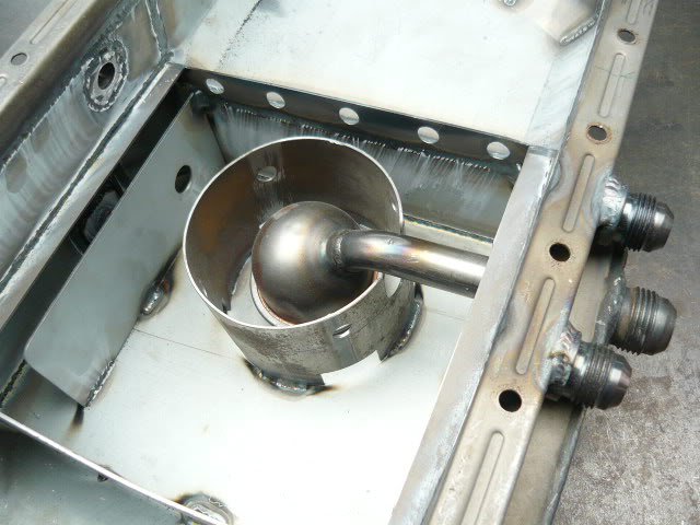

Yes im sure no air leaks. All tight 12an hose with 2 connections, each clean and tight and dabb of epoxy on the outside for vibration resistance just like we do on airplane fittings. I think im going to go internal pickup though. Maybe dry sump but i want to keep my damn ac... the one that mounts under the alternator willnt fit in the s30 :(
