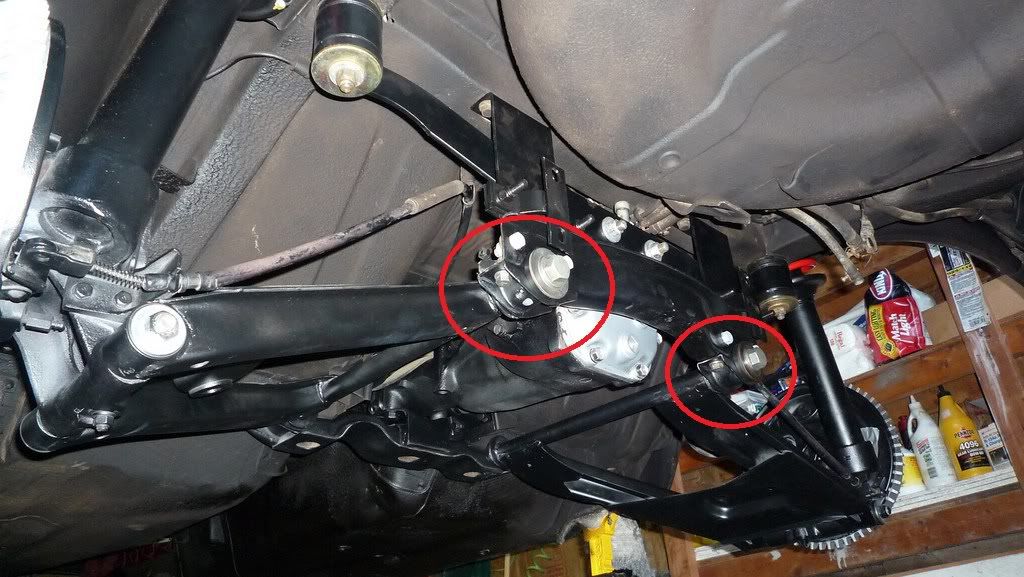

I use a similar process to Meph. I use a piece of 4x4 wood and my floor jack, either on the rear diff or at the jack points on the frame rails. I place the jack stands in the red circled areas.
Whatever you do don't use a scissor jack(the kinda that comes with cars) and always use jack stands. I don't know how many times floor jacks have failed to hold the car.

Wow. Thanks a ton! These answers and pic were perfect! I will get wood and try it out
