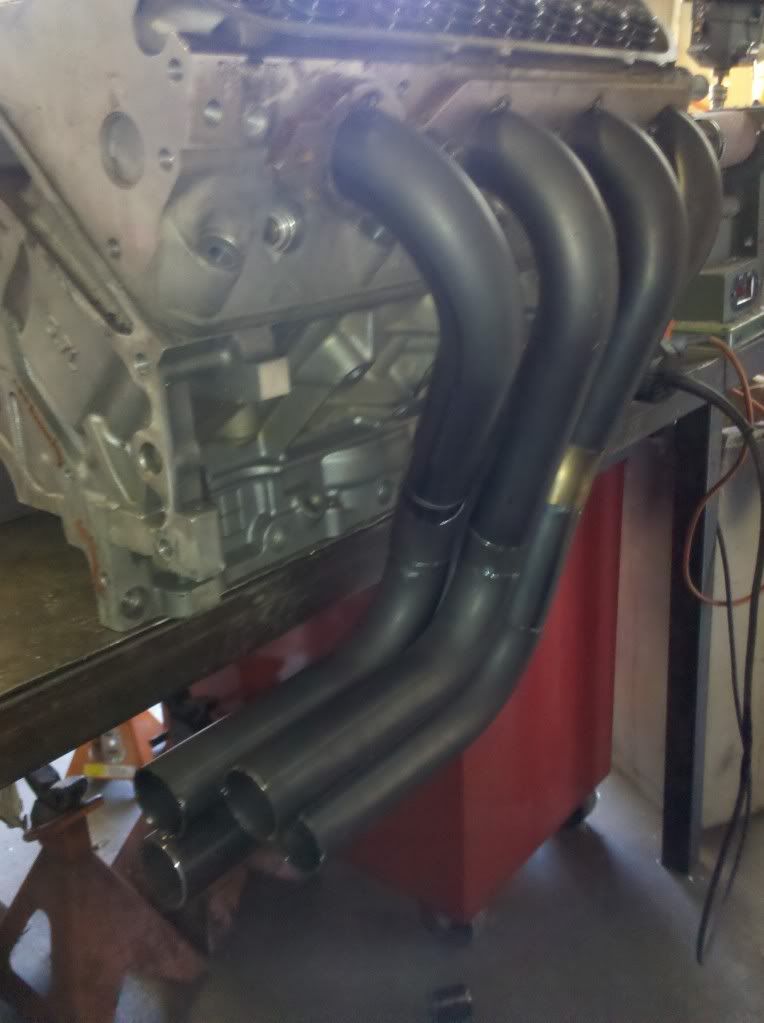

1 tuff z Posted May 18, 2011 Author Share Posted May 18, 2011 boy from oz, wOw, your system looks great from underneath-any pics of the rest of the exhaust to share?! i received some pics today of the right side proto as well. his process was draw both sides, build one, build the other, test fit and so on. he's already begun to make mods to the left proto as per feedback that has been posted in this thread and commented that we have presented a formidable challenge for him [me thinks he is enjoying this!]. Quote Link to comment Share on other sites More sharing options...

1 tuff z Posted May 22, 2011 Author Share Posted May 22, 2011 day after comments were posted about left/driver side he began cutting the proto to incorporate our feedback [ground clearance, proximity to steering coupler/brake lines, equal length tubes, etc]. Quote Link to comment Share on other sites More sharing options...
zed240au Posted May 23, 2011 Share Posted May 23, 2011 your extractors are look great been long time coming to see this happen in a group buy but sure you will all love results when you get them fitted I was very frustrated burning plug leads with my JTR lhd header so finally bit bullet and built my own long tubes to suit rhd car just a suggestion and not sure if it is possible with your lhd cars have pic below of how i made my lhd side trying get as close as possible to equal length tube does mean i have to remove oil pressure sender to fit to car but other wise it slides in from bottom fine also picture of rhd side showing gap for steering made in 3/4 tube Quote Link to comment Share on other sites More sharing options...

1 tuff z Posted May 26, 2011 Author Share Posted May 26, 2011 finally reached the builder today after trying for 2 days. they are close proximity to joplin-while they did not experience any damage their phone service has been out then spotty for a few days. update-right side proto nearly complete. you will need to pull the header to change the starter but he feels [based on similar lt's for the vettes] that heat will be any concern. left side, cut apart awaiting new bends to build again. no way to route any tubes outboard of the steering rod due to the size and location of the johns cars mount-it takes much room. he's hoping about a week to get that side figured out. i did send to him all the images from both of our down under friends custom lt's for reference and ideas-thanks again for posting them 'boy from oz' and 'zed240au'!! important-asked me today-"dave, anyone running auto trans?" told him very few and asked why. replied that these headers will NOT work if you are running an auto. if you are, no problem or hard feelings if you need to back out-we did not realize this when the thread began. this is what i know at this point. as always, thanks for your patience, i'm in line with you! Quote Link to comment Share on other sites More sharing options...

1 tuff z Posted June 6, 2011 Author Share Posted June 6, 2011 spoke with our builder early saturday afternoon and wanted to post. it's been a week since my last update-i'm jonesing as much as the rest, if not more for pics and such. right side design is pretty much there. had what he thought was a great proto then tried to remove it and it would not comeout without removing something or moving the engine-aargh! cut it apart now for the 3rd time. left side he said is 'kicking my tail' to incorporate our design requirements but also said he is confident will be completed soon. we are definitely behind schedule-which bums me as i had hoped to have them on the z and driving already-no such luck. Quote Link to comment Share on other sites More sharing options...
