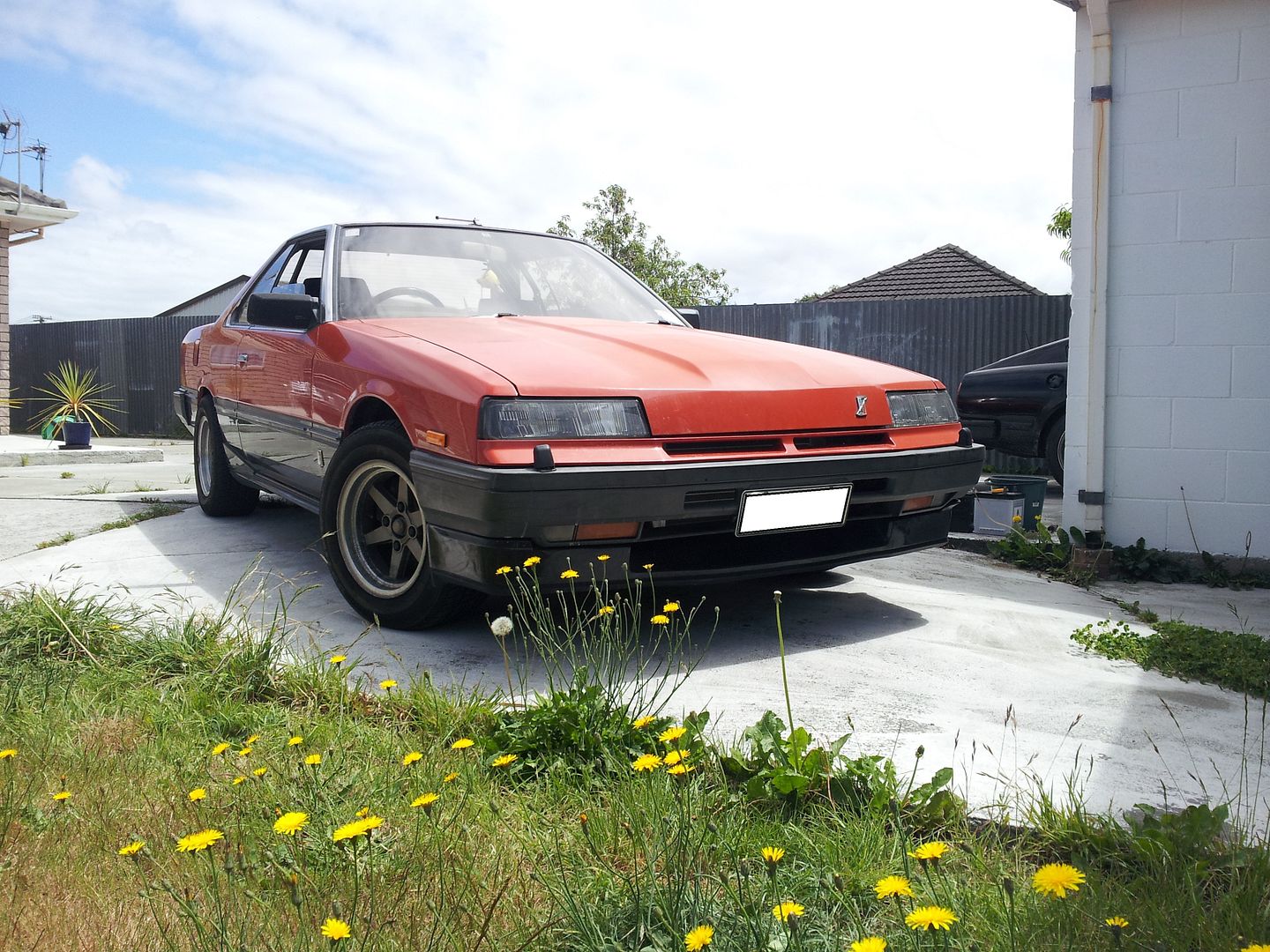

djz Posted December 22, 2012 Author Share Posted December 22, 2012 (edited) It's been a while since I updated this, been through a fair bit since then! Sold the Stagea and bought another car some of you guys might appreciate: Got the Z legal and drove is around for about 6 months till this happened: 2870Km old N1 pump, it probably broke due to a couple of reasons but I won't recommend that anybody uses an N1 pump with standard gears. I had the 63,000K ex Z31 NICS RB20DET that I bought for the sump and mounts sitting around since I removed it from my old R30 so I thought I'd put it to use. I'll get it tuned in January hopefully and drive it like this for 6 months or so, it's running the factory FJ20 turbo from the DR30 and 444cc GTR injectors but is using everything else from the 26, intercooler, oil cooler, sump, gearbox, Link computer etc. It should be good for maybe 250rwhp if the turbo can keep up? In the mean time I also bought another almost complete RB26 that had run a bearing, number 6 big end which looks like it was probably caused by the screws coming loose in the factory oil pump. I bought it for half of what I paid for the original 26 and it's actually in better condition, no detonation damage to the head and other than the one big end journal the crank is mint, it also came with a set of 550cc RX7 injectors. I also bought a complete "series 2" RB30 for $200NZ, sold the head, auto trans and a driveshaft that came with it. The plan at the moment is to fix and sell the original RB26 and use the head off the new one combined with a built RB30 block, should get the GT40 spooling a bit faster. Edited December 22, 2012 by djz Quote Link to comment Share on other sites More sharing options...
rayaapp2 Posted December 23, 2012 Share Posted December 23, 2012 (edited) Got the Z legal and drove is around for about 6 months till this happened: 2870Km old N1 pump, it probably broke due to a couple of reasons but I won't recommend that anybody uses an N1 pump with standard gears. That looks like you ran the N1 oil pump on a standard crank. Ive seen that happen so many times because someone used the N1 pump with a stock crank. The N1 crank has a collar that extends much further than the std crank which is why the JUN and other companies crank collars are available. Once you have more than 2 square mm driving the oil pump the pumps center gear is loaded properly and the failure rate drops drastically. Didnt one of your first post mention you had the JUN collar? Correct me if Im wrong. Ive got an N1 pump sitting in the box new and a JUN collar ready to go in my next project. A local board member and I tested this theory out on an RB25 here setup with a 2 step launch that's really hard on the oil pump. The collar and the N1 pump held up long term while drag racing at the strip. Weird that yours didnt Glad to see your back up and running. Edited December 23, 2012 by rayaapp2 Quote Link to comment Share on other sites More sharing options...
djz Posted December 23, 2012 Author Share Posted December 23, 2012 That looks like you ran the N1 oil pump on a standard crank. Ive seen that happen so many times because someone used the N1 pump with a stock crank. The N1 crank has a collar that extends much further than the std crank which is why the JUN and other companies crank collars are available. Once you have more than 2 square mm driving the oil pump the pumps center gear is loaded properly and the failure rate drops drastically. Didnt one of your first post mention you had the JUN collar? Correct me if Im wrong. Ive got an N1 pump sitting in the box new and a JUN collar ready to go in my next project. A local board member and I tested this theory out on an RB25 here setup with a 2 step launch that's really hard on the oil pump. The collar and the N1 pump held up long term while drag racing at the strip. Weird that yours didnt Glad to see your back up and running. It was on an R32 crank with a Jun collar. I was at the track, just touched on the limiter (just over 8000rpm) and the oil light came on. One of the contributing factors is probably a loose crank pulley which wasn't done up by me but I should have checked it as I knew the shop that did it up didn't have a torque wrench big enough, it wasn't completely loose but I undid the bolt with a ratchet, which isn't exactly the 400+Nm it's supposed to be done up to. But as I said, I won't use another N1 pump with standard gears. Quote Link to comment Share on other sites More sharing options...
