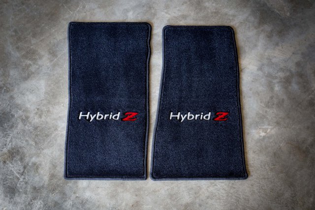

alainburon 3 Posted September 27, 2019 Author Share Posted September 27, 2019 Finally took my car back to the body shop to get it repainted. I just got home from vacation and was surprised to see that my custom floor mats had arrived. Quote Link to post Share on other sites
trackzpeed 9 Posted September 28, 2019 Share Posted September 28, 2019 Sweet. Can’t wait to see the finished product. Quote Link to post Share on other sites
