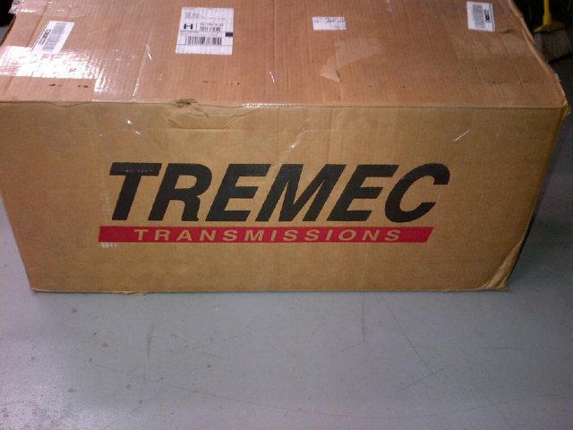

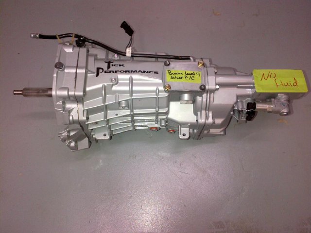

Today felt like Christmas, I got home and there it was….. My transmission came in.

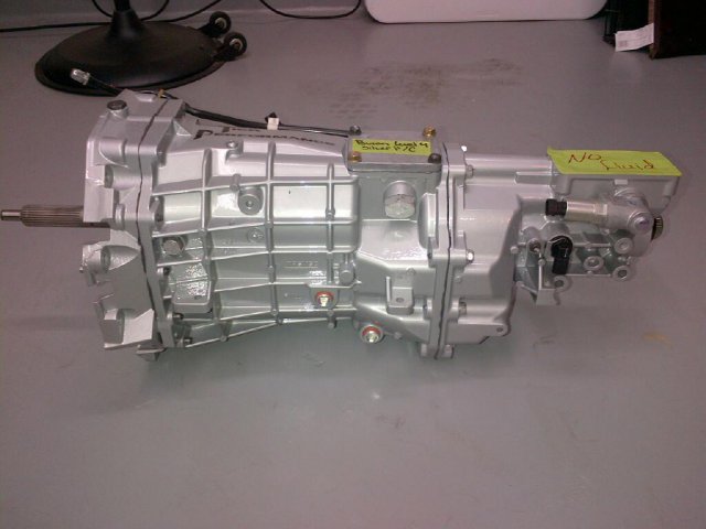

I ordered the Level 4 Magnum TR-6060 from Tick Performance. They basically take a new Tremec TR-6060 and modify it to fit and F-Body Camaro, while they are at it they make a few upgrades that takes this transmission from handling 700RWTQ to 900RWTQ (like I would ever need that but what the hell).

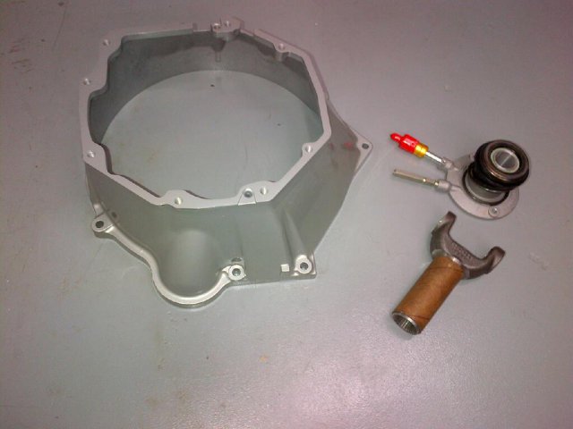

I also had them powder coat that case and bell housing to match my drive shaft, axles and R200. For a small fee they also threw in a new GM Slave Cylinder & Throwout bearing. This transmission looks incredible, the pictures do not do it justice. I just hope it performs as good as it looks.
If I had it to do over again, I would definitely go this route. I have almost 2K in my tranny, and its only good to about 650 (thats parts alone. did the labor myselft). Plus, the 6060 has triple cone synchros.....
Jealous.
Thanks, to be honest the deciding factor for me was that I don't have a core from a donor car and when I started looking into the price of a good core it was between $1500 to $2000 plus another $2000 or more to have it rebuilt the way I wanted it. I just figured why not spend another $1000 and be done with it. Like you say it has triple cone synchros and Tick upgraded the fork pads to bronze from plastic as well as adding carbon blocker rings to 1st, 3rd and 4th gear since 2nd comes with it from Tremec.

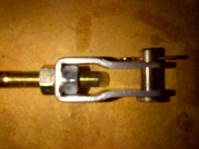

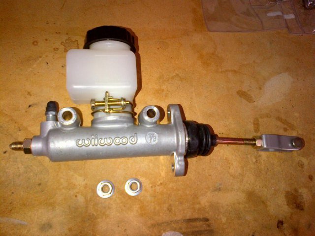

Not a lot of progress to report but something is better than nothing. I received my Wilwood 7/8†Clutch Master cylinder. I sent the bracket that screws onto it and fastens to the clutch pedal to the machine shop to have the threads drilled and a standard nut welded in place since the threads were metric on the bracket and the MC rod has standard threads.

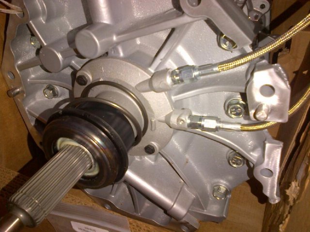

I also received the hydraulic lines for the salve cylinder and went ahead and installed them on the transmission.
I have seen some using the OE slave cylinder and they say it works fine. I just wanted to upgrade mine. The plan for this car is no bolt goes unturned and no component goes unreplaced.
I was talking about the fact. Nissan clutch master cylinder that came with the car . I bought an adapter and a hyd. line from Speedway and using Nissan clutch master on my 83 ZXT LS1/t56 conversion . I was trying to keep the cost down . Most of my parts for both of my conversions came from local stores . Two project cars are costing me a lot . LOL . Soon ( like 3 more yrs ) , i'll do the same to my 91 300ZX . I have to wait until it's emmision exempt . LOL
