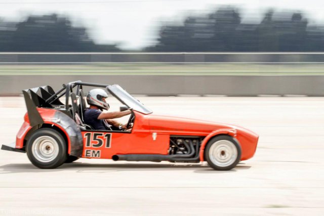

I have a friend who owns the company that makes the Brunton Stalkers.  The Brunton M-Spec cars come with LS Engines and have side pipe exhaust.  The sound of his cars is very nice, and well below the SCCA dB limit. He uses  catalytic converters in line with the mufflers to keep the exhaust quiet.  If you give him a call (Scott Minehart), he can tell you which mufflers and cats he uses.
http://stalkercars.com/
Here is his car on track.

Emailed Scott, didn't want to call and take up his time since I wouldn't likely be buying anything from him. Looking online it appears that they use the Flomaster Hushpower which is too large a diameter to fit under the door of a Z.
I'm really torn on this one. I think the Spiral flow will help, but probably won't do it all on its own. I think any number of exhaust tip inserts would also help. Classic chambered mufflers would definitely work but they use pretty restrictive louvered cores. I know Super trapps would work, but I hate the idea behind them. I guess I have 6 months or so to figure it out. Going to go hit up some Cobra forums and see what they're doing.
