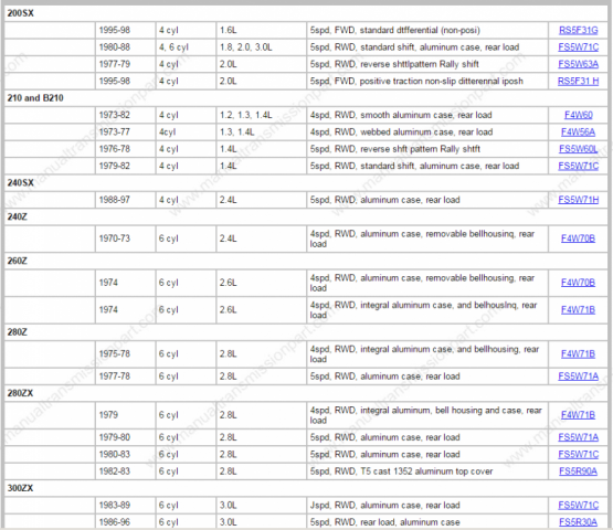

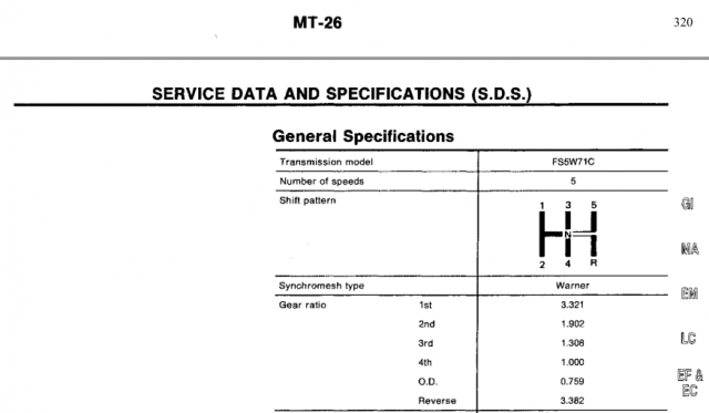

I've never seen a good explanation of what the B or C means.  Most call the later transmission the 71C because that's what Nissan calls it in the 300ZX Service Manual, when the VG30 was introduced.  But there are many other letters used.  Even the early 71C's had the same synchros and gear widths as the 71B's, so once you swapped bells you had essentially a 71B with a different shifter and set of gear ratios..  But, the countershaft bearing size was larger fro the 300ZX 71C, so that's one definite difference.  The later US market 240Sx 5 speeds with the extra synchros and wider gears were actually either a 71H or 71J (can't remember which), not 71C..
So, in your case, you might still have a smaller countershaft bearing, and an unususal set of gear ratios, and either the same number of synchros or more.  I would find a Service Manual for 1992 European 200SX and see what it shows.  Nissan's casting marks and numbers haven't been very useful, at least on the early Z's.
There are lots of variations out there.  Length of the tail shaft case, for instance.  Yours doesn't look like either of the two 240SX units shown in the popular writeups (Nigel/Motortopia and Steve/zhome), which also don't look like each other.  Better triple check.
I would measure length first.  Overall, and each case, front and back.  The smaller cars and trucks seem to come with shorter tail shaft housings.
And you can see the countershaft bearing by popping off the front cover, no need to split the cases.

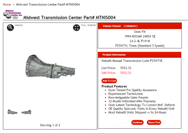

Here's another example of ID code.  "E" and "C".  http://www.midwesttrans.com/webapp/catalog.jsp

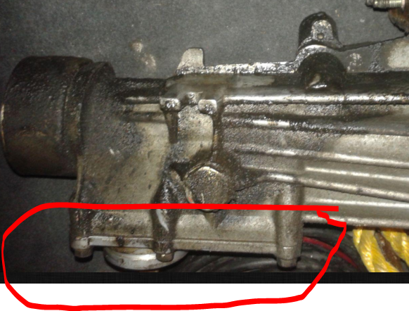

That transmission will work fine-just needs the bellhousing swapped over. The gear ratios are OK too. You'll need to drill the bellhousing for the 16mm shift rod, and cut it for the 62mm countershaft bearing, and clearance the boss on the back of the countershaft hole for the countershaft gear.
