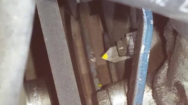

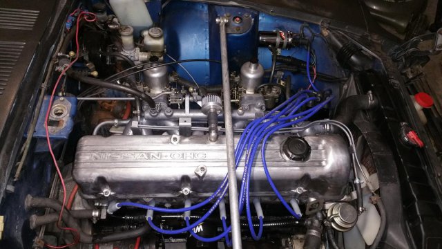

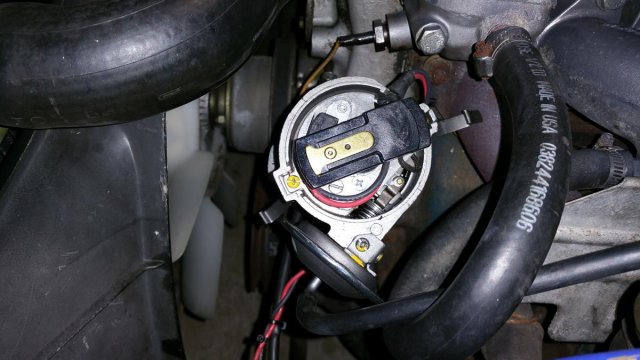

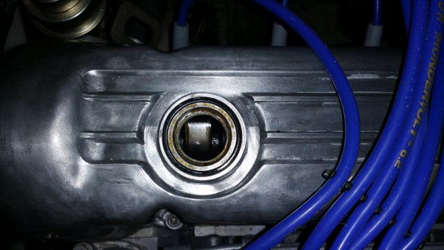

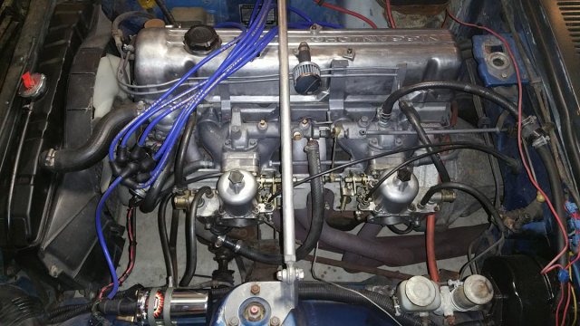

That bar and the overlap makes the routing of the wires a bit hard to follow. Just to confirm the wires are going in 1-5-3-6-2-4 counter clock wise starting from one?
The cam lobe up and the rotor pointed at cylinder one are good signs, I don't recall the timing marks looking like that on the L28 on the damper so I'll leave that for someone else to determine. I would assume yellow to yellow would be TDC.
You have to get a hitachi SU rebuild kit, preferably for the 240z if you want the parts to be correct.
With your confirmation and physical tracing of the spark plug order we can move onto fuel.
With it idling we can do a lot more as well. Can you get a fuel pressure gauge on the feed side? Should be able to pick one up with the appropriate fittings and clamps for very cheap. If fuel is inconsistent you might be tuning the carbs for a certain fuel condition.
Share this post
Yes 1,5,3,6,2,4.. I checked the firing order a few times. Yeah series 1 pointer is different than other Zs I have had in the past. I have a full on fuel pressure kit. I would have to mention when I got the car it had an electric FP and I had the same issues, I switched over to a manual pump and have the same issues as well. If you take one of the fuel lines off the carb and put it in a bucket and turn the motor it gets a solid stream of fuel coming out.

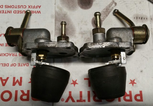

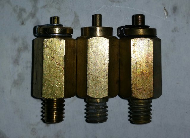

I had purchased a 240z Su rebuild kit off the Internet that said 70-73. But when I opened it up it had smaller jet needles and needle valves than what was on my series 1. I ended up returning the kit and the guy said maybe it was for late 71 to 73. He did not have another kit to fit my 4 bolts. Not to mention the parts in that kit were super cheap and I felt like they would fail anyway even if he had the correct kit so I stuck with what I had.

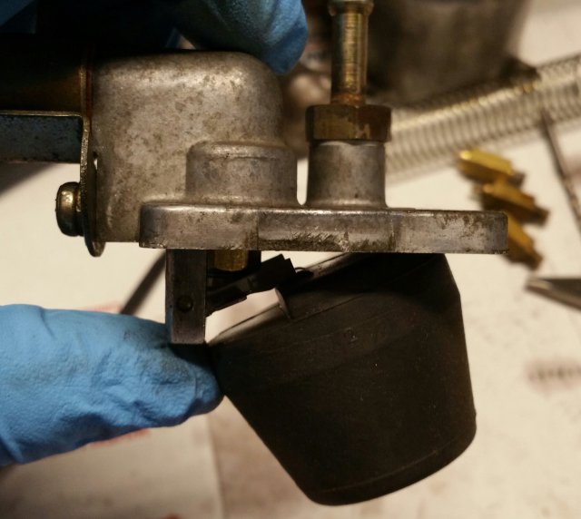

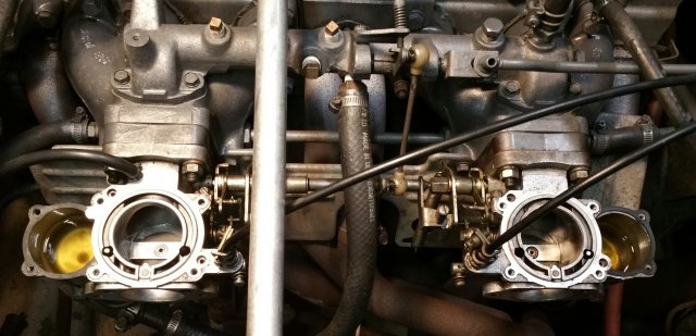

I remember having a problem setting my float levels though. In the video it shows turning the float assemblies upside down and setting the float levels that way, but I noticed when doing that the weight of the dry float would depress the needle valve slightly thus causing a inaccurate setting.

 I am ready to start trying to figure out this issue with the 240z again running like crap and sometimes backfiring. Technically I never rebuilt the Su's because the kit they sent me was wrong and it was of cheap quality. I cleaned the carbs, put back all the same parts and set the float levels. I'm wondering if the guy before me put race needles in these carbs or something to make them not tune correctly. Been wanting to slap another set of Su's on the car and see if the carb's are my main issue but cant seem to find a good set local and they are a grip $$$ online just for testing purposes. I will see about getting a video up.
Share this post
My car would do the same when cold and trying to rev.  Aka Lean condition.
With proper float levels, and a good idle mixture it is possible racier needles have been installed in the past (Do you have a wideband o2?).  SM needles or the like, like to idle very very rich to get a proper mixture in the power band.   If your setting your mixtures at idle for stoich, then they will be running lean everywhere else.
Richen up the mixture, and maybe order some new factory needles from Z therapy.
