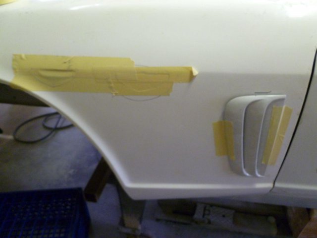

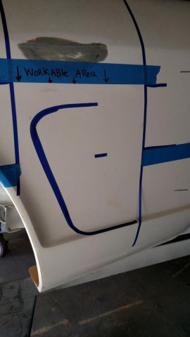

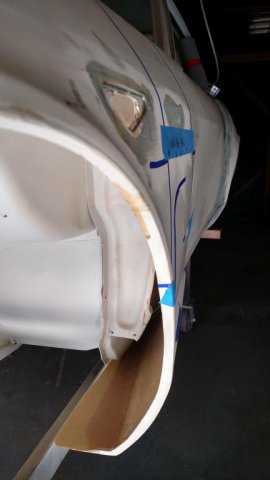

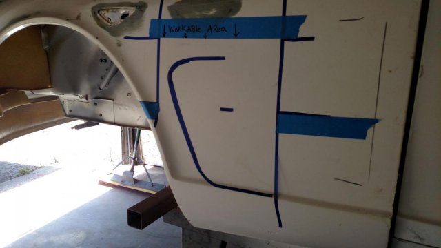

I Agree with the approach of going for a more blended less bulbous vent in the fenders. I originally considered using some gill style vents from a '2003 Hyundai Tiburon , but then decided I would leave the sides vent less.

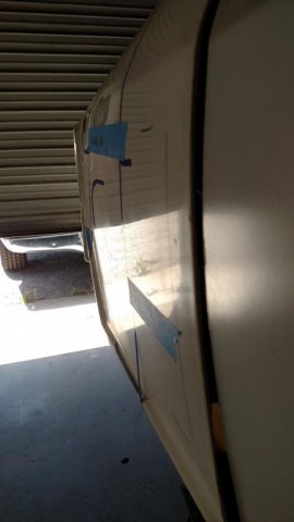

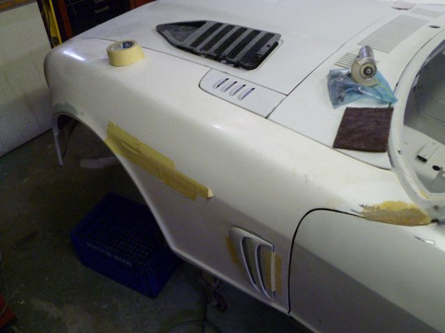

After much thought (OCD in full gear), I have later come back around to the idea of dimple dying the engine bay fender and venting using a '2014 to current model BMW X5 suv as my inspiration. I find this to be one of the nicest and clean examples to date of venting as well as the last gen FD3S RX7 (one of my favorite cars). I have the Subtle Z front fenders which ramp out from the front door to the wheel flare by 1.5" so I think this will work quite well. I plan on building a tunnel out of metal or fiberglass to channel the air at speed out the exterior vents. Not 100% set in stone on size or placement, just a mock up for quick visual thinking. You have to use some imagination here with these pics of my car mocked up with pin-striping. Now I am thinking of thinning the length of top line and tapering it as well as the bottom to fade into the side much like the lines that a current Miata and Tesla uses by their badge and turn signals alike. Pics of all included....  I'm not sure who's car this is here pic with the dimple dyed holes and fantastic reinforcement, but it is nice and an inspiration to me. Last two vented pics are my first idea of venting. Keep in mind my idea was to bevel these into the fender and not have them stick out as they are in the pics.

The camaro vents are just about exactly what I am looking at doing. Ive got access to a pair of fenders I think I will be testing my ideas out on. I continued to research and there don't seem to be any production fenders floating around so I may use the fenders to make a mold and create some vented fiberglass fenders that resemble the camaro vents. Who knows, if all goes well and the final product turns out nice I may see if they catch some attention in the market.
By the way Nelsonian, I like the two scoop vents you have mocked up on your z. Never considered that but they match the hood surprisingly well!

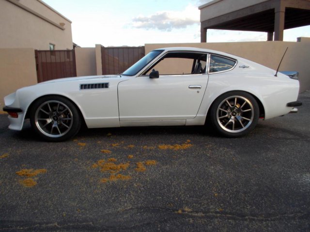

One off, custom made ones in my Subtle Z flared fiberglass front fenders. They're a couple of inches deep (inset inwards) and the vent panels are angled back.
