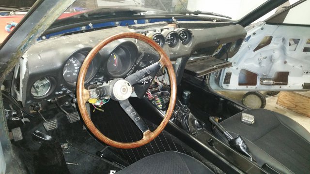

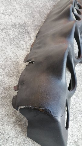

So I have a early 71 240 and the dash board is shot, I mean there is 5" sections of pad missing. I picked up another early complete dashboard from a guy the other day minus the gauges. It has the metal frame with it and even the vin# tag from the other car.. It will need to be restored as well but only has a few cracks.  My car still has all the gauges installed in it but you can reach through the top of the dash and unplug gauges and wiring if needed, I may install a wideband where the clock is if I can find a good one to fit.
I have not removed a 240 dash before. My question is, is it easier to remove the old dash pad from my car and install the new restored dash pad in its place and leave all the gauges in my car plugged it. Or is it better to remove the entire metal frame from the car with old pad and unplug all the wiring? I would like to save time on this but dont want to make things more difficult by not having access. What is the best way to do this for my situation being that I have 2 metal dash frames and one good dash pad? And any recommendations on a descent wideband that fits in the clock location?

If it is anything like the 280, it is very easy. My 77 280, had like 4 bolts up top and 4ish below and then there was 3 wiring plugs under the passanger side. You do have to "drop" the steering wheel, there is 2 bolts that hold it up to the frame and then remove horn and wheel. Really only takes about an hour
Share this post
I've never tried pulling just the dash pad, but it's held in by quite a number of screws, and I don't think it's mean to be removed in-car. I'd pull the whole dash. Unfortunately, while the Z is generally easy to work on, the dash is an exception. It may be more work, but I think it'd be ultimately easier to pull the dash and replace the pad.

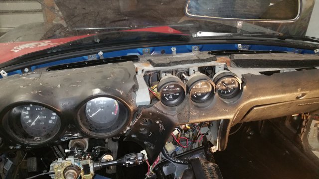

Well I got the dash out, guess I'm pretty much screwed with the wiring, I read the post about labeling the harnesses AFTER I pulled the dash, other than labeling the heater pull cables nothing else was labeled, I just figured the heads of the harnesses would be different so you could only plug them in one way. Guess I'll deal with that when I get there :/.
So my next question is when installing the new dash pad should I remove all the gauges that are mounted in the old dash frame that I intend to use, put the dash pad on and slide the gauges back into place from the front back in?  OR can I just leave them mounted and slide new pad over the top of the gauges?
Looked like a tight fit and they looked tapered. This is my first time removing this stuff, I also do not want to crack the newly restored dash pad by trying to force it over the mounted gauges.

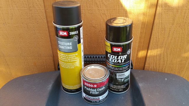

I now have to start restoring the dash pad I have. I have dash filler, sand paper, dash texture coating and dash paint. This is going to take a while.  Do you guys recommend a certain procedure?

My old dash that was in my car had 12" sections of pad missing it was not repairable in any way. I removed it and are currently restoring a different dash that I got from a local guy and it is actually coming out very nice. Should be done in the next few days.

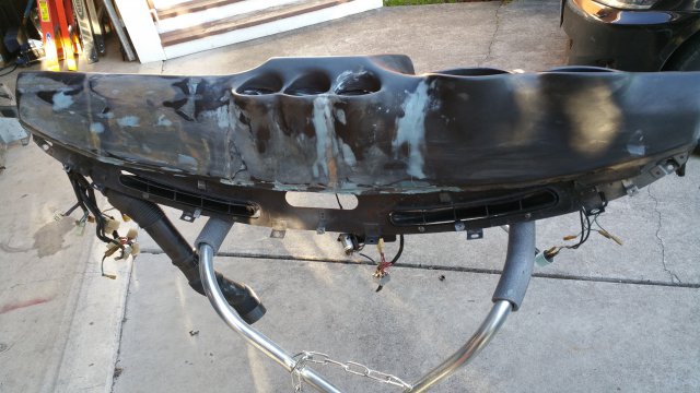

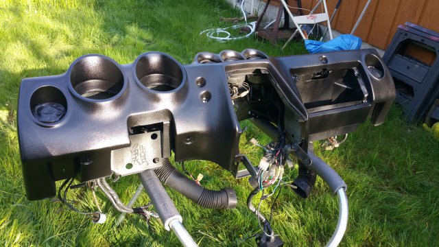

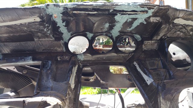

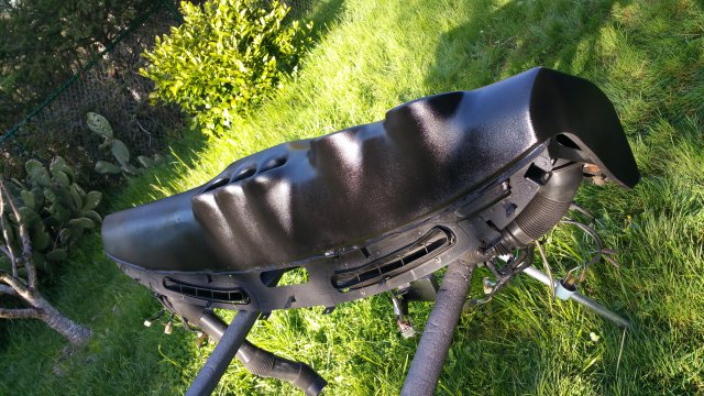

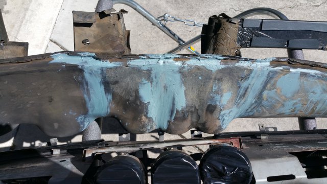

Came out pretty nice. Not perfect but a lot better than what I had in my car.  pictures show the dash that was in my car and the dash that I fixed up. It had a bunch of cracks. Started by taking the pad off the frame and putting filler in the inside of the pad cracks before doing the outside top, pulled apart the cracks and pushed the filler inside, waited 24 hrs , then sanded the dash, with 80 grit then 150 grit sandpaper.
Used compressed air to blow off all the dust,  sprayed brake cleaner on a clean cloth and did a quick wipe down of the dash to remove and oils or contaminants.  Sprayed on the texture paint with 2 coats, waited 24 hrs then applied the SEM Gloss black with 2 coats.  We will see how long this dash lasts, hopefully avoiding cracks for a while. Now to have fun installing this beast with out messing it up.

Thanks. Yeah when I removed the dash pad off the old frame it created and new giant crack that I had to repair also, thats telling me the core is pretty briddle..thought about putting something else on it to protect it. Is there a preferred sealer product people use after restoring their dash? It may help the top of the dash for a bit but if the crack comes from the inside out I'm screwed.
