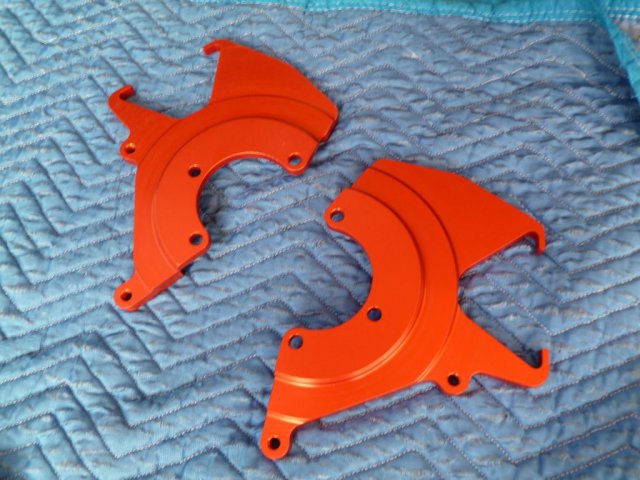

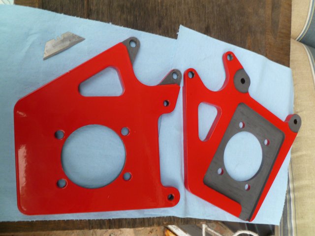

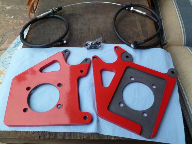

I bought the standard AZC  Wilwood kit from the silver Vildini shop car 240Z. They only have less than 4k miles on them. I also bought member Woza custom rear parking brake brackets and also have member Tim O version. Unfortunately my car is in pieces waiting for one day to be finished. I have heard nothing but positive comments on the azc kit though.
