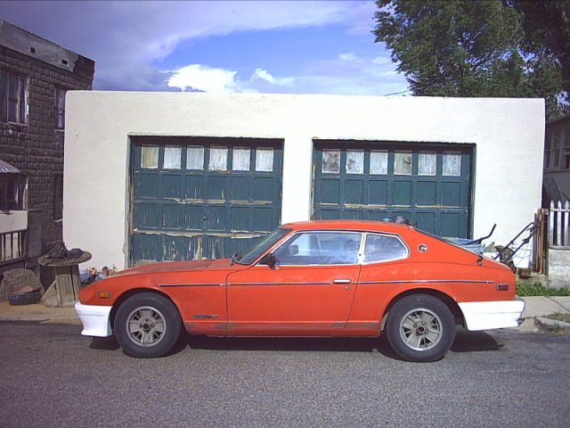

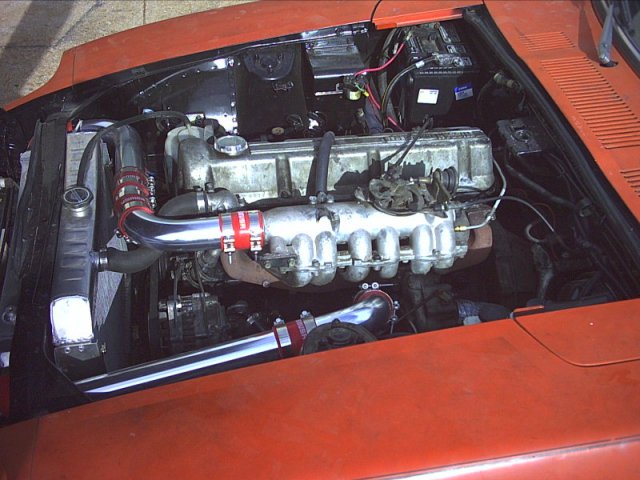

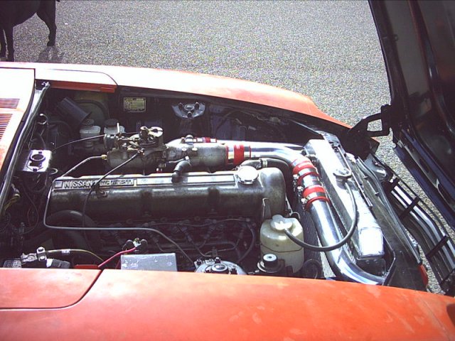

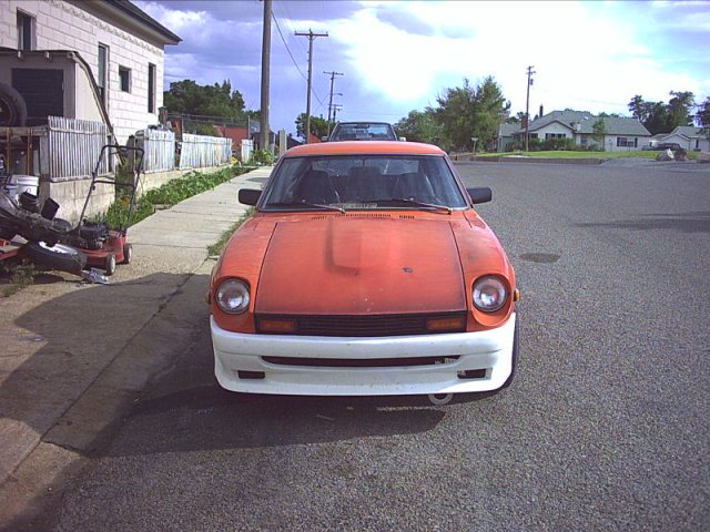

I just got my 1977 280Z 2+2 on the road with its turbo intercooled ld28 diesel engine, power is more than sufficient, but at 800+ miles to a tank and the ability to go on road trips free using restaurant waste veggi oil, I am loving it. My bull mastiff is loving the extra space in the back with the seat folded down :redface:
you can take a look at my ongoing fuel log if you are interested in real world fuel mileage with this combination:
http://ecomodder.com/forum/em-fuel-log.php?vehicleid=2731
This link will take you to the ongoing spec for this car as I customize and hybridize it.
http://ecomodder.com/forum/emgarage.php?do=details&vehicleid=2731
I took thorough pics of the swap and can talk details to any one who needs just drop me a PM

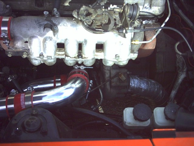

I am using the stock 280zxt turbo and manifold (get out your grinder to fit it) with a custom down pipe and 3" mandrell bent exhaust with two borla straight through glass packs (for a throghty but quite cruiz tone, I like to talk to my girl on the highway now and then). No angles greater than 60 degrees in the exhaust. I am seeing boost building just off idle with 1 psi by 30 mph, and 4.5 psi by 65 mph on an easy steady level cruise.
The LD28 is a unthrottled diesel so it takes all the air it can get and needs no pop off valve. Diesels are variable air fuel ratio engines so you just add as much fuel as needed for the power you want, any excess air is just a working fluid for high temperature gaseous pressure to exert force on the piston.
That said when I connect manifold pressure to the aneroid on fuel injection pump additional fuel is injected porportional to manifold pressure density. Power and accelleration are great and fuel mileage is in the high 30's
Disconnect this line so no additional fuel is injected under boost and the engine runs extra lean (no problem for a diesel) I still feel the turbo surge but the power is less and I get in the high 40's for miles per gallon.
I will be adding a selinoid to only allow manifold pressure to the aneroid at the press of a red button on my shifter, this button will run a few other things like a shot of steam on the turbo turbine to spool it :twisted:.
