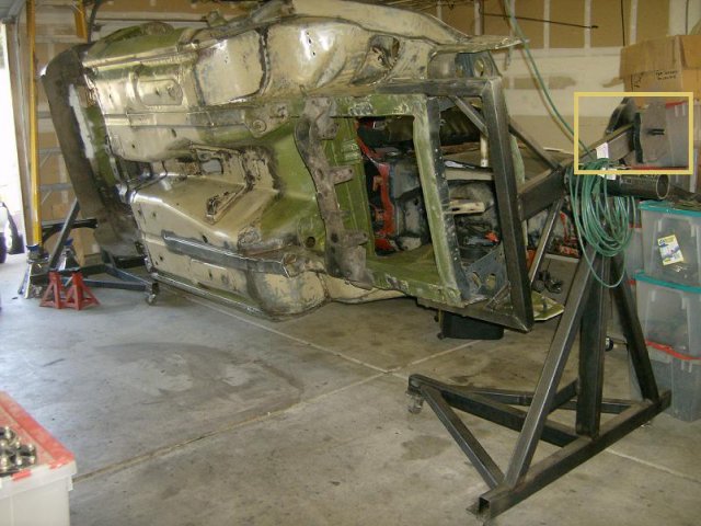

redneck1545 Posted September 13, 2010 Share Posted September 13, 2010 for rotisserie from engine stands! Built one this weekend and it only took me about a day...I had to run a 220v line to my garage for my crappy arc welder but it got the job done. my ugly welds are holding up so far, so im pleased to say the least. I differed from the original plans by using only two HF 1000lb engine stands and bought a 1 1/2"X3" piece of rectangular steel in a 2' length for 7 bucks at the metal yard instead of spending the 40 bucks on another stand just to chop up the upright. All was going well until i didnt square out my front mount properly and it came out with an angle...an i thought to my self, "oh no problem, ill just match that angle in the head of the engine stand upright so it wont be a pain to turn"...I thought about the falling out part when rotating and found a way around that. What i didnt think about was the angle was great enough that when turned upside down the "weight" of the car would be BEHIND the rear support wheels on the engine stand. I got the thing turned sideways and the front wheels started lifting up a few inches because of it....So im either gonna fix the mounts by cutting them off and re-welding them more level, meaning i gotta cut the front mount i made and the engine stand back up...OR I can just take a piece of 1 1/2" X 1 1/2" square tubing and tie the two stands together to prevent this from happening. what do you guys think? Quote Link to comment Share on other sites More sharing options...

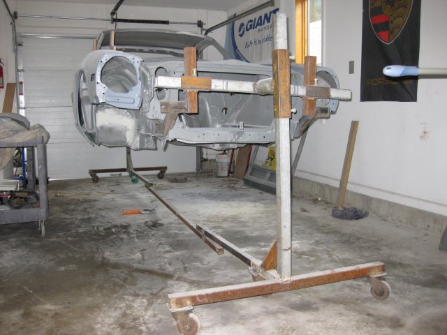

zlalomz Posted September 16, 2010 Share Posted September 16, 2010 (edited) Here is another pic of my rotisserie with the counterweight added. I'm really surprised no one else does this, it makes rotating the car easy - one finger easy. Edited September 16, 2010 by zlalomz Quote Link to comment Share on other sites More sharing options...

redneck1545 Posted November 30, 2010 Share Posted November 30, 2010 I finally got my rotisserie built...then had to chop it up again cause i didnt get everything perfectly square. fixed all the issues and she flips all the way over without the stands wanting to push towards eachother! CG is still top heavy but going out to the garage an seeing a flipped 260z on some engine stands put together in a few hours is a sight to behold!!! Quote Link to comment Share on other sites More sharing options...
