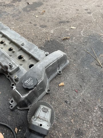

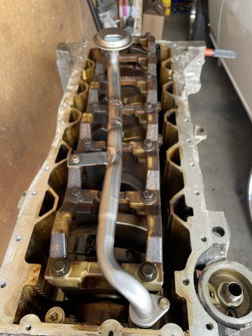

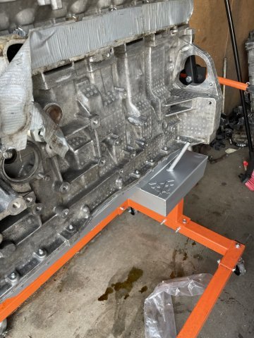

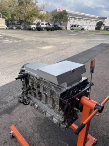

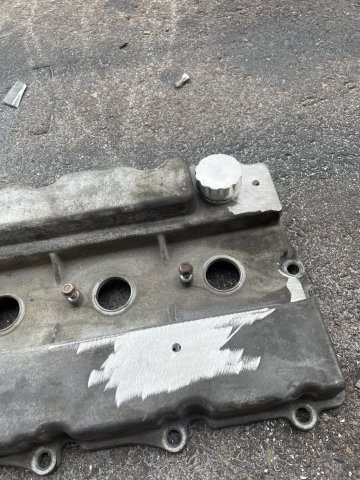

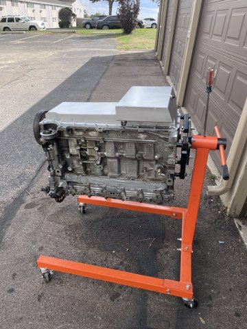

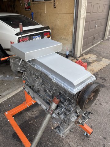

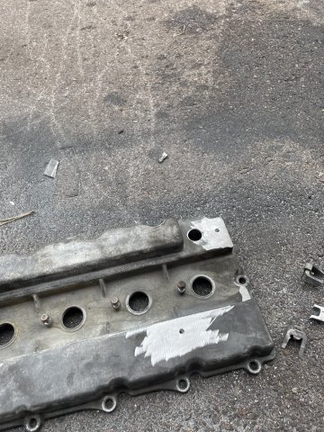

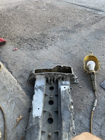

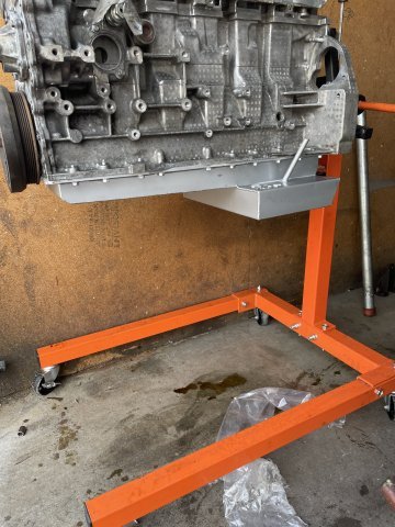

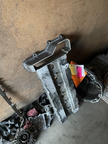

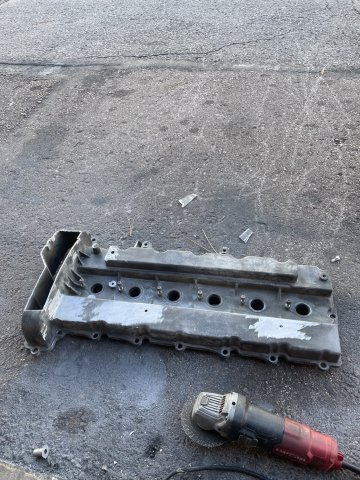

10-04-2025. I got some more 4200 work done today. I installed the modified pickup that came with my T oil pan from Forever Fabrication, and then installed the oil pan. It came with new bolts, and I used Permatex Grey to seal it. After that I jumped on the valve cover. It is a common thing on 4200's to cut down the valve cover on if you want to use it in certain cars, as the height of the engine causes issues. You either cut a hole for it to poke through or cut it down. the 2006-2009 4200's have a cast aluminum valve cover, so pretty straight forward. Using my die grinder, I cut the top out and then ground most of the other stuff off I didn't want on the cover, and drilled the hole in the back for my oil fill. I picked up this sweet cap and threads on Amazon for under 10 bucks. So, after the initial cut I then used a marker and drew some lines for further cutting and then drilled small holes so when I took it off I could draw a pattern. as the pics show it took off a bit too much where the intake cam is.....but no worries, I kept some of the cut off aluminum, and can cut strips to put there it will all be welded in Next, I will use a cereal box to make forms for how I need to cut the plate aluminum, and get it all welded up, sanded down and off to polishing. Block is about 90% ready for paint, just more corner cleaning. Going to go ahead and paint the block silver....I don't want to be tied down to a color, a neutral color is best, and the silver makes it easy to just use a thin coat. I will also probably use clear engine paint over it to give it a little more pop. Pics follow.

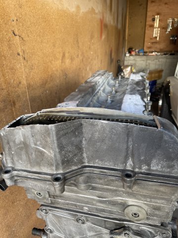

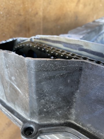

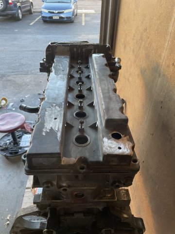

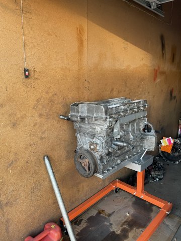

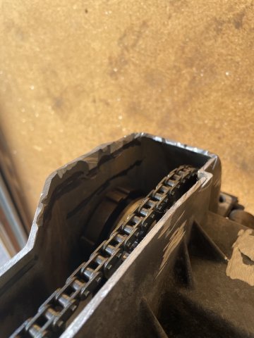

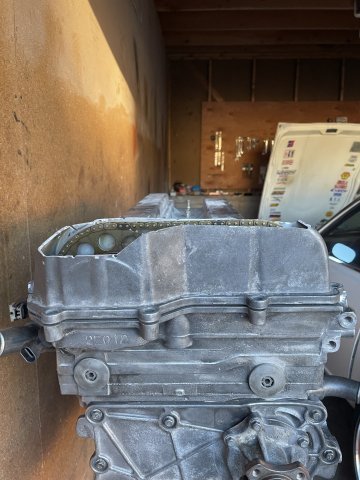

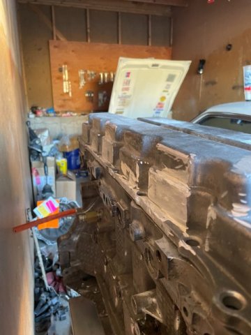

More work on the 4200 today. cleaned up the rest of the block and head, and then pulled the oil pan and cam cover. NO SLUDGE. very clean inside. I got the outside of the cam cover clean enough to at least get started on the modifications I will do to it (add an alloy oil fill to the back, add a breather port, shave off 2 original ports, cut off unnecessary brackets, weld up the original oil fill hole and probably lower it a bit as it is very tall . To fit under a Z car hood it has to be chopped about an inch......although a small rectangular hole in the hood with the polished cover sticking up can be made to look really cool. Yeah I had an adaptor snap on me, the crank bolt is SO tight, I will probably need heat and PB blaster and smack it a few times to shock the treads to get it off. I need to clean behind it and it needs to be cleaned up and painted.......I wonder if the heat will ruin it? Before I called it a day, my AR5 transmission arrived.....in need of a rebuild, the pilot shaft has wiggle room. pics follow:
