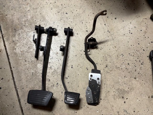

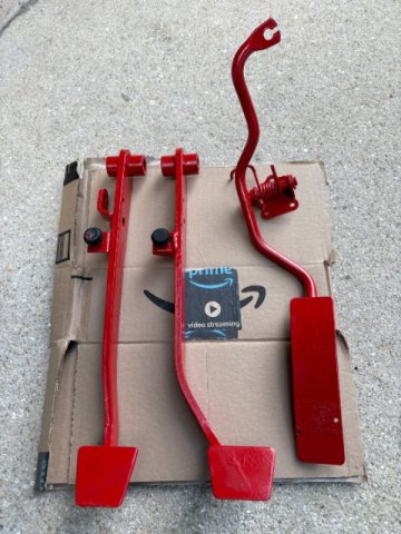

Got a few small projects done. Got rid of the weird clutch pedal contraction. Ordered a brake pedal to be my clutch pedal. Had to trim it down as it was for an automatic. Welded on the side clip for the clutch slave cylinder and took all the pedals out and painted. Also cleaned the underside some more, I want to get that painted soon. -
