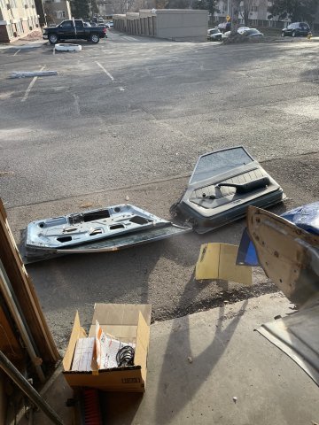

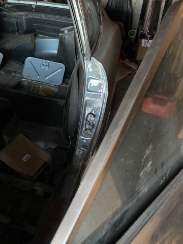

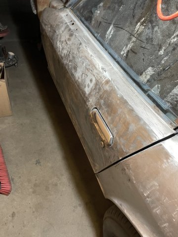

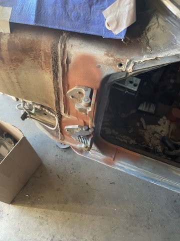

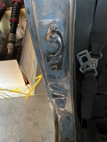

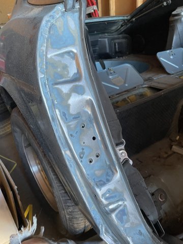

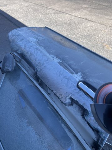

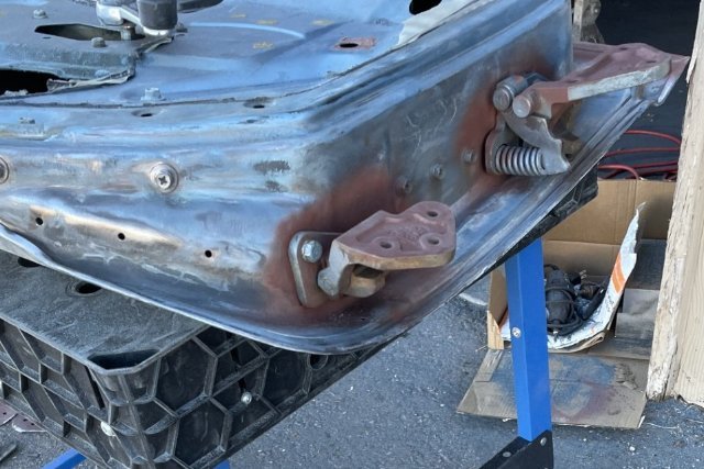

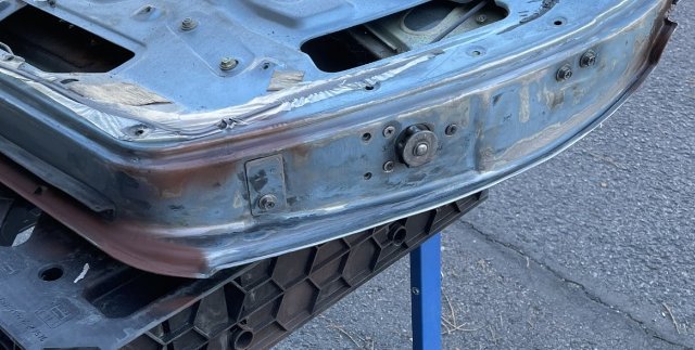

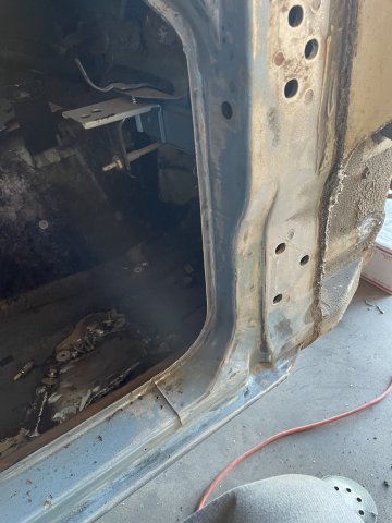

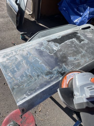

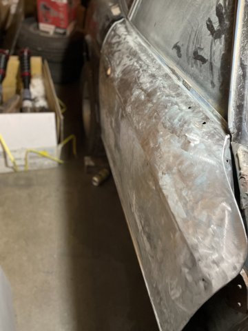

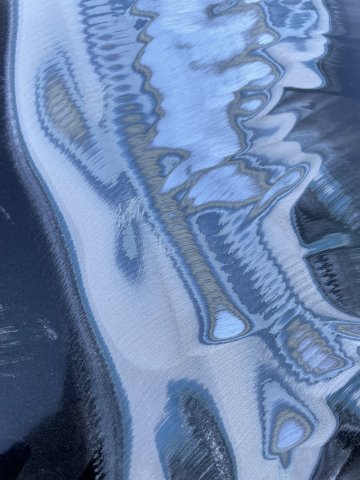

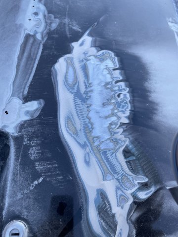

Well, it took all day, but I got the door jambs and inner doors all done and ready for the body shop. The paint on this car is incredible. I have never seen anything like it, it only comes off with a flapper wheel on an angle grinder....I tried 40 grit on my orbital sander, didn't touch it. So, I have continued to use a flapper wheel, and will then go over each panel with finer and finer sandpaper to get it all smooth before handing it over to bodywork and paint. I am finding areas that were slicked with filler and sanded out, with THICK layers of paint and all. I remvoed the hinges and coated both sides with rustoleum and re-assembled. Man, It really worked me today! Pics.
