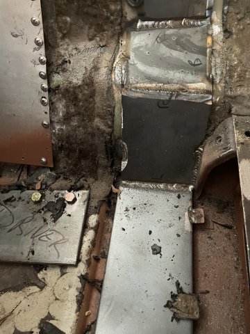

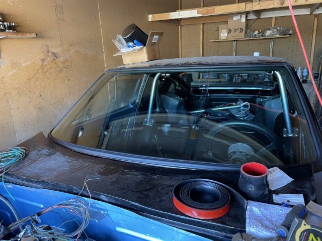

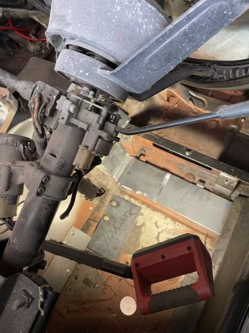

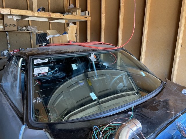

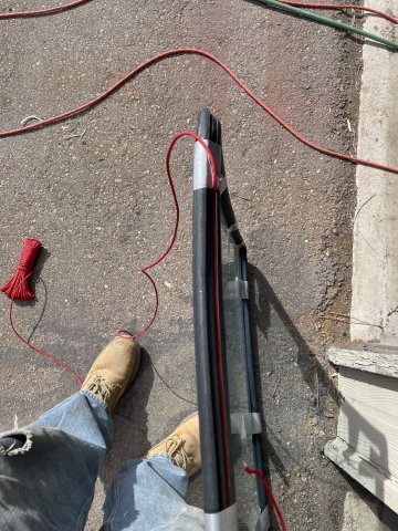

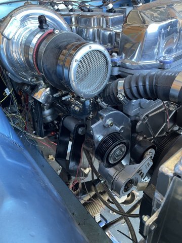

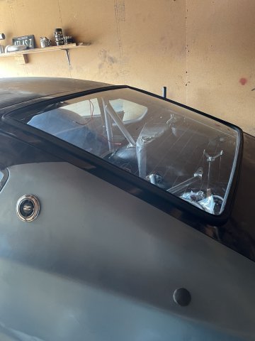

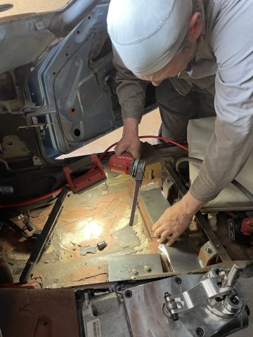

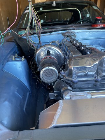

03-16-2026 ATLAS Z UPDATE: My welder showed up today and welded up my cross bracing and a few spots on the trans tunnel where it touches the firewall. While here, he pushed on the outside of the windshield as I pulled the rope and got the windshield in. Tried to get the hatch window in, but it wasn't wanting to do it. So, I will have someone help me with that rear one later. I went ahead and installed my mesh cover for the turbo.....I had to go down a size to clear the engine. I got started on putting the door frames back in and getting the windows working right, more to do on that. PICS:

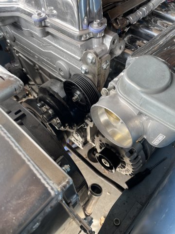

03-14-2026 ATLAS Z UPDATE: Since the intake was off, I went ahead and tackled the project I have been putting off. Modifying the Atlas Industries alternator bracket setup to work on my project. the mounting plate is 1/2" thick, and the alternator just wouldn't clear the frame rail, so after trying to cut the aluminum bracket down, I gave up and traced out the bracket on a piece of 1/4" thick steel and cut it out and drilled the holes out. I then used my Dremel to counter sink the holes so I could use the bolts and everything that came with the kit. I painted the steel bracket with silver engine block paint and the bottom bracket I had to trim 1/4" off of it. Then I was able to install he alternator (brand new AC Delco, nice unit), and then on to the fun part.....belt alignment. Using a straight edge, I had to keep working little by little shaving aluminum off the provided spacer and then lightly grinding the back of the nylon pulley and it turned out great! Then I went ahead and installed the fittings to use a 8AN line for the crankcase breather on the intake between cylinder runners 3 and 4, and I found that by leaving it black it is hidden and you cant see it, so that worked out better than I had planned. once the intake was tightened all down, it was time to finish the intercooler piping. The driver's side was VERY tight. I used two 90 degree sections and trial and error and cutting them down I was able to come up with a decent arrangement. so that piece, to be welded along with a frontal piece to weld a length on to eliminate some couplings were put together and I will take them to get them welded up then take all of the pipes to get powdercoated with the "polished aluminum" finish. I could get them polished.....but it would cost more......opinions? Lastly I put together the intake side, switching to a 4 inch coupling setup with the GM factory style MAF meter. it was 3.75 diameter, so I took some rubber strips that are adhesive on one side and ran a strip of it around the mating surface, and then I was able to tighten the hose perfect on it. I did have to use the 4 inch to 3 inch reducer on the end, as the engine has pieces sticking out that won't allow for 4" pe, etc. I have a 3" screen arriving soon which will be on the front and it should look pretty good. I will have to get inventive to add polished/chromed to it to get rid of too much black. maybe a very thin polished aluminum piece that wraps around it and can be fastened underneath? Anyway, here are some pics:

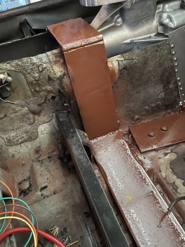

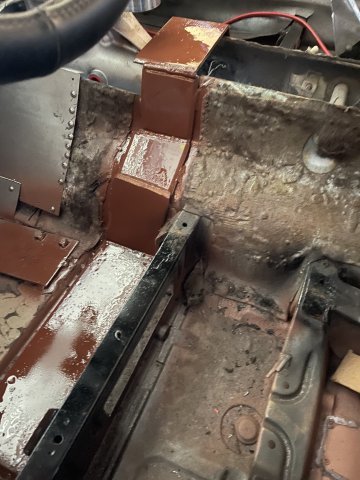

Yes, the front strut tower reinforcement is connected thru the firewall. Attached is a photo that kinda shows it off, these are slightly old pictures taken by the welder prior to taking delivery. Cage has since been finished and had gussets added to the A-pillars. The fender braces from Apex are located inside the front fender outside of the driver cabin. I also have them, not sure if I'll end up using them, cage installer wasn't convinced they really do much other than maybe preventing the front wheels from coming into the cabin during a head-on collision. Plinth location is the deciding factor in how your door bars and subsequent firewall > strut tower bars will/won't interfere with your pedal box. My door bars are pushing right to the outer edge of footwell and angle up from the bottom of the A pillar bar to fit my left if needed. Not sure what pedals you're using but I have a Tilton triple master setup that's going in so the world is my oyster so to speak in terms of pedal placement. This dude's pedal setup looks super neato and I would like to replicate the adjustment mechanism. -
