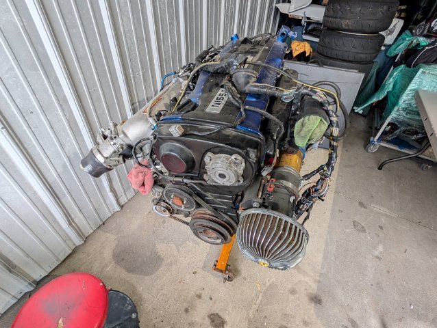

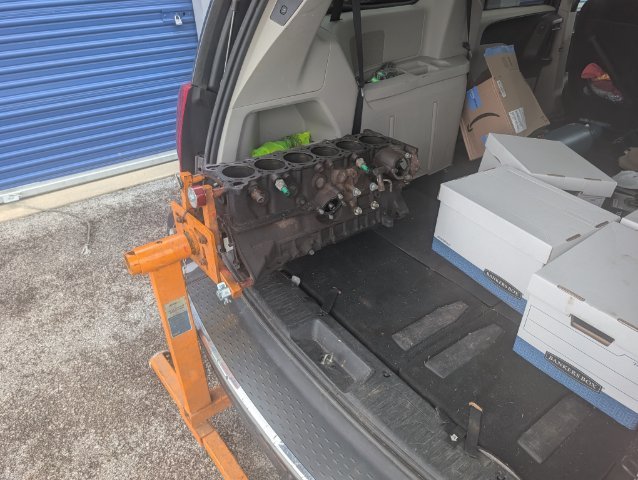

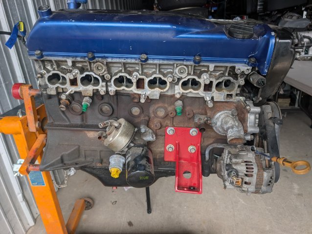

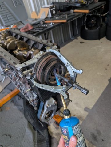

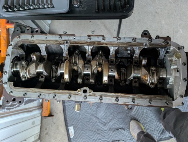

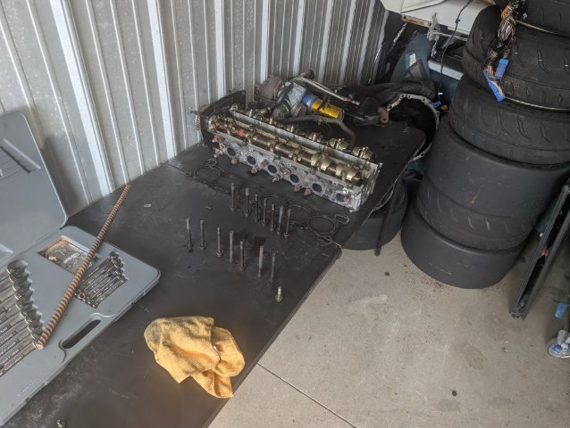

Alright, finally got some time to make some more progress. The engine is mostly disassembled, and I have mics and a bore gauge coming to measure clearances. I am planning on a stock engine, with the oil fixes, and a bigger turbo. I am not concerned with making a ton of power; anything will be better than the stock L24, and I just want it to not blow up immediately. I am new to engine work, and have a couple of questions: 1. Does anyone have any recommendations for what size oil restrictors to use? Enjuku sells oil gallery restrictors in 0.9, 1.1, 1.3, and 1.5 mm. 2. I have googled RB25 specs for rod and piston bearing clearances, but does anyone have a trusted source that they recommend? Thanks for all the help! I have read through the site and watched a couple of rebuild videos, but I'm still not 100%, and I don't want to make a stupid mistake.
