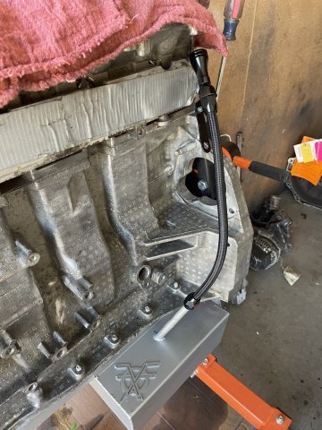

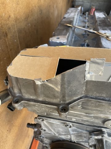

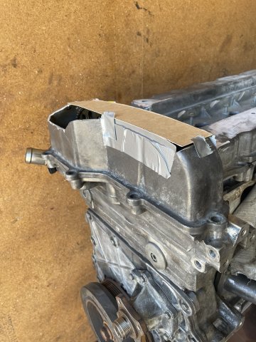

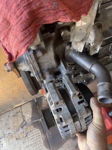

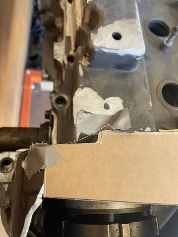

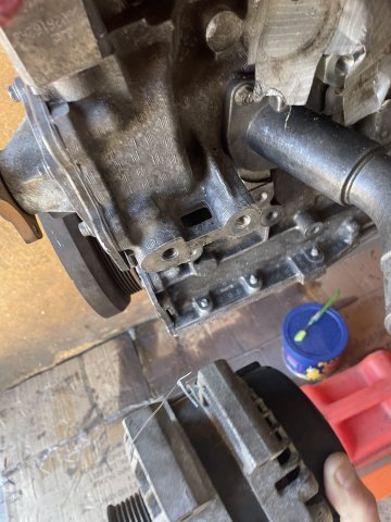

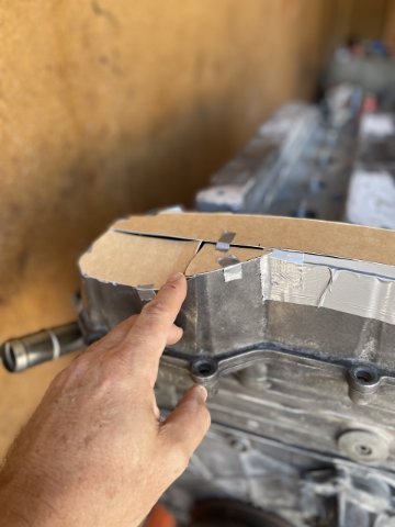

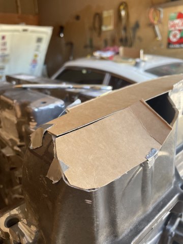

I worked on making the forms for the valve cover today. I can now use them as templates to cut them out of some 1/8" thick aluminum plate I got off of Amazon, and it should be here tomorrow. Also stuck the dip stick in a little bit to get an idea. It also comes with the oil pan and pickup. Lastly, I am getting ideas on alternator fitment.....pics.

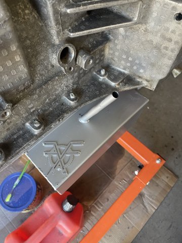

10-04-2025. I got some more 4200 work done today. I installed the modified pickup that came with my T oil pan from Forever Fabrication, and then installed the oil pan. It came with new bolts, and I used Permatex Grey to seal it. After that I jumped on the valve cover. It is a common thing on 4200's to cut down the valve cover on if you want to use it in certain cars, as the height of the engine causes issues. You either cut a hole for it to poke through or cut it down. the 2006-2009 4200's have a cast aluminum valve cover, so pretty straight forward. Using my die grinder, I cut the top out and then ground most of the other stuff off I didn't want on the cover, and drilled the hole in the back for my oil fill. I picked up this sweet cap and threads on Amazon for under 10 bucks. So, after the initial cut I then used a marker and drew some lines for further cutting and then drilled small holes so when I took it off I could draw a pattern. as the pics show it took off a bit too much where the intake cam is.....but no worries, I kept some of the cut off aluminum, and can cut strips to put there it will all be welded in Next, I will use a cereal box to make forms for how I need to cut the plate aluminum, and get it all welded up, sanded down and off to polishing. Block is about 90% ready for paint, just more corner cleaning. Going to go ahead and paint the block silver....I don't want to be tied down to a color, a neutral color is best, and the silver makes it easy to just use a thin coat. I will also probably use clear engine paint over it to give it a little more pop. Pics follow.
