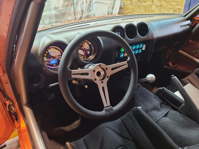

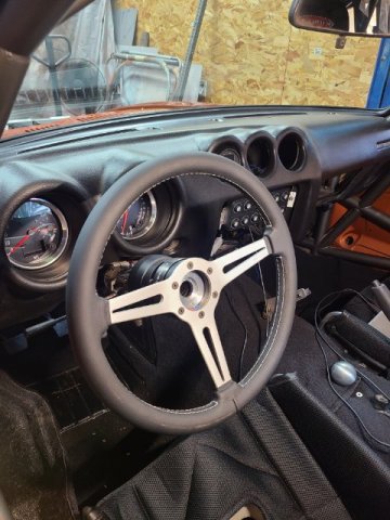

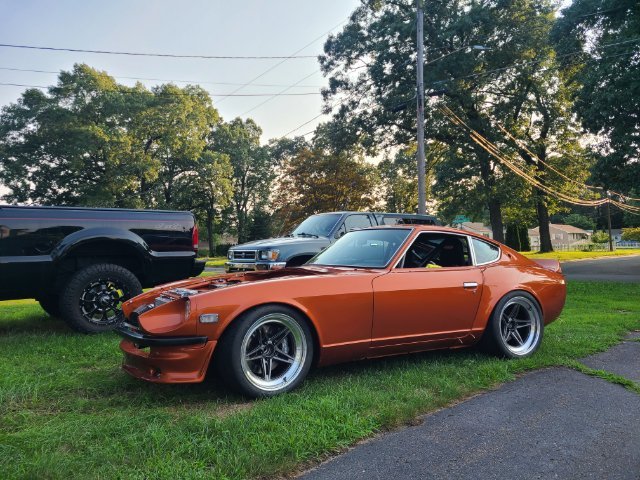

I drove the car about 3/4 of a mile around the block.... tune needs a lot of work (obviously), tires had a slight rub and it rattled a bit but was so exciting and such a relief after a year of hard work. Got the rest of the windows in as well. Wife offered to polish all the trim so I gave her some supplies and let her scrub away. also added a couple interior shots. - Today
Someone mentioned steering shaft clearance? I can't see how....tiny engine in a big bay.......
