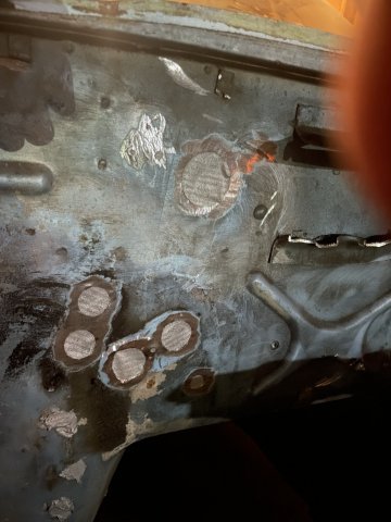

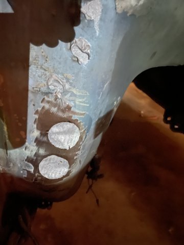

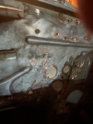

tonight I pulled the tape, it had cured enough, it will continue to harden even more. This is not "just filler" or bondo.....it is 80% aluminum filings and 20% resin. It will not shrink, it will not crack, it is hard as a rock. They poured resin over the Pharaoh Tutankhamun's body, and 3500 years later, to get him out of his coffin they had to chip him out......so it is permanent. ALL METAL Filler. wear gloves! It reacts on skin and burns like there is acid in it.

I started at dark this morning, and got the seats, center console and dash out of the 260Z. prepped the holes in dash and they are now plugged and curing. then I took some time and just gutted the whole area, to include the dash. Finished at 1:40 this afternoon.
