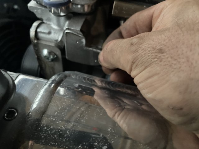

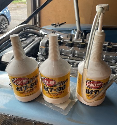

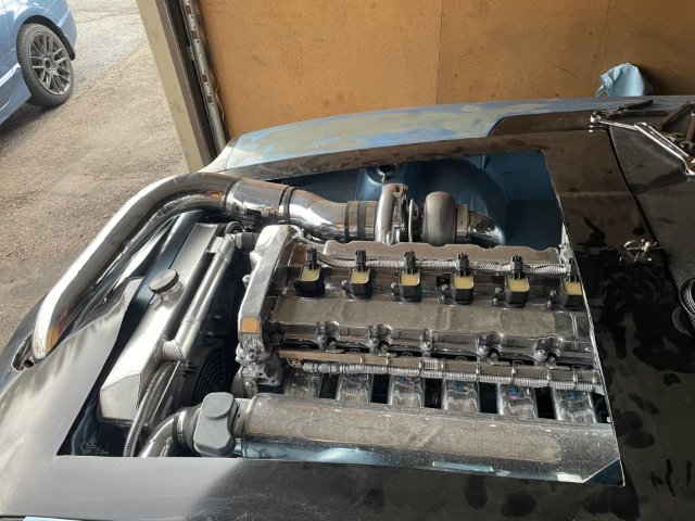

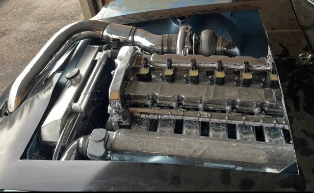

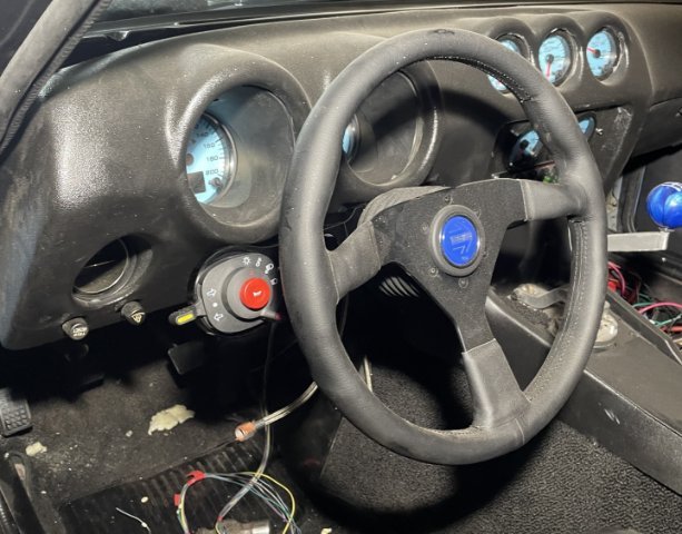

08-22-2026 ATLAS Z UPDATE: Work The Punchlist. Decided to switch it up a bit today and work a punch list of little things I just let pile up working on the bigger ticket items. Started with getting the horn installed, wiring my dual fans in, finished the clutch master cylinder in the engine compartment, topped off the transmission with some redline MT90, then finished the intake pipe, getting the air filter on the end and getting it in there good....ended up having to trim a tad more on the hood, but went pretty easy. Installed the new modified gas pedal finally, and yep....had to mod the corner of the pedal surface a tad but this time it works...Installed my combo turn signal stalk/headlights/horn and got the wires ran over to the other side to terminate later....and started on a small sheet metal cover to cover an ugly spot on the side of the head. PICS:
